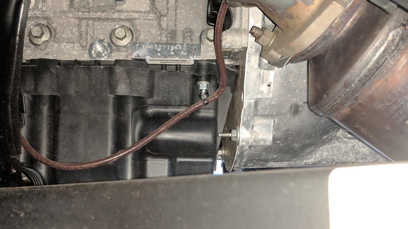

Here is a picture of the engine/transmission "sandwich" plate. The largest surface area of this plate is what covers the lower portion of the bell housing.
A picture is worth a thousand words. Thank you.

I see - sort of like the block protection plate on an explosion proof bellhousing or a clutch inspection plate on an older transmission.
