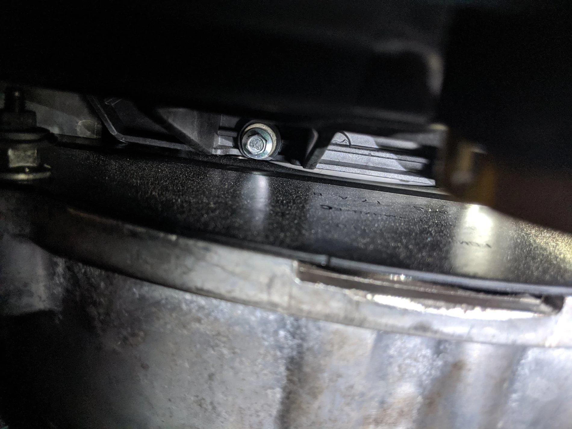

cool, i did this with the lead tape suggested from another member but it's still there so ill try this next. ill just slap it over the lead tape i assume it's really sticky like VHD stuff
It's pretty sticky so you'll have to flatten it before you maneuver it into place. Hope it works out well for you. It's embarrassing when you hear this noise on public roads. Sounds like our car is about to fall apart.

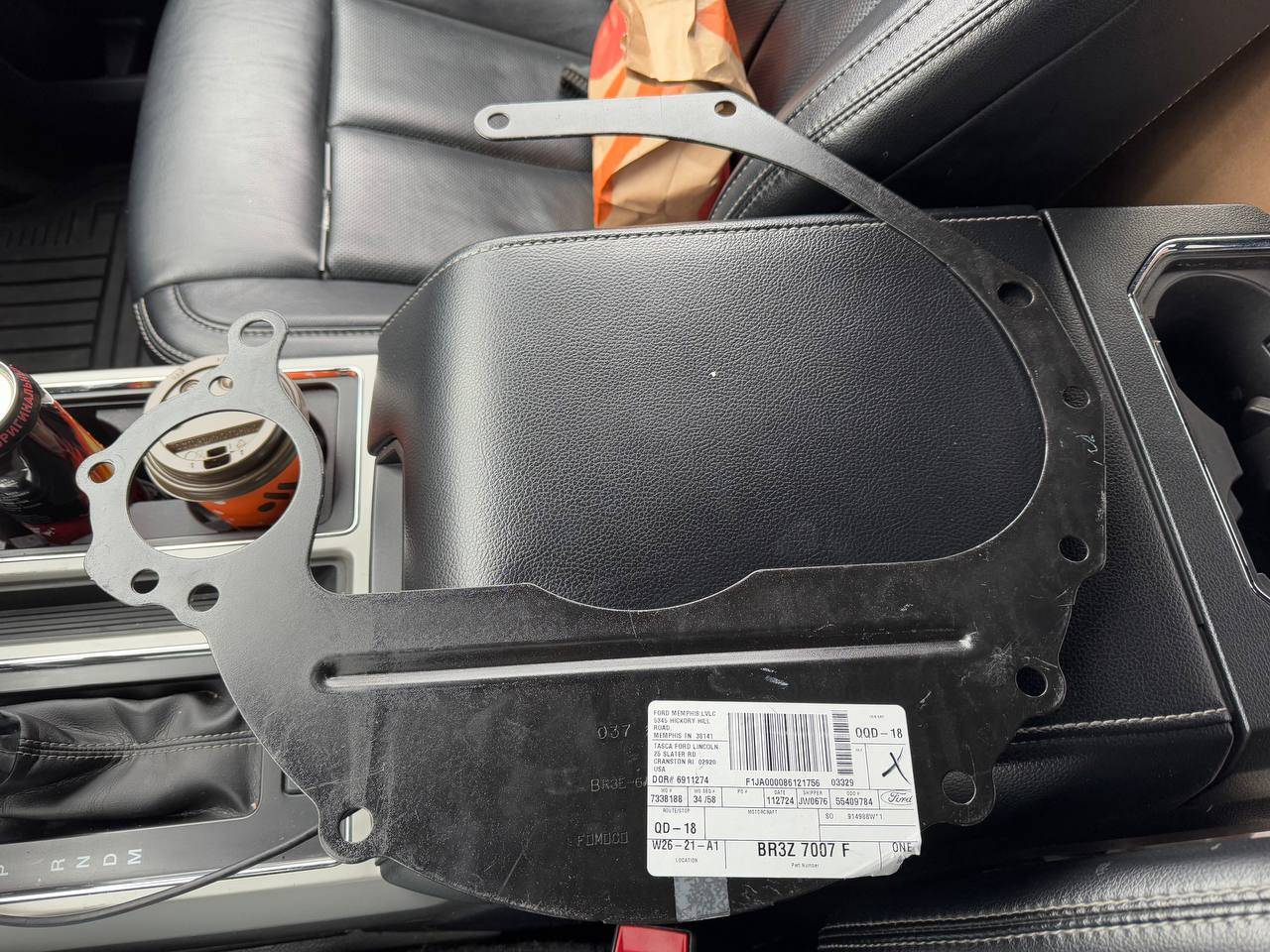

Mine was fixed under warranty by having them put the updated rear cylinder block plate in. It worked.

Question, does this require the trans to drop to install? Mine has full coverage until 2030 but I find it difficult to trust some Ford dealers
Thanks for sharing the part number!

Yes it does. They remove the shifter and the exhaust, drop the tranny, install the new plate then put it all back together. The driveshaft comes off too. Any decent dealer should have techs that can do it
