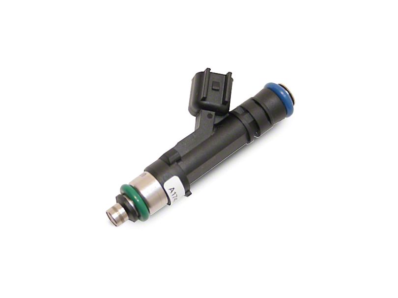

It is the angle, tightening the screws down causes the top hats to tip inward and this allows the fuel to leak out of the top hat. DW 95s are same length as LU47s that were originally shipped with my stage 1 kit. The difference is that aftermarket injectors usually have these top hats that allows them to extend to the same length as the LU47 body length, top hats are similar with ID1050x, etc, but unsure if those would leak.
DW95, the leak happens where the clip is on the top hat.
LU47, no top hats, no leak.
Wondering if anyone is using other injectors with a solid body at or above 95 lbs/hr, aka 1000cc+?

Luckily I didn’t have a leak with the DW95s. I would have went with the DW88lb injectors because they are a one piece just like the lu47 injectors. Only reason I did is because they don’t tune very well per tuner.
DW88's work great, good injector data on them too. I was going to run them only 18 but I got a good deal on my 95's from a friend who upgraded to 1700s

I would have much rather went with the 88s. The DW 95s sit on the SC when installed they collect more heat. The DW95 are the short injector with the top hat so to make them the length of lu47. It puts the plug further down and if not careful will sit on valve cover and make it harder to connect the plug to the injector.
Yeah, the connector sits low, which kinda sucks, DW88 should be the go to injector of choice for anyone with a 18+ looking to stay under 1100hp, they flow more than enough to support e85 and 4 digit power on 18+ cars

So would DW88s be a good choice for a 15-17 car? I’m planning to drop in a DW400 fuel pump in lieu of a BAP, but I’ve had my doubts about the LU47s that come in the kit, just doesn’t seem to leave much headroom.
I may be wrong, nobody has provided what their max injector duty cycle is during a pull, but it calculates over 80% and that’s not ideal if you ever want to pulley down.
If you don't mind my asking, which tuner didn't like the 88's? I'm starting to gather up a fuel system before I go with a different tune and I'm still trying to sort out which parts and which tuner to go with.

Depends on how much power you want to make and whether the DW400 will hold pressure so you aren't forcing the injectors to pick up the slack through increased pulse-width should the pressure drop(and if you are, it depends where your IDC ends up).
On 93 then DW88s will be fine, on e85 it will depend on pressure. You want IDC to be 95% or less, anything more and you are going static. Ideally 90% or less in the summer so there is room for the denser air you will see in the winter
