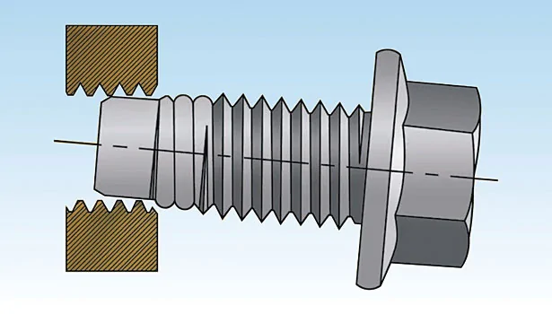

Given the number of issues with the fuel rail mounting, it makes sense to mock it all up on the benchtop first and try to discern if there's any misalignment or other issue. I also had the idea to use some studs into the blower housing, but it's hard to tell if they'd prevent you from seating the injectors since you kind of need to come straight down onto them first.
Honestly it might be wise just to oversize the holes in the fuel rail mounting tabs to start with, give yourself a little extra wiggle room, and changing the hardware to some half dog or full dog point machine screws would definitely help getting them started as long as the blind hold they're going into is deep enough to get good thread engagement.

If I had done exactly what you recommend, I would not have had the issues that I did. Dogged point machine screws and enlarging the hole in the mounting tabs. Would have made a world of difference. Thanks. Excellent ideas...

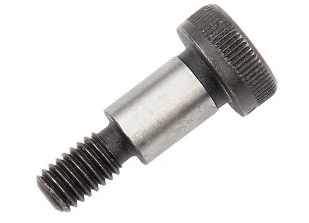

Another option that might be good is to oversize the holes in the rail mounting tabs and use a single flange rubber bushing, and attach with a shoulder bolt. That way the rail can settle where it wants to be and still can't pull up off the injectors.

Got a pic of where / what you mean to enlarge the holes on the fuel rails?
What’s a dogged point machine screw?

The mounting holes in the fuel rails are just through-holes drilled into tabs on the rail body. You can simply enlarge those with a bigger drill bit.
A dog point aids in lead-in for fasteners and is very common on OE hardware because it makes for easy alignment and quick assembly. Basically it centers the bolt as it's going in so the first thread catches easily. I believe full dog is a full bolt diameter length past the first thread, half dog would be, well half. The downside in this case is the extra length, because the threaded holes in the blower body are blind, so you have to be sure to get enough thread engagement before it bottoms out.

How much bigger would you recommend going for the holes on the fuel rails?
What size are the bolts to get dogged?

Not sure I can answer the first part yet, I haven't mocked anything up to see what's what. I think it's M8x1.25 hardware so maybe 10 mm and use a washer. Don't quote me on that, may be M6 or something else entirely. It also might not be easy to find dog point socket cap screws, you can always make your own with a grinder and a little patience, and a die to chase the threads when you're done.
That only solves one issue which is the vertical location of the rail, sort of, relative to the plane of the lower injector seats. If the mounting bosses on the blower body are not faced off correctly the rail may be canted or pushed in or out relative to the natural location of the injectors. I doubt Edelbrock would have messed that part up (or at least I hope so), but I don't doubt there may be an errant mounting hole location occasionally because that would be drilled and tapped in a separate process. In that case opening up the hole in the fuel rail tab should do the trick.
Basically if you get everything set up on the bench and the rail is happy, but then it moves or cants when you put the bolts in, then something needs to be massaged to keep the injectors aligned and leak free.
