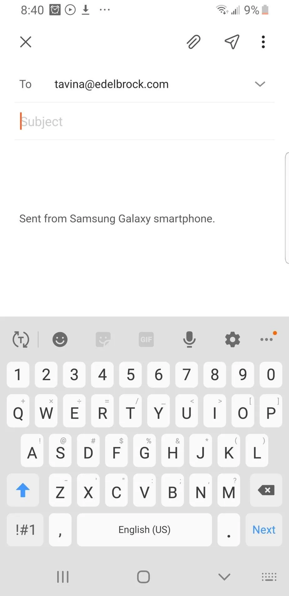

Sorry to here of your troubles. That belt should fit but it is tight, I found it's easiest to put it on the lower right idler pulley last. As far as your code is goes try contacting Tony. Edelbrock in my opinion has great customer service. Here's a pic of his e-mail.
