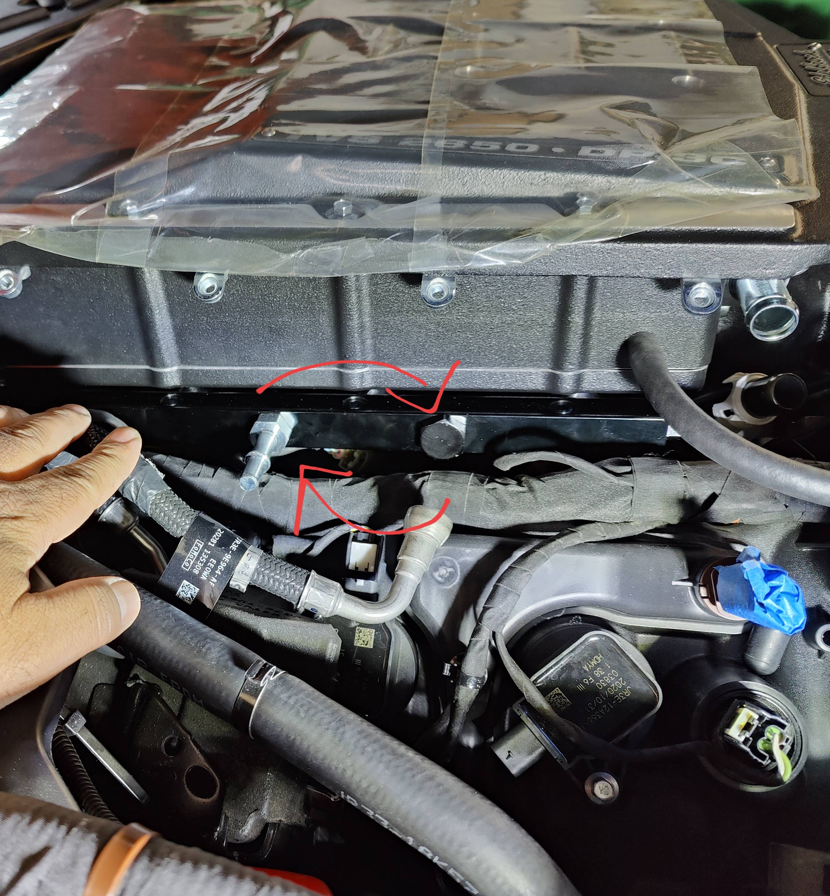

Getting close to finishing my install and had a question about the passenger side fuel line. So Edelbrock has the line mounted in the center of the fuel rail, but the fuel line that connects is long enough to reach the first hole that's plugged. Edelbrock seems to think that if the engineers put it there then there must be a reason. However looking the stock fuel rail it feeds from the front. Anyhow at the end of the day it's not a huge deal if I leave it but it does bend the hose quit a bit. Any helps appreciated.
