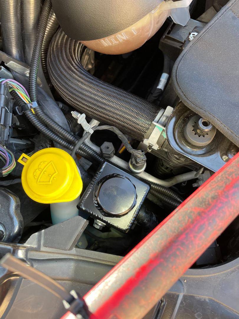

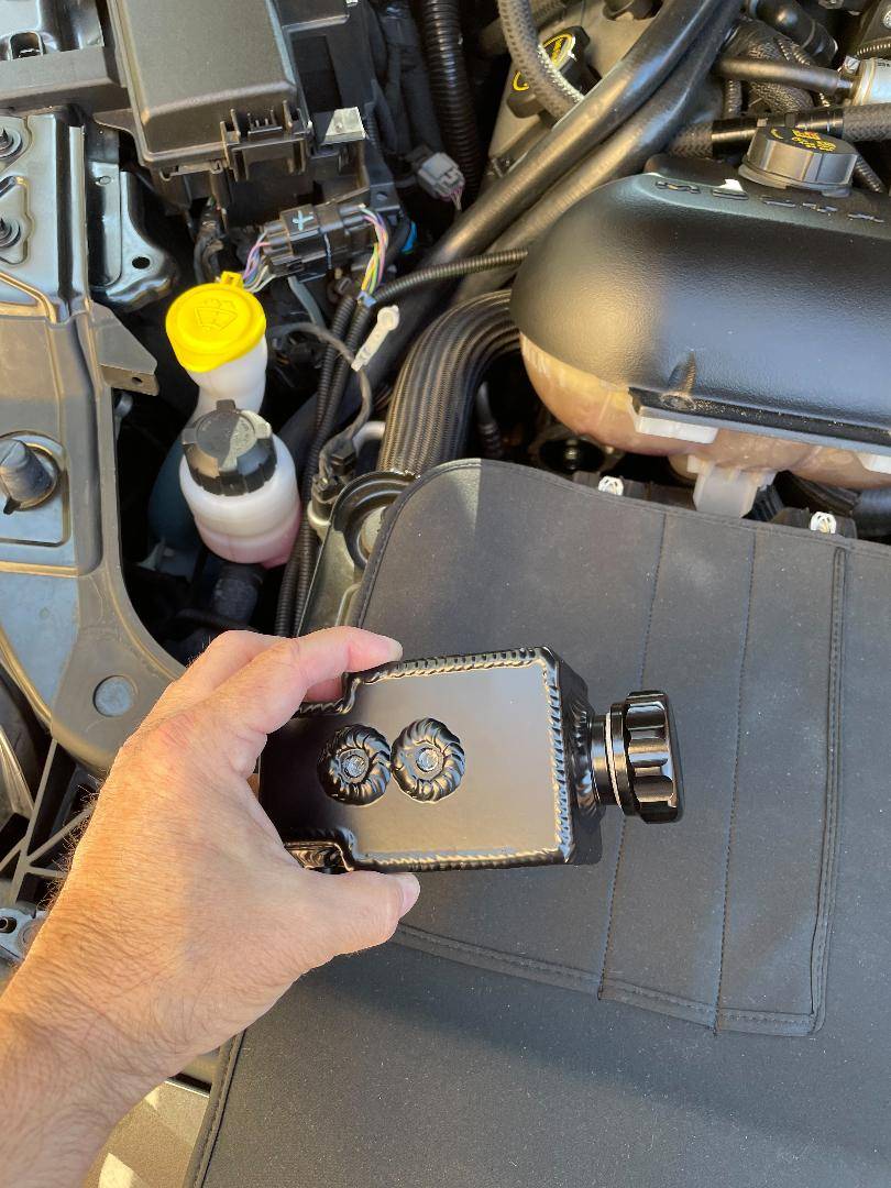

So here is the completed prototype aluminum surge bottle #000.
I will have a member test fit it. If he is still interested. As I have told him it's mine, so I'll sell it at cost, if it is wrong send it back with the interference markups and I'll have another made. If it fits and he likes it keep it. If it does fit this will be what is sold.
PM me if you have questions.

Last I heard, he had two left. I was one of the testers and have had great results.

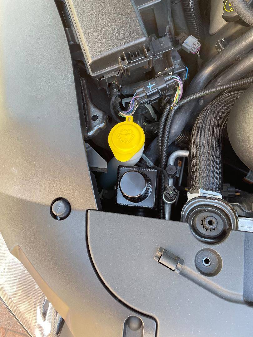

Finally put mine in today after having it powder coated black. Works perfectly, although you will need new bolts and have to flip the bracket around.

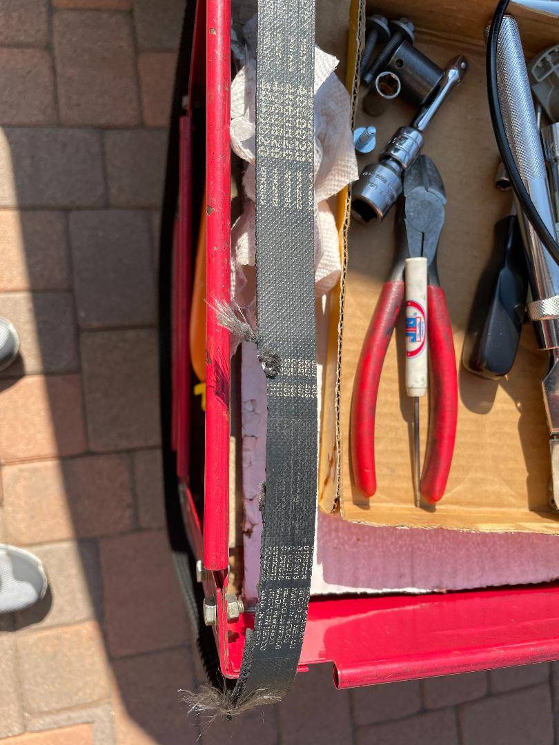

Had to replace the serpentine belt after about 1,400 miles. The new 82-inch long Continental belt with the same exact part number is a little different as it is not an "Elite PolyV with Quiet Channel Technology" and is just a standard 6-rib "Multi V-Belt". I was pleased to find the 4060820 at AutoZone - nobody else seems to carry it. Had to unbolt, but not disconnect, the radiator overflow bottle to get in there, and it is almost definitely a two-person job. I also enlarged the belt routing diagram and carry a copy in the glove box, just in case.
I'm going to pick up a spare belt as well.

Did your belt snap or just felt it needed to be replaced? I purchased a green belt as a spare but haven’t felt the need to change it yet. I’m about 6000 miles right now... originally noticed dusting from the belt in the first few hundred miles but nothing since.
See pic. Initially one rib got ripped off somehow, they noticed it at that dyno pre-check. It got a lot worse in a week or so of local driving [no racing]. There is one other small crack as well.
