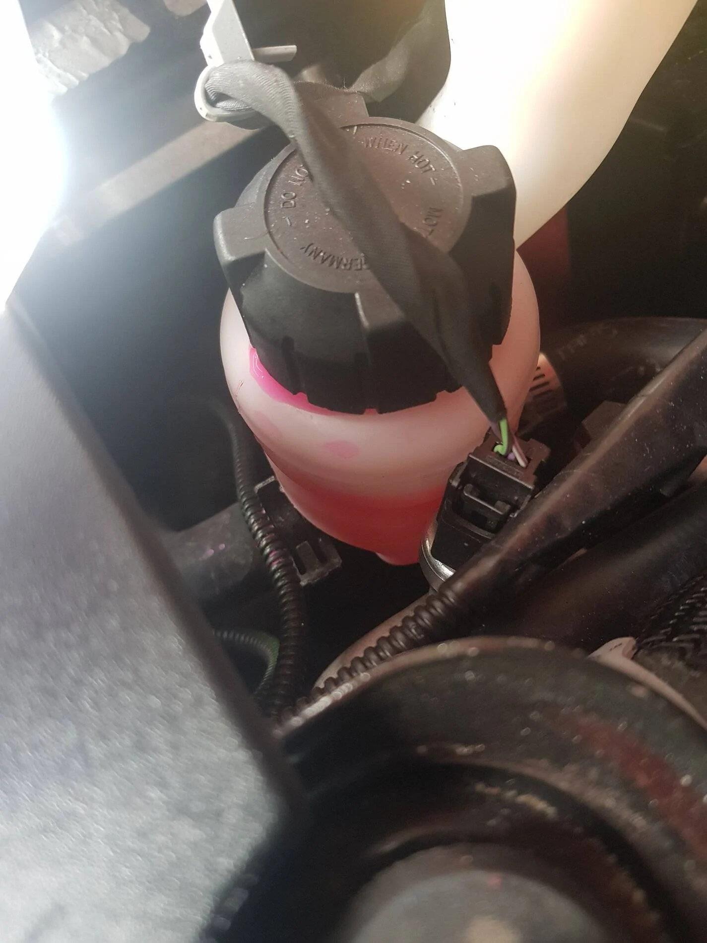

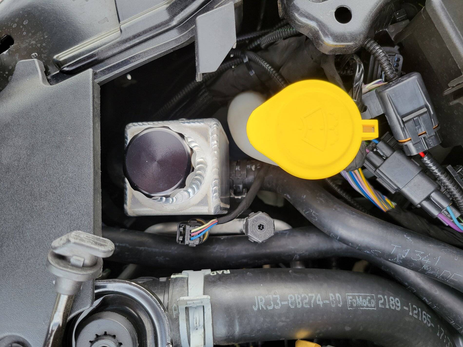

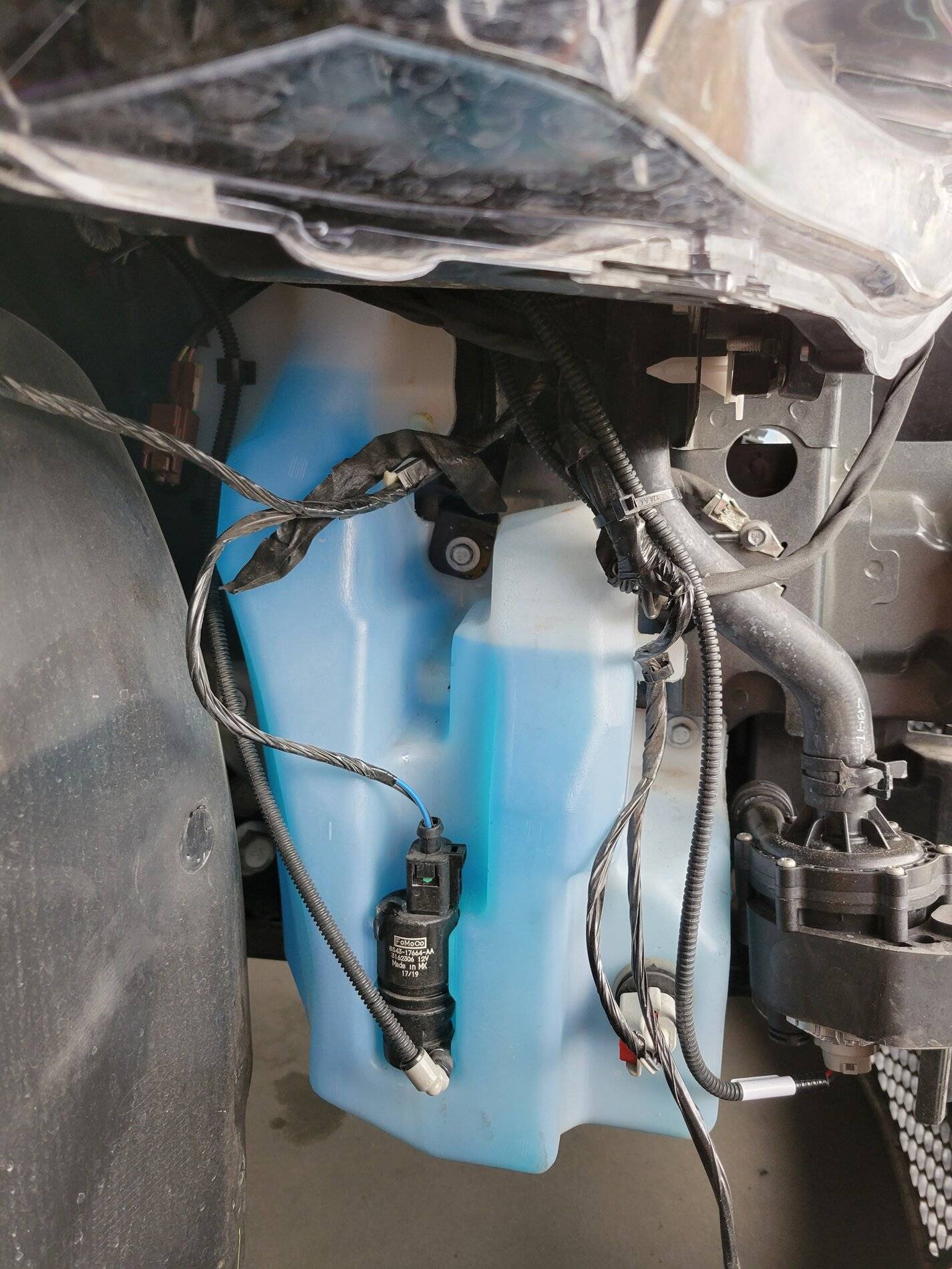

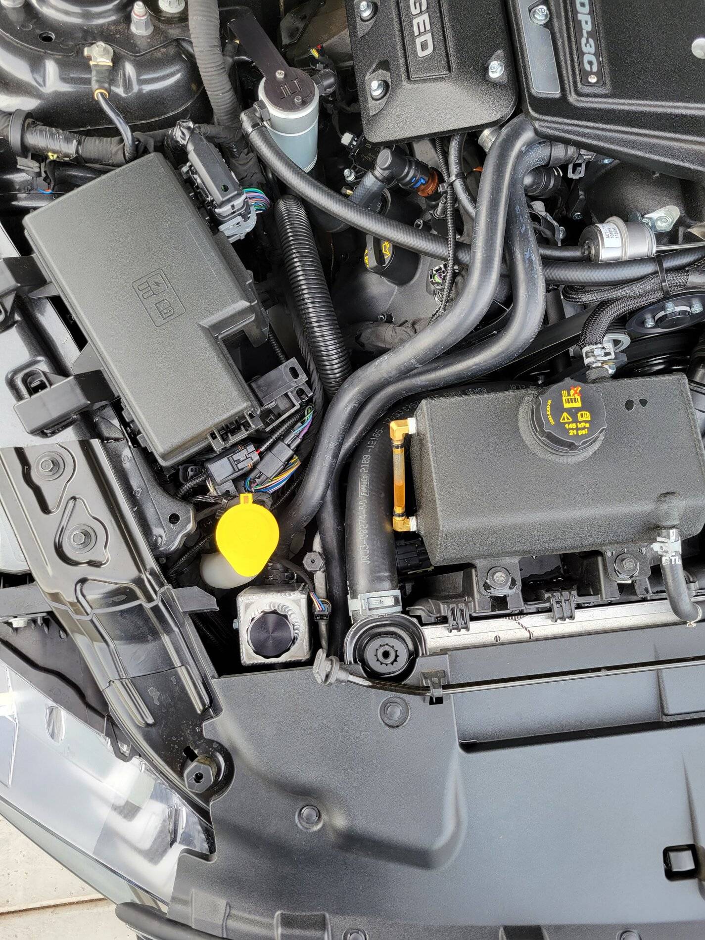

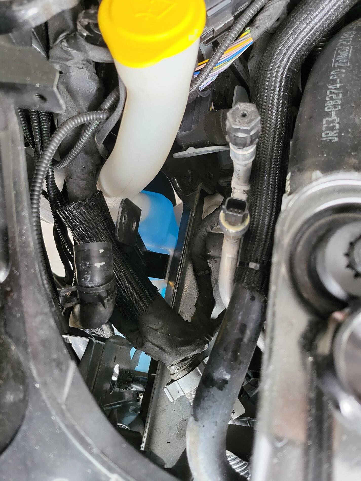

Can you post a picture or diagram of how it is setupHey guys,
I have a 2019 gt with a edelbrock stage 2 kit I have my intercooler fluid going into a whipple tank and then to the pump and heat exchanger. Doing this because I have a killer chiller setup. My pump will randomly not move fluid though and I have to fill fluid in the reservoir. When the car is in key on only you can hear the pump humming but no circulation in the system. When you start the engine after a cycle it will start working again. Any ideas what this is? Was thing about just swapping to a vmp upgraded pump kit if they work with our system? Any advise would be greatly appreciated
