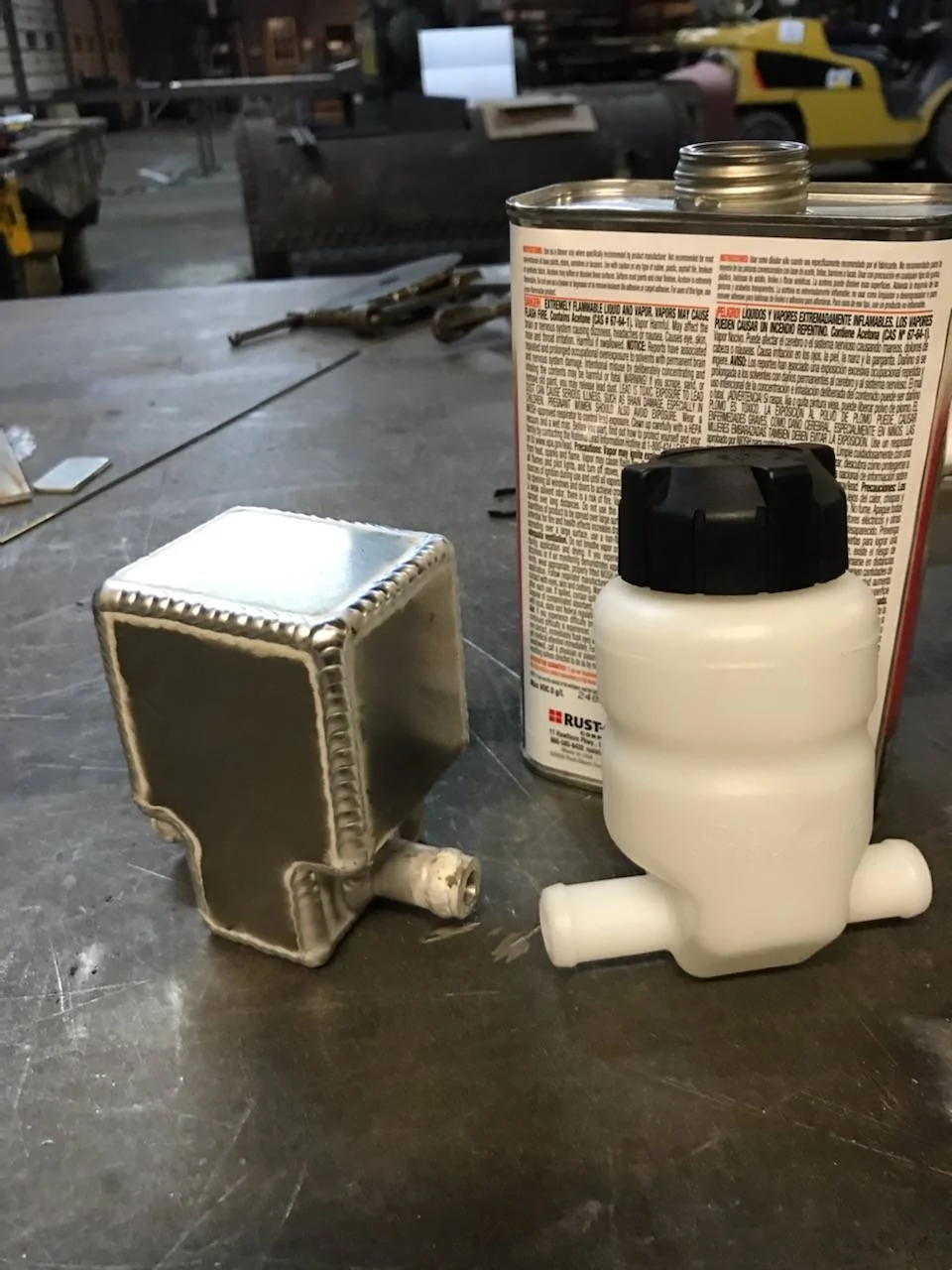

Just a little progress on the bottle. When it is finished, and he quotes me a price I will start with 5 unless there is a greater demand for them. I may have to get someone to test fit a bottle, but I should be able to do that in January at the latest unless a warm climate member can do a test fitment for me. If that can happen they can get the first production model at cost.
Please dm me if you are interested. I don't have pricing as of yet. After we get a working prototype we can lock it down then.

I’m in Arizona, it’s a little cooler than normal, will be 65- 70 degrees this week. I would be happy to test one. I have gone through 2 of the plastic POS bottles. With the plastic bottle I’m afraid to tighten the cap to where it should be. PM me, if you need a test Mule.

Well I would test it on my own car but I'm working in Europe for now. I will pm you today for you information. I also have an alternative bigger bottle/swirl can that I will be having a mount dabbed for because it is significantly larger than the bottle in the "stock" location.

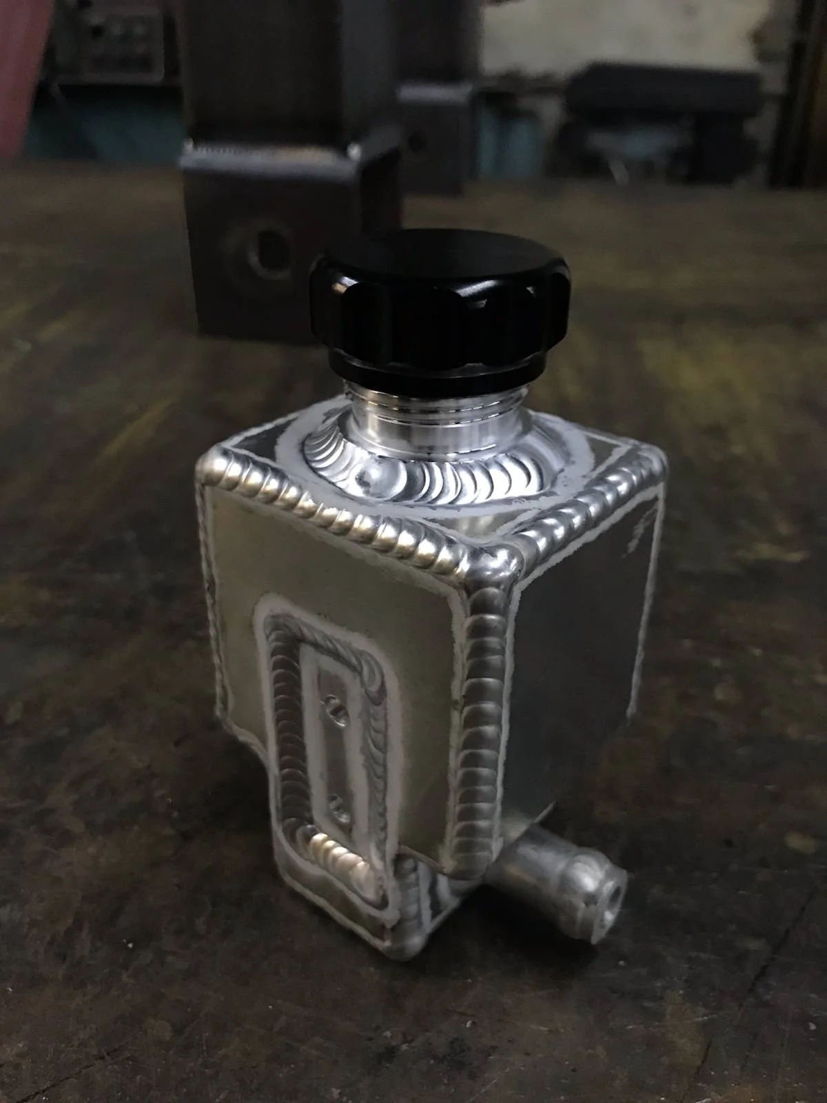

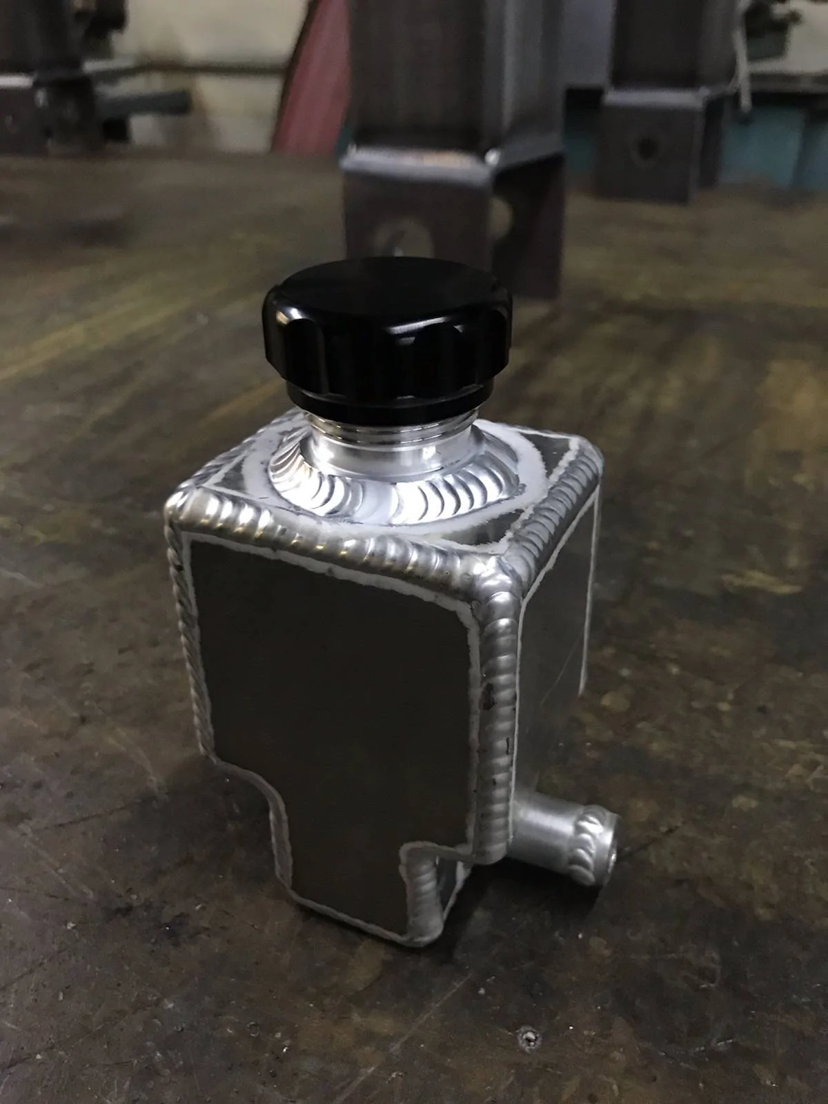

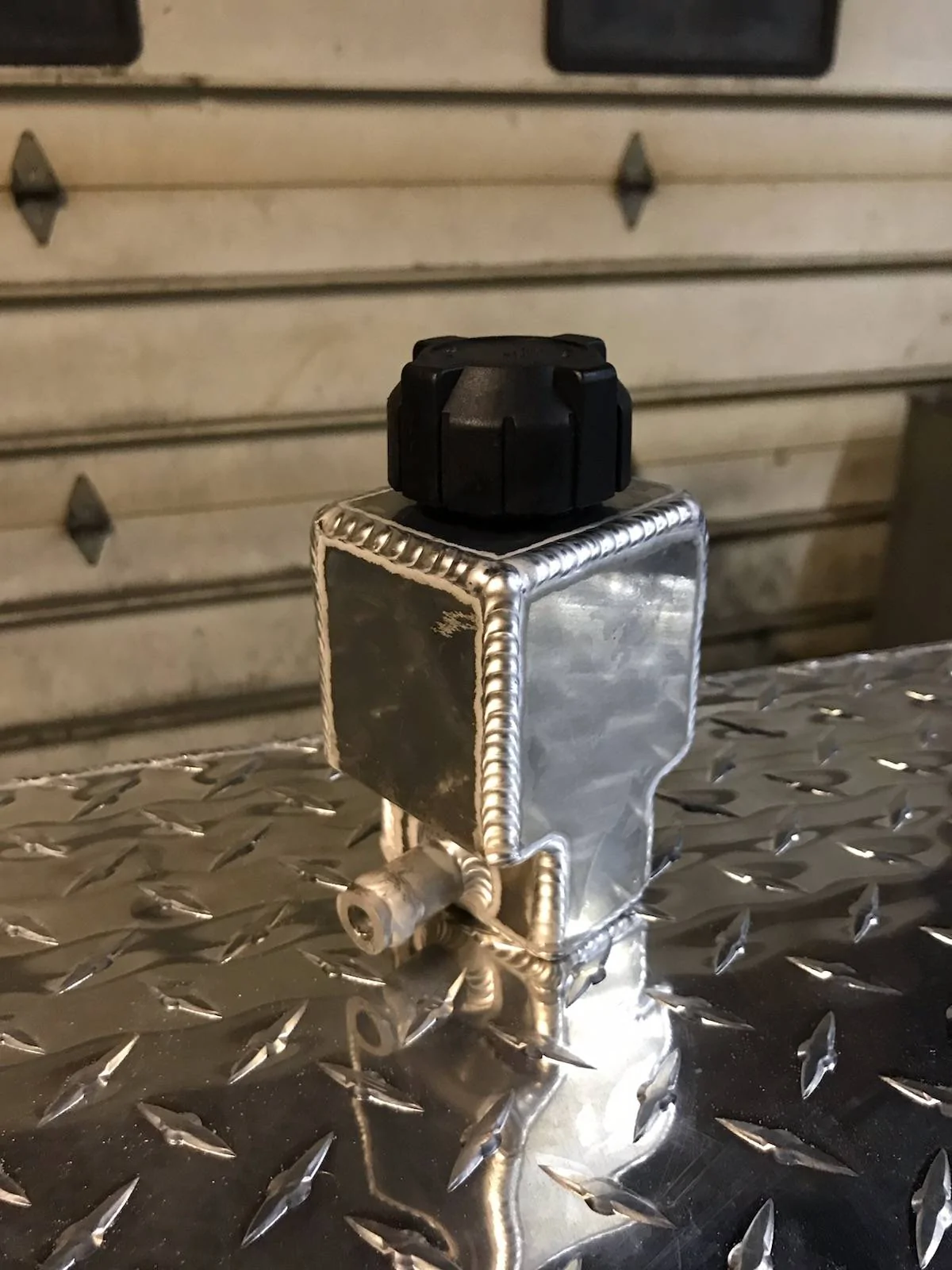

So here is the completed prototype aluminum surge bottle #000.
I will have a member test fit it. If he is still interested. As I have told him it's mine, so I'll sell it at cost, if it is wrong send it back with the interference markups and I'll have another made. If it fits and he likes it keep it. If it does fit this will be what is sold.
PM me if you have questions.

Looks good.
What cap does it take?

2016 GT Convertible
Yes. But is it a regular rad cap or the Same as the one that comes on the current tank?
Will the fitting have smooth barbs to avoid leaks? Those welds might not seal well. And yes I am interested.
It is a cap we bought to be welded in place with the aluminum neck. I didn't buy it but I went ahead with the idea so he didn't have to fab up one from scratch (costs more).
I will enquire about if the auto parts store will have something you can slap on it if you lose the cap.
So these fittings are weld on as well. He has told me this should make the current hoses a tight fit. If that is the case you will not have a leak. I have had bungs done like this and they don't leak. Obviously, I'm not trying to sell a leaking bottle. If the tester guy says it leaks, I will change the design no problem.
