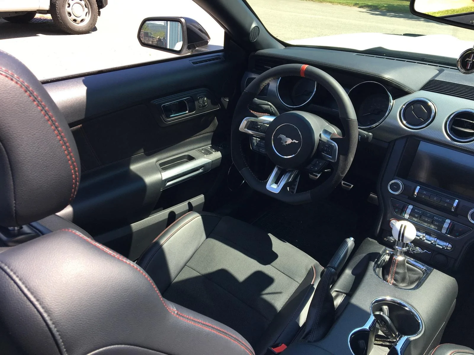

Red stitching is nice. I think the cover will go nicely with my red stitched CS seats, door inserts and shift boot and CJ steering wheel.
Now just need my new Anarchy Motive knob to show, an all will be right with the world....:first:
I know I have posted this image in another thread....Just giving some reference
I’m sure it will tie in very nicely :thumbsup:
Looking forward to seeing your new shifter ;)
I’m so glad I reread and corrected my last comment, it could have been read totally wrong :lol:

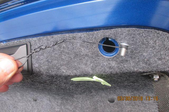

Borrowed this post from [MENTION=32849]Joe B.[/MENTION] It looks like a better way to mount the strap to the trunk lid.
" It's easy to fish a bolt through the large bumper stop hole into the 1/4" retainer hole".
Wish I'd thought of that. Thanks

Thanks guys, here's a for instance. I used a 1" 1/4-20 large head bolt and ran a washer and nut tight to the trunk pad. Then another washer, the strap, washer and nut with a little locktite.
