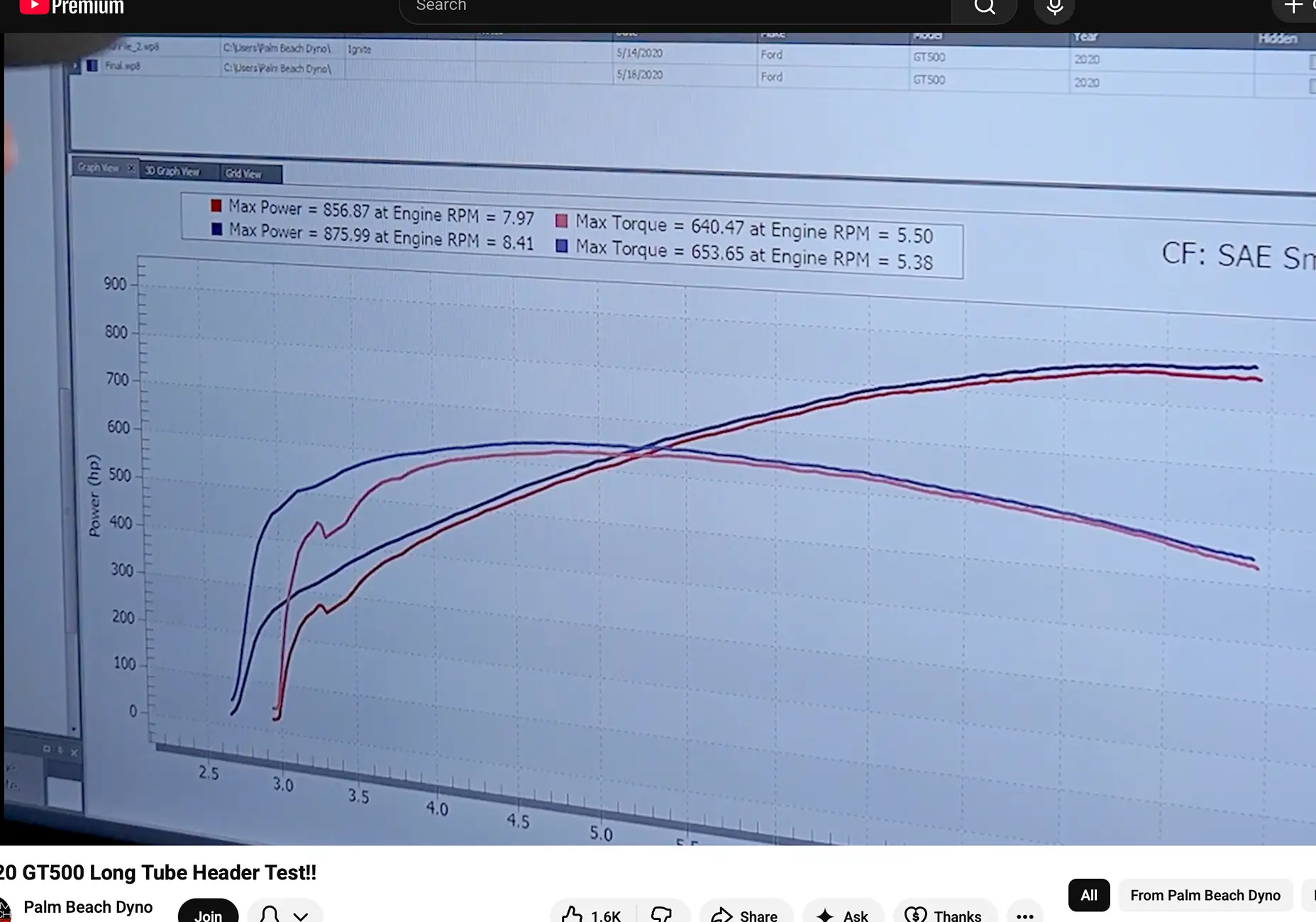

Also, not an apples to apples comparison for various reasons, but there are also videos of GT500's only gaining like 15-20hp from longtubes

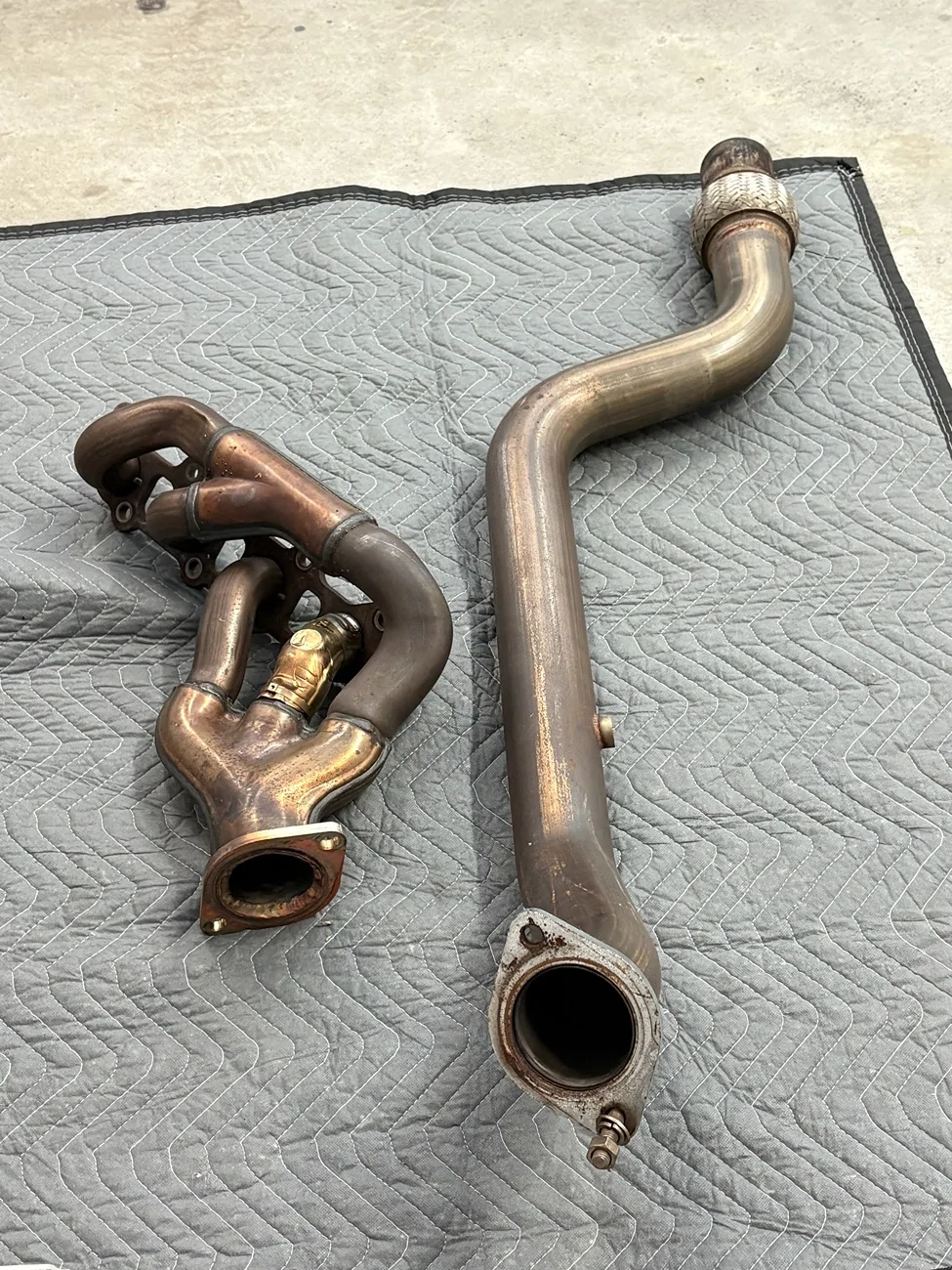

Not sure if the ULTIMATE gt350 headers are different than the Coyote ones, but I have a NIB set with cats and a set of Off road mid pipes with their fancy clamps for sale in the Gt350 section, All NIB. $1000 less than I paid
I'd be interested but my Coyote heads aren't tapped for the reversed center stud pattern used on the Voodoo heads. Kooks uses a universal header flange with holes provided for either stud/gasket pattern.

Engine masters etc have done a lot of header tests, they always make more power
how much and is it worth the $2500 is the question
also they make your car so much louder they trick you into thinking you're not making much more power (car feels faster when quiet, and it's probably only 15hp anyway)

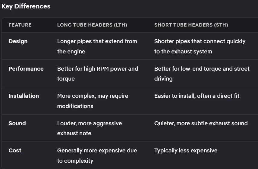

I would say that's true over the old cast iron manifolds. But Ford spent time and money designing the "shorty" tube header for the Coyote. Yes they had to meet emission standards and packaging constraints, but they also knew they had to achieve as much power as they can to compete in the market place. As Engine Masters has demonstrated "shorty" headers makes more torque at the lower RPM range, where the Coyote needs it most. This makes them more desirable for street use. Long tubes, on the other hand, make more power at the top of the RPM range, which makes them more desirable for the track. The Gen 3 Coyote is already tweaked out from the factory as is. It already flows enough air for it's displacement. Throwing thousands of dollars at it for NA with CAI, LTH, and exhaust pipes for very modest gains, to me, is a waste. I think just an E85 tune is all you need on a stock engine. Now, everyone knows that the Gen 3 responds well to forced induction and that's the way to go. As usual this is only my opinion and it my differ than yours.
You have this backwards
