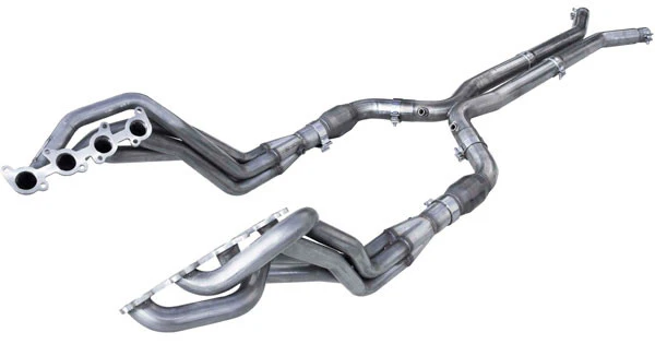

How does that work? Keep the headers but replace the cats?

Most header companies sell off-road pipes to put in place of the cat pipes.
If you look at this picture you can see there are 3 parts:
1. The 'headers'
2. The cats (or off-road pipes if no cats)
3. The X/H/resonator section
You can easily unbolt and swap parts out.

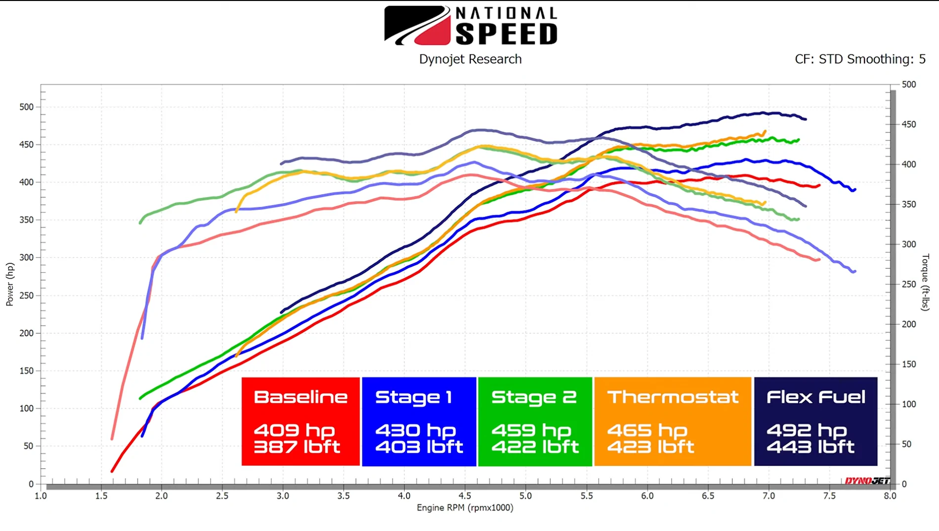

Baseline, CAI +tune, headers, last one is E85
