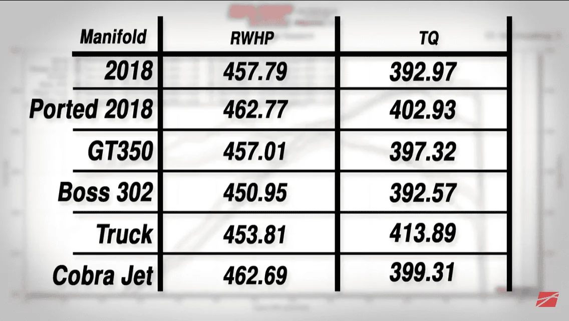

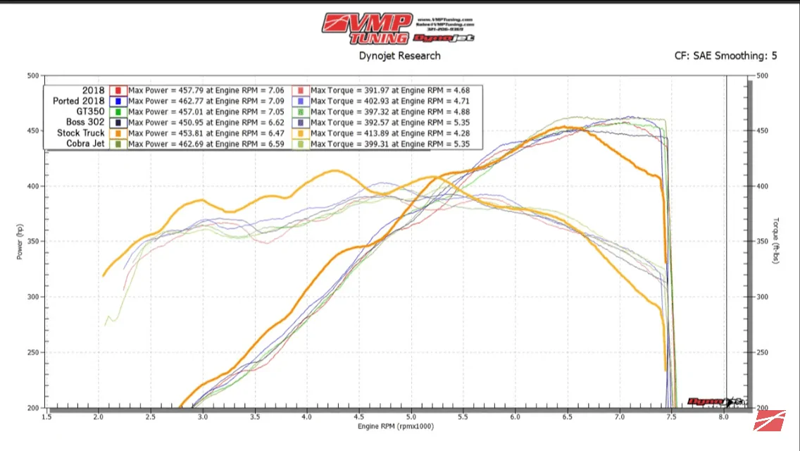

The point imo of the cobra jet is also pretty much sustaining that power from 6600-7800 (hard to tell how high you ran it?). 500 whp that low is good on street car. Drive it and enjoy it. Jesus...

This kinda confirms your max hp being @ 6600 rpms on 18. VMP test of 6-7 manifolds.
