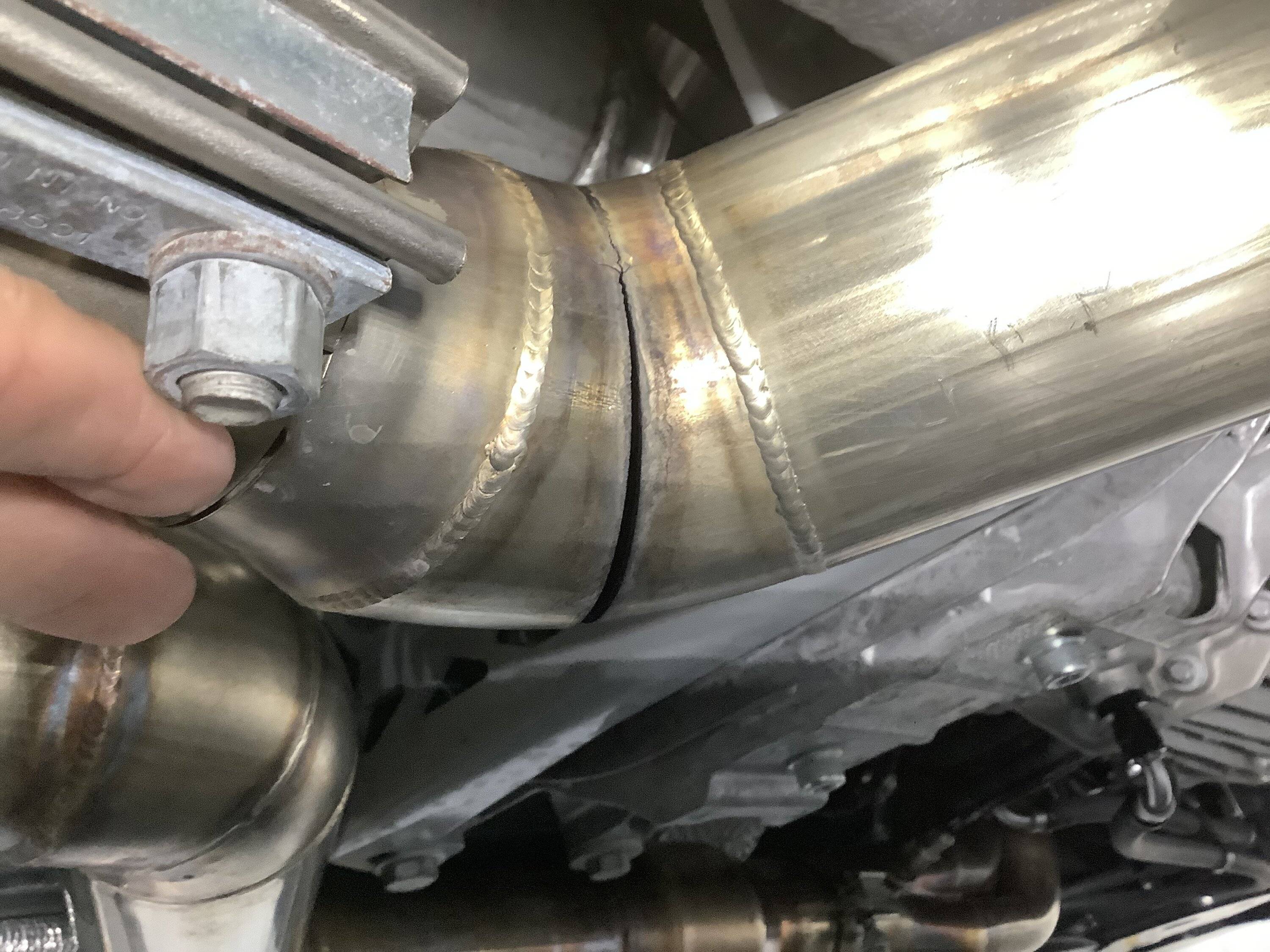

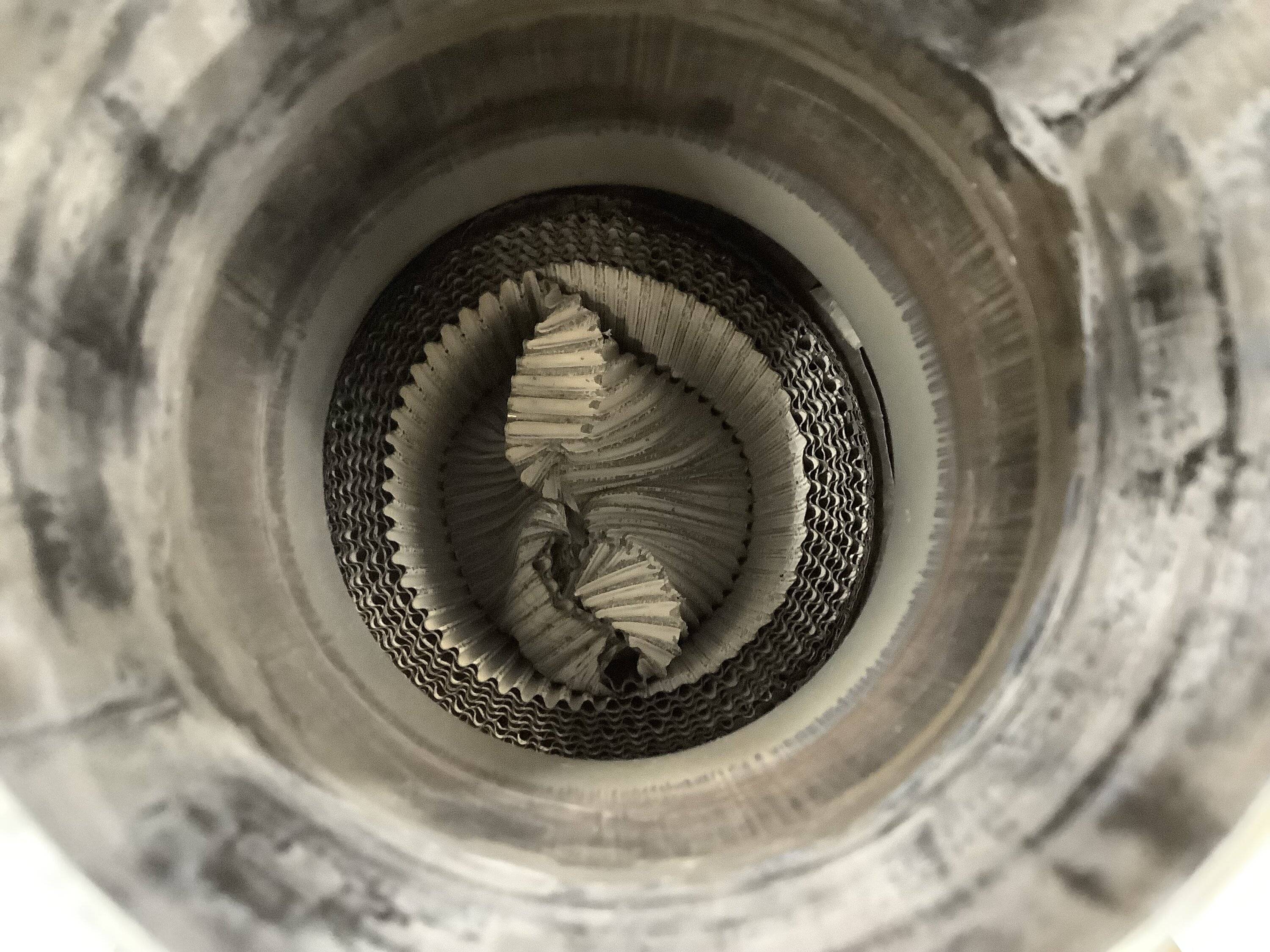

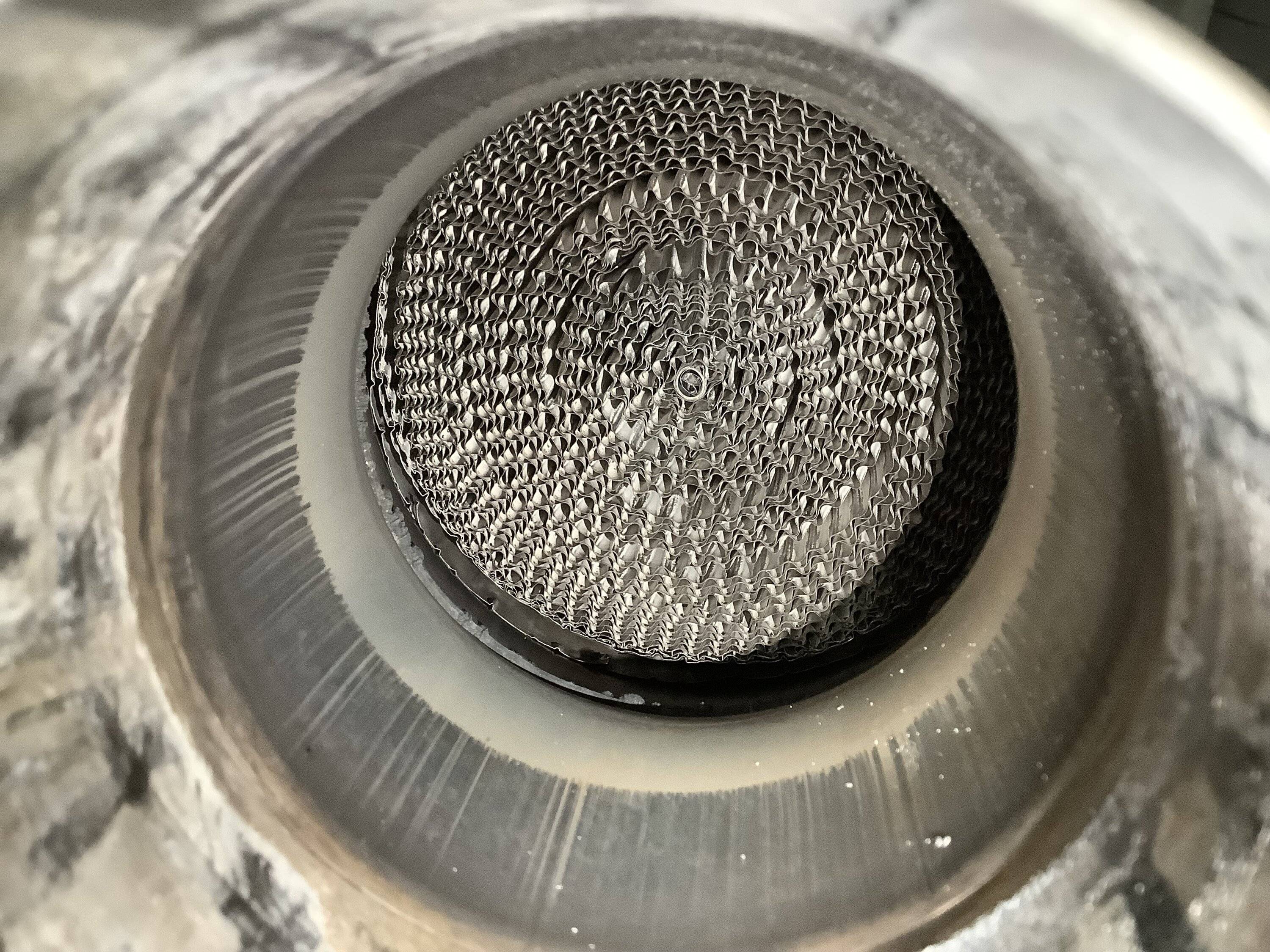

Last night, I went to the drag strip and made 5 passes (one on motor and 4 on nitrous). Right away, I noticed that the motor was breaking up during shifts between gears 1-4 (almost as if I was hitting the rev limiter, but I wasn’t). This happened several times during passes and was sometimes intermittent. On the drive home from the track I noticed a drastic change in the exhaust note.
Today I put the car up on the lift and found that the driver’s side cat had been blown out and a weld had also broken on the passenger side of the mid pipe. Has anyone else experienced anything like this?
Lastly, how much of an effect do you guys think this would have had on the mph during my runs? Sixty foot times are a whole other story, lol.

Just gut them. You can't blow out the cats if they have nothing in them.

Where I'm at, we have to at least have the cat shell still in place, they do a visual inspection here. But straight pipe will do they same thing.

Is it just the photo, or does the split ‘weld’ not even look like a weld when compared to the ones on either side of it ?
Around the underside of the pipe, it looks like the tubing has simply been cut open - with straight edges and zero weld penetration ?
Hope you get it all fixed up :like:
