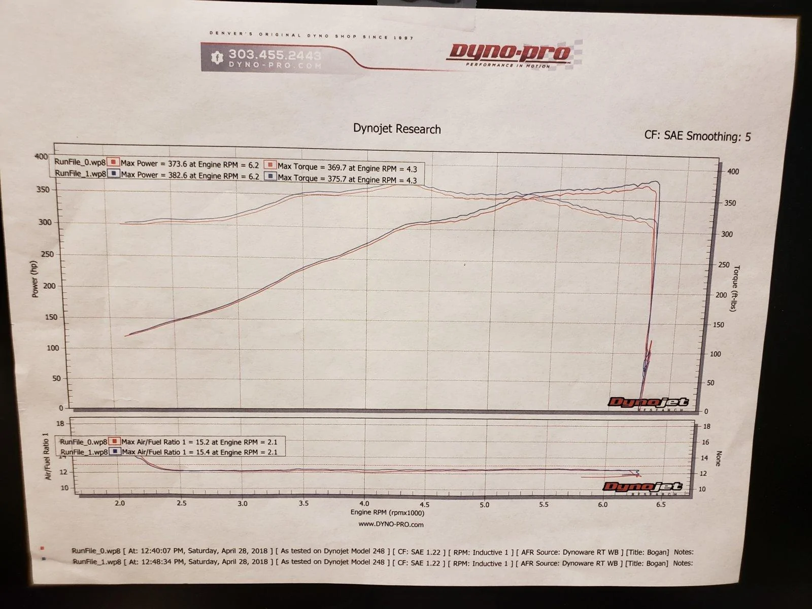

Installed the GT350 IM, TB and CAI with full catback but no headers on a 6sp manual.
Base dyno completely stock before any mods was 382 HP / 375 TQ

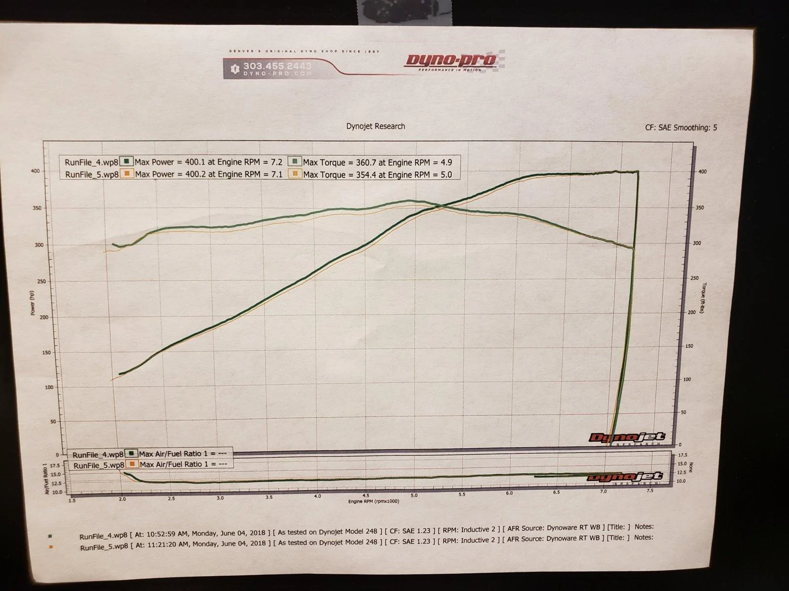

Tuned dyno with all mods was a whopping 400 HP / 365 TQ. Running 91 octane on a FF tune
Tuned dyno running E85 was a whopping 403 HP / 365 TQ
NOT IMPRESSED . Would love to have some of your guys numbers.
I thought I could get those numbers with just a CAI and tune. Why did I bother with the GT350 IM. And E85 did nothing.
I get that different dynos on different days perform differently. But my numbers are not even close to most others on this forum.
The car is slightly faster but would not call it night and day difference.
I'm a no go on headers now. Why bother for another 5 HP

You need to work with your tuner on this. Something is definitely off. Just so you know, that GT350 intake manifold will cause you to lose peak torque but it'll carry higher, or should anyway. That definitely is not a great example.
I did not expect any boost in torque based on dyno info from the PP3 data observed. I did not go with the PP3 and purchased the parts separately thinking I would see better results with a 3rd party reputable tuner.
My tuner , which did a remote dyno tune session with 3 pulls , says that everything looks good and that is what he expected to see. I voiced my disappointment but it fell on deaf ears. So I guess working with my tuner is not an option.
At least the car has good drivability. Although it idles a little rough when first started on E-85 for about a minute and then it smooths out. I'll put 91 back in when the temps start to fall.
Not sure where to go from here unless I want to spend more money on another tuner. Or as everyone tells me "Just go FI and quit screwing around"

Post the dyno graph. GT350 IM kinda needs headers to shine.

Looks like it stops pulling hard after 6k, doesn't make sense though since you got a 350 mani
With your mods + e85 I would at least expect 440-450 whp
But all depends on dyno, day, tons of other factors.
Your best bet is to get it on the 1/4 mile before spending money on another tuner.
Dyno numbers don't mean much IMO, trap speed where its at
