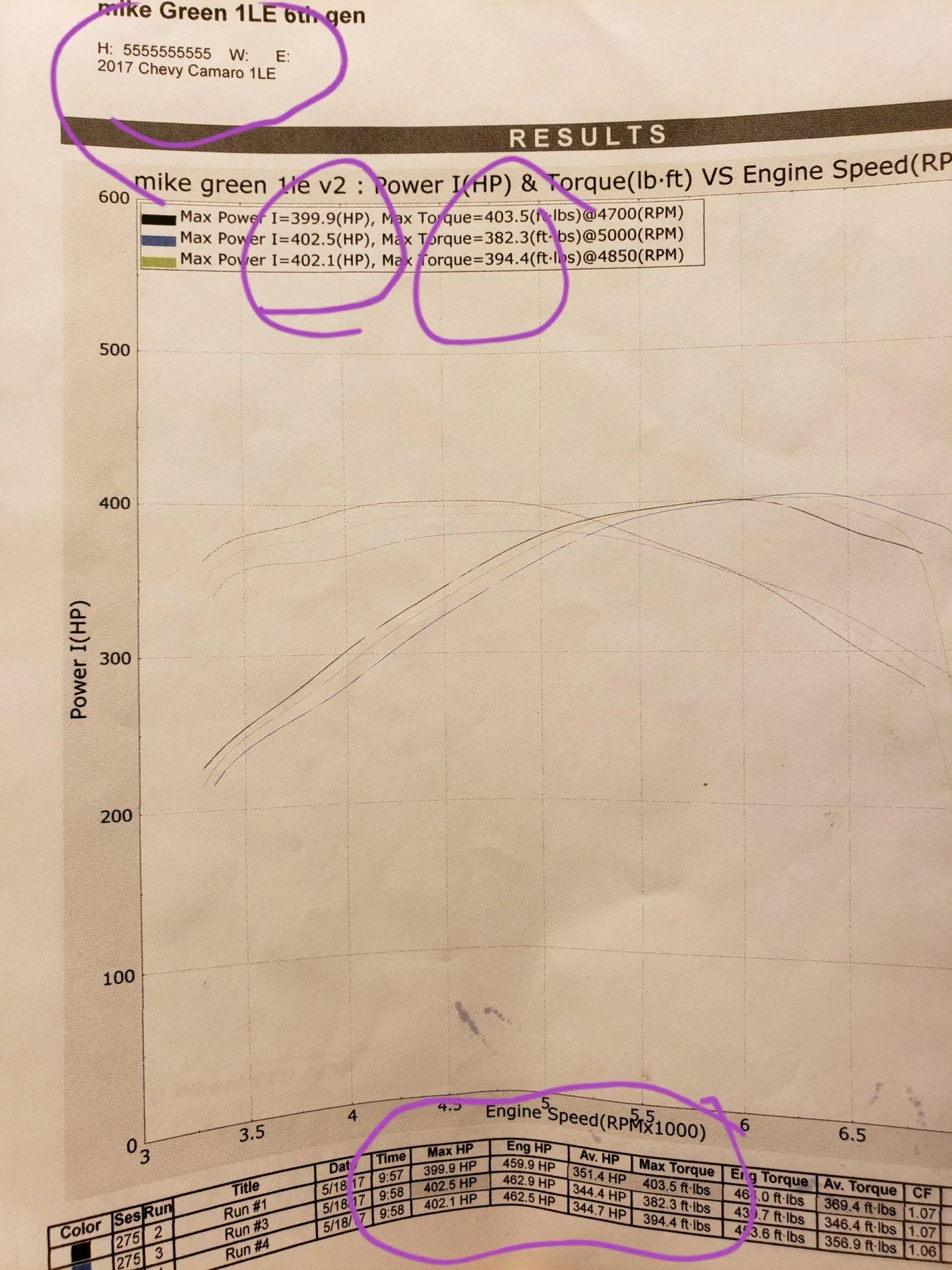

Got the mustang on the dyno here are the numbers. And the old camaro 1LE's printout for comparison.
