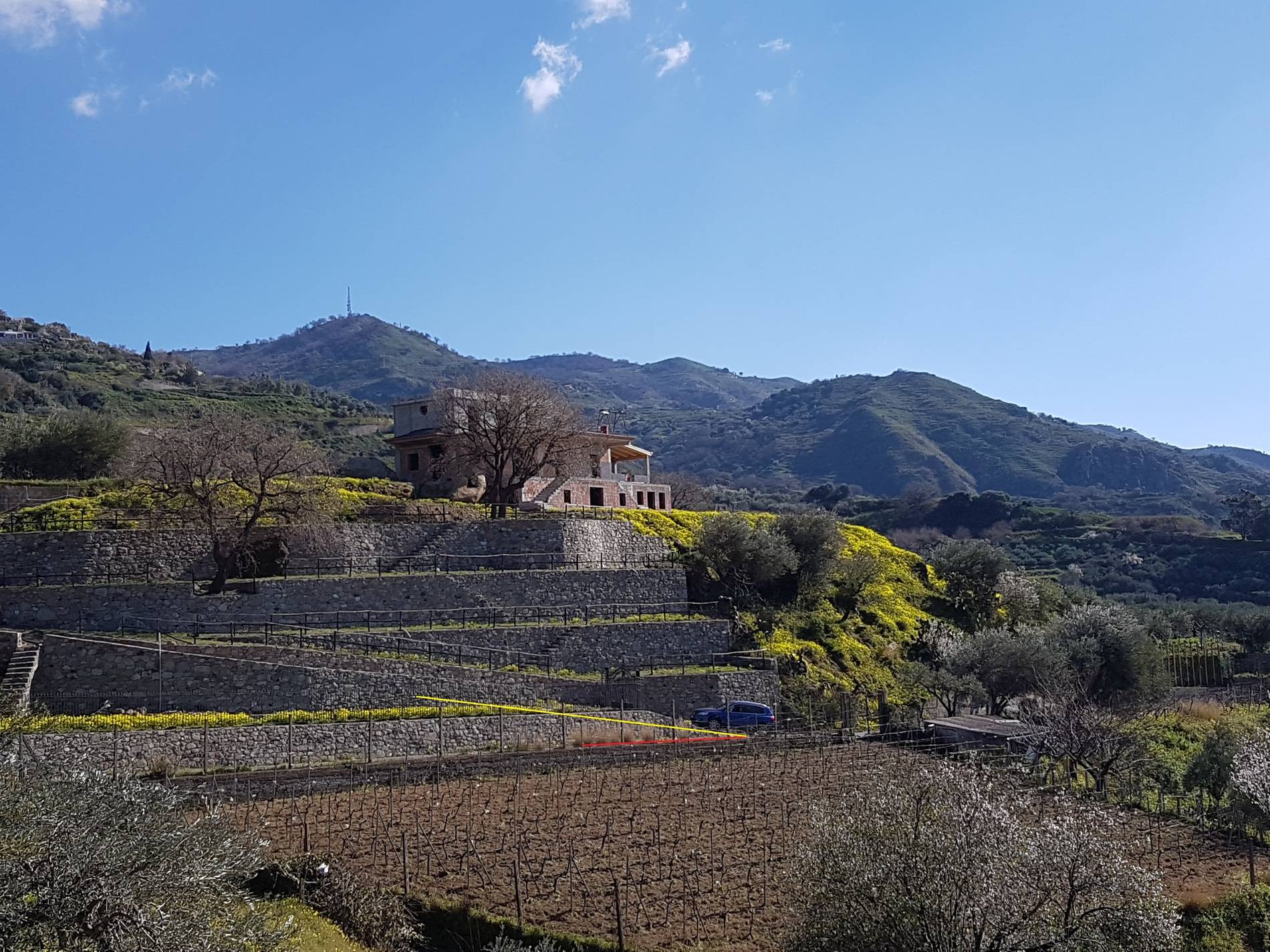

This is an old photo of the house project from a few years ago - the blue vehicle at bottom is at entry = you can get a sense of the angle as you enter and once on driveway it is relatively flat going all the way to the top.

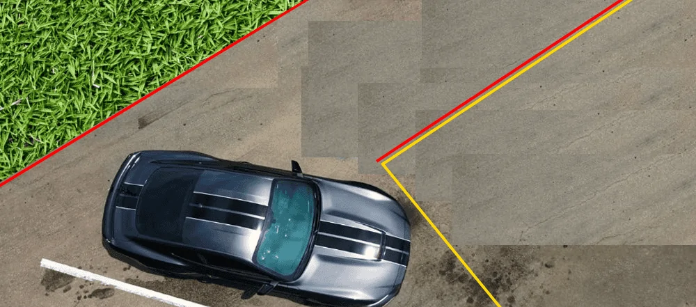

I was told by a few others that the R has a 7 degree angle and 350 (non-R) is a little more. If project remains as is; think I may be in trouble. Red line is main road, yellow line is entry and line of continuation.
Forget about a car man. You need a helicopter to reach your residence. :crackup:
Excuse the quick crude image thrown together. But from what you are saying, can you not swing from the left side where the main road in red goes so that you can angle into the yellow drive?

Huh. The city won’t let you modify YOUR driveway that YOU own?
Is there an appeal process or exemptions you can research?
I agree w the others about taking sharp grades at an angle can help a lot. There are also screw on sacrificial splitter thingys that can help minimize damage..
Beautiful place btw! Good luck!
It's Sicily. They'd be crazy to let people modify things too much given it's history and significance. Not surprising to me.
