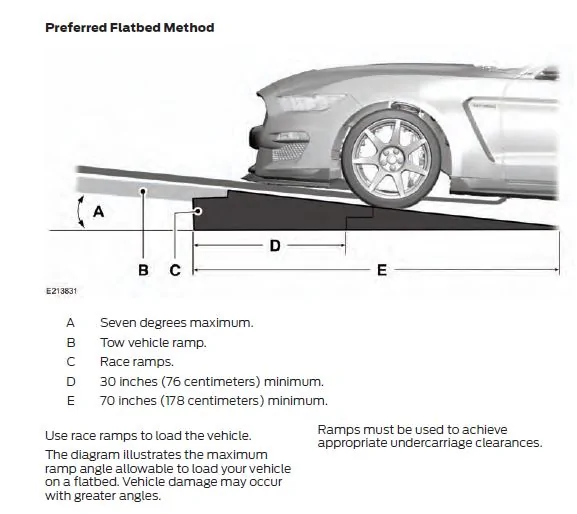

That image is $$$$ thank you. THANK YOU!!!! 7 degrees max for R = a little more for non-R.

Thanks for the image and question. I think based on the information received so far I can "modify" my driveway without asking permission... enough to get it under 7 degrees. Goal is to drive in like a normal person... perhaps at 100 MPH but you know.... I may need to pump the brakes to make it work.
