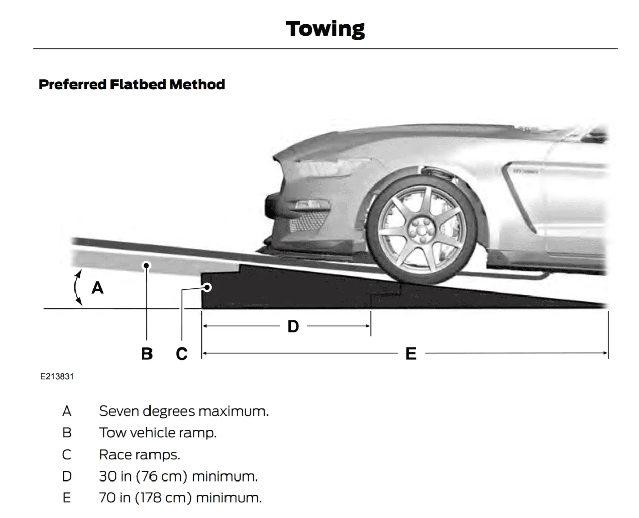

This isn't the break over angle but you may have a problem with the approach angle before even worrying about the break over angle. Looks like seven degrees based on the towing info in the supplement:
I’m less worried about the approach angle since the car sits a little higher than stock due to the tires with taller sidewalls I put on. I can also come in at a bit of an angle since the driveway is about 1.5 car widths.

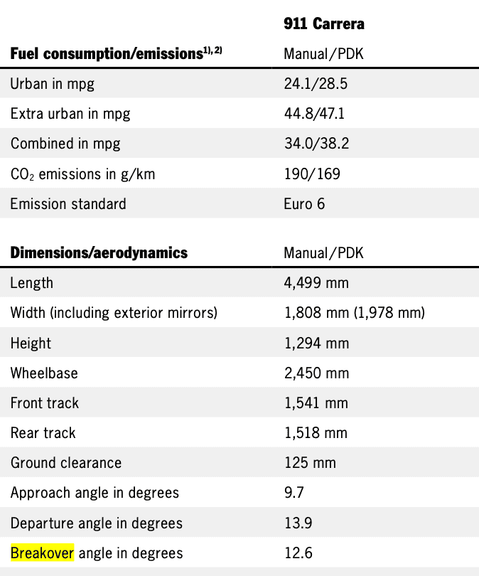

It isn’t often easy to tell if the car will make contact but I do not believe a break over angle would ever be quoted for a car since they don’t go off-road. But if high centering is a genuine concern for you I’d imagine your splitter clearance would be a problem also whether you have taller tires or not. I could be mistaken but in all my years and miles driving lowered cars this isn’t something any driveway, speed bump or transition had presented. Good luck.
Porsche does quote it for the 911; supposedly it's 12.6 degrees. Which makes me think the ~11 degrees I calculated for the GT350 is plausible because of the Shelby's longer wheelbase.
The slope of the driveway decreases from 13 to 8 degrees at the bottom. 1 degree too much, but I believe I can manage that since I used to park in a garage with a similar approach angle at the end of the driveway.
I stand corrected.
