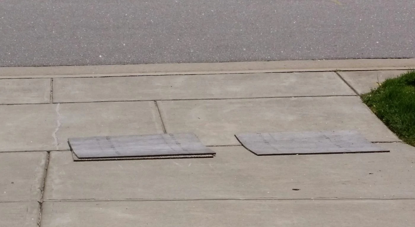

bridjit works great..still use slight angle. use long 2 x 4 if no bridjit. your wife won't like it but it works.

I think the owners manual recommends at 7 degree max incline transition with respect to loading it on a car hauler. Drive way and other street transitions apply as well. If you have some fabrication skills you could fabricate a portable driveway transition piece to facilitate entering or exiting.

I can deal with a light "drag" where it just sort of glides over the concrete - I'm not worried about the bottom. What I don't want is to hit the front edge and catch or flex the splitter enough to risk dislodging it or causing significant damage.
Not sure if you can see from my picture, but the lip on my driveway is only an inch or two. It is the rate at which the slope increases. I don't think this would solve that.
I had basically the same issue and didn't have a double depression like the bridjit video shows. Still works fine. Worth a shot.

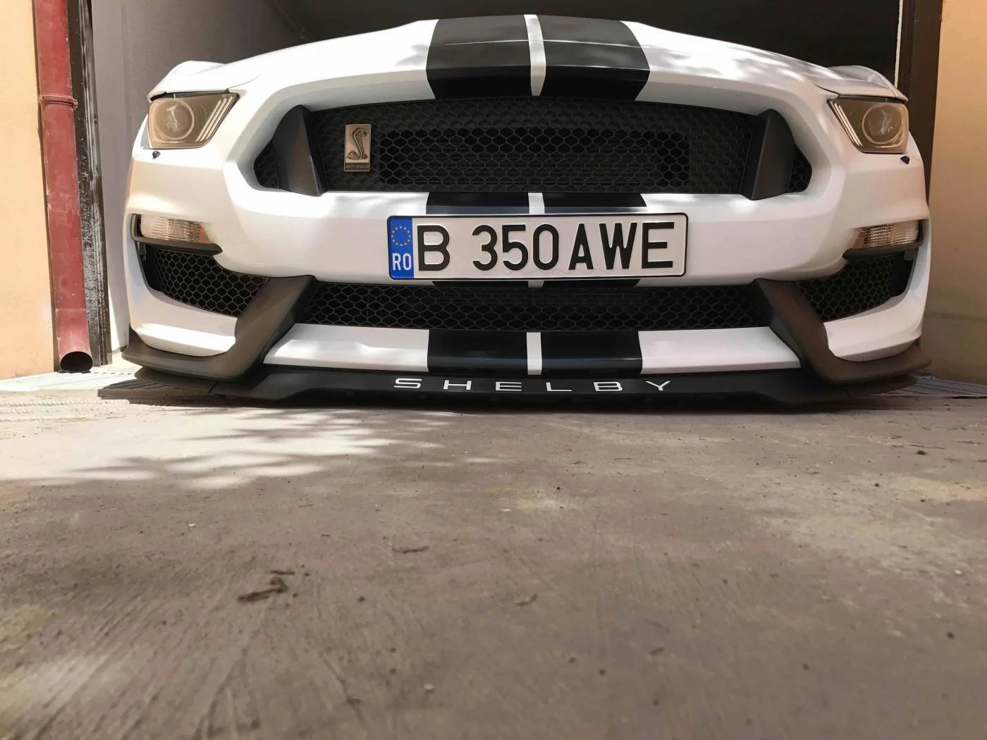

The non R splitter will not be as prone to scrape as the R splitter but it's not due to clearance as much as how far forward of the wheel centerline that it is and in this respect, makes the R splitter worse as it protrudes farther out. The distance they extend forward allows contact sooner with the road surface as the front tire gets to the low points in the street. I've owned lowered cars for many years with less ground clearance and did not have scraping issues but the Shelby is just scrape prone. The front of the car is just long and is something we must live with. Have to rent a concrete grinder to fix the clearance issue getting into my driveway. I was all set to order springs but after realizing how easily it scrapes decided against it. The only real solution are bags but for me those are bordering on cost prohibitive.
