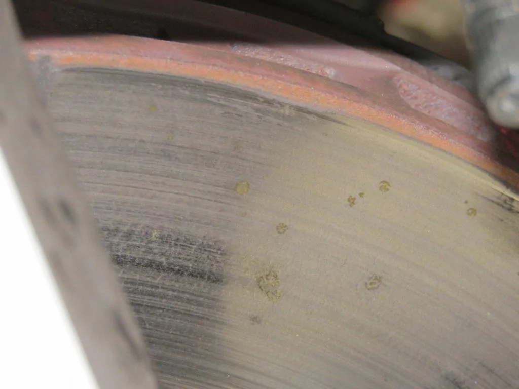

Heat cycling can even get surface cracking started in plain rotors, where there aren't any built-in crack-start locations. Here's one of mine from a couple of years ago, that's never seen more than 130 mph at the beginning of any braking event. If I can catch a fingernail anywhere on a rotor, it and its mate on the other side of that axle goes in the scrap heap regardless of how much measured thickness above minimum remains.

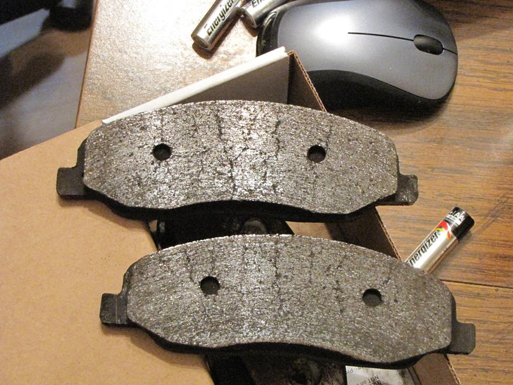

Even track pads can crack from the heat. Note that every hole has a crack starting at or near the middle of the outer edge (closest to the pad OD).
