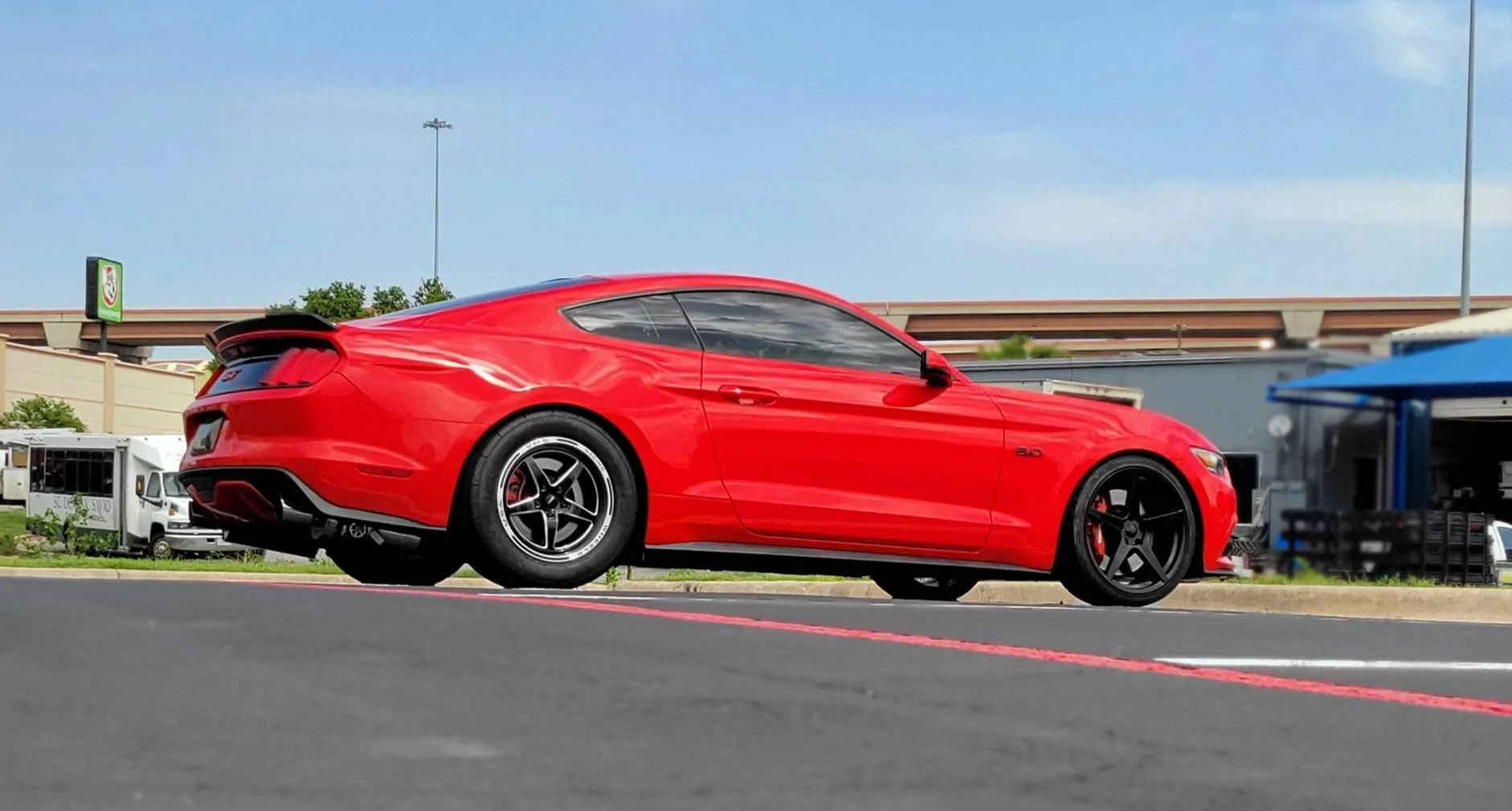

Thats what Im running right now, fits perfect. I have steeda progressives with VMS 17x10 and a MT street ss 305/45/17.
You can also adjust camber in the rear if you are worried about any rub. Performance wise, I'd recommend getting your camber as close to 0 as possible.
