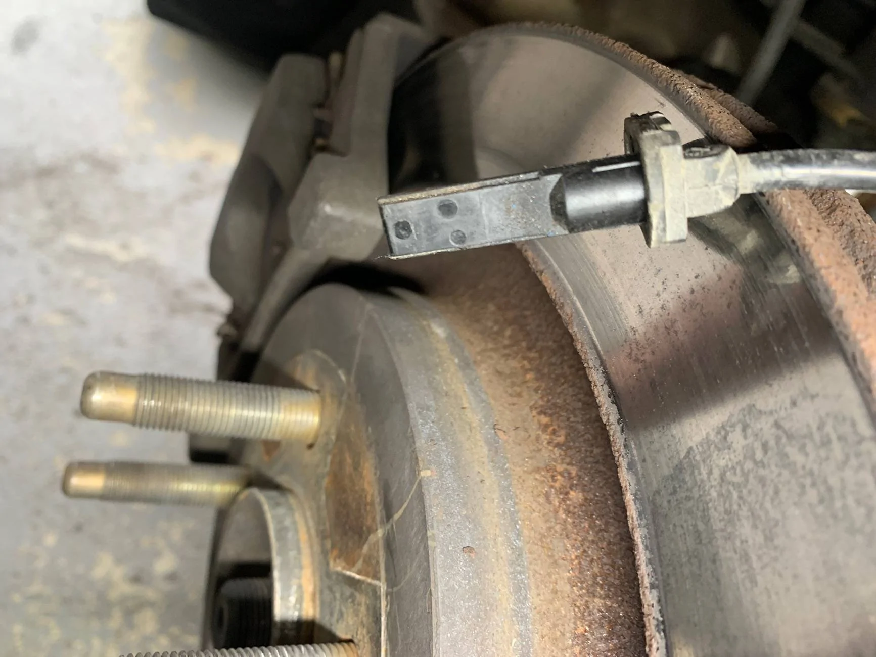

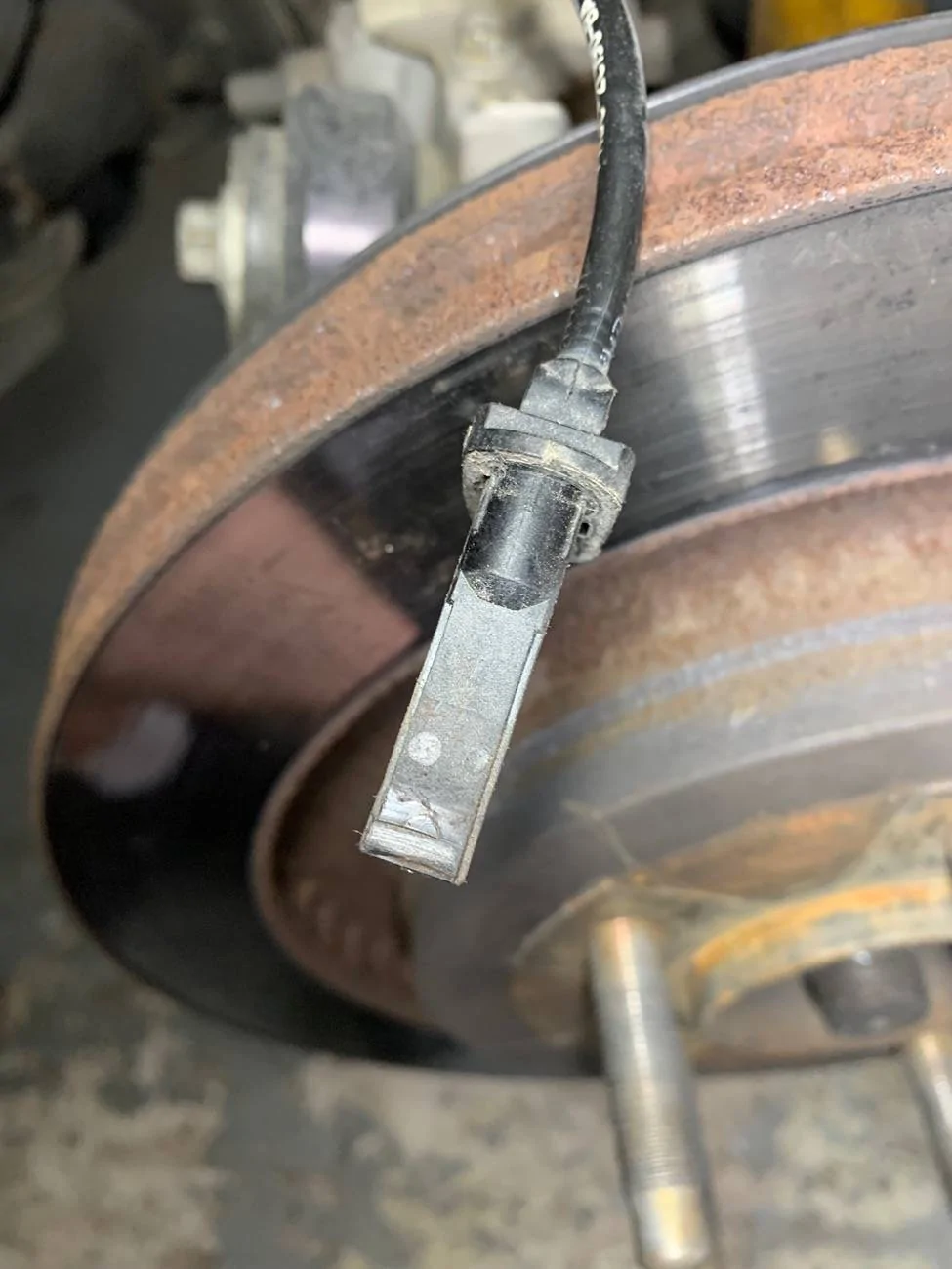

and then years later I thought I understood the failure mechanisms enough to use the washer again. (I now use red threadlock on the axle nut so it doesn’t loosen.) The washer walked itself off center and killed my ABS sensor ruining race By the way, losing abs and locking up tires mid turn is absolutely terrible.
Axle was/is still totally tight. F these washers. I’m never using them again.
photo is of good ABS sensor and one kissed by the axle washer.
