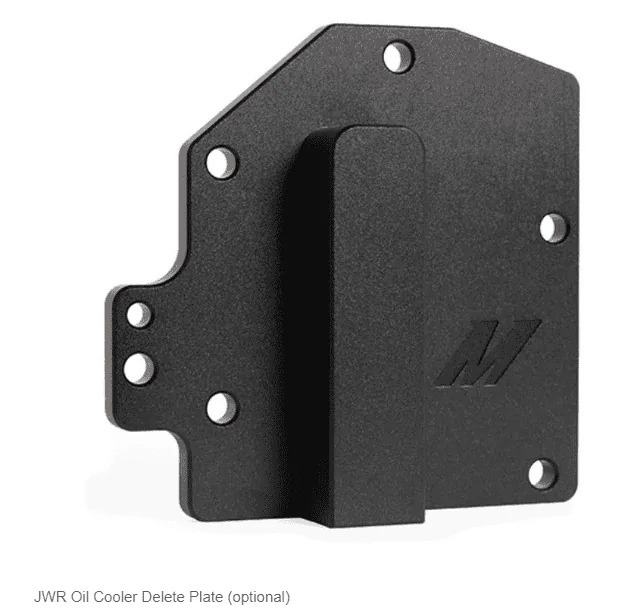

Had the Mishimoto plate and gauge delivered today. Made a video on my You Tube channel.
If you buy the plate, be sure to check the threaded plug in the base. Mine was literally finger tight!!

Guys.. I think this video will answer the question...
Don't forget to like and subscribe please...

just woke up after my pre Bathurst 1000km race snooze and er this video isnt great news lol. I'd maybe query the accuracy of that cheap gauge but i doubt it'd be out by that much unless it itself is suffering major heat soak. Mmmmm buggerations. I've checked the pics of my plate and it doesn't have any take off's on it so i can't even try replicate what you've done here. Weird thing is, where the heck is my oil filter now if i have the plate below fitted.. Whats the oil filter relocate item you have Nige?

Thank you, Sir! I think that this pretty much wraps it up for the oil heater that is in our cars. It is easy to see that this would help to bring up oil temperature faster on a cold start. After reaching normal operating temperature there could be some oil cooling available due to the difference between the oil and coolant temperature under normal driving conditions. But it seems unlikely to me that under track conditions that there would be that difference between the coolant and oil temps. This based on all of the posts in the threads about not being able to run but a couple of short sessions without having the nannie's step in and reduce power. Many have posted that coolant temps rise rapidly, therefore so must oil temps due not only to the added heat of high RPM operation, but also because of the decrease of the delta between the coolant and oil temperatures. This is all based on what i have read here and on other forums on this issue, not on any data that I have produced.
Good work! I believe that I would go with the aftermarket oil cooler choice in order to attempt to achieve lower oil temps and not take the chance of finding out that I have one of the 1 in 100.
Hi Buddy..
There is an M16 x1.5 threaded bung in the bottom of the plate. This is where I fitted my sender.
As you rightly say, the gauge could be out, but not by that much and, when tested in boiling water it actually read on the cold side. From looking through the internet, it would appear that 140° C is up near the top of a synthetic oils capabilities?
The remote filter i am getting is the MMR one that comes as a kit here https://www.ebay.co.uk/itm/17240366...rentrq:bd7096ec1830a825eed118c0fffc9e90|iid:1
Remember, to fit this you will need to remove the original casting that runs down the side of the engine which in turn means you will need spacers or a LHD left engine mount. If you need spacers made I can do that.
The replacement filter is around £12 on Amazon and being K&N we know it'll be good.

it seems unlikely to me that under track conditions that there would be that difference between the coolant and oil temps. This based on all of the posts in the threads about not being able to run but a couple of short sessions without having the nannie's step in and reduce power. Many have posted that coolant temps rise rapidly, therefore so must oil temps due not only to the added heat of high RPM operation, but also because of the decrease of the delta between the coolant and oil temperatures. This is all based on what I have read here and on other forums on this issue, not on any data that I have produced.
Exactly.. I found I was forever looking to see if I had any coolant or oil on the garage floor, now I have the peace of mind that it's gone I no longer need to worry.
I will do a product review when the new kit arrives and then an install video to boot.

Hi Buddy..
The remote filter i am getting is the MMR one that comes as a kit here https://www.ebay.co.uk/itm/172403666078?_trkparms=amclksrc=ITM&aid=111001&algo=REC.SEED&ao=1&asc=20160908105057&meid=f4107938cff54cbc934f3ea496fc582c&pid=100675&rk=1&rkt=15&sd=284986919665&itm=172403666078&pmt=0&noa=1&pg=2380057&_trksid=p2380057.c100675.m4236&_trkparms=pageci:11917c96-47ea-11ed-8335-aa9bab015cb1|parentrq:bd7096ec1830a825eed118c0fffc9e90|iid:1
Aha, that's good to know about the temp sensor plug, I'll need to get something sorted out to have a gauge in mine and confirm the results.
Does that temperature gauge alter all when the car is up to temperature? I wonder what folks are seeing temperature wise with the air coolers, obv that inferred display in the dash is completely out with the interwarmer removed!
Awesome details re the location kit I'll save that info. Time to speak to my car guy as I don't work on the car myself - no skilz.
