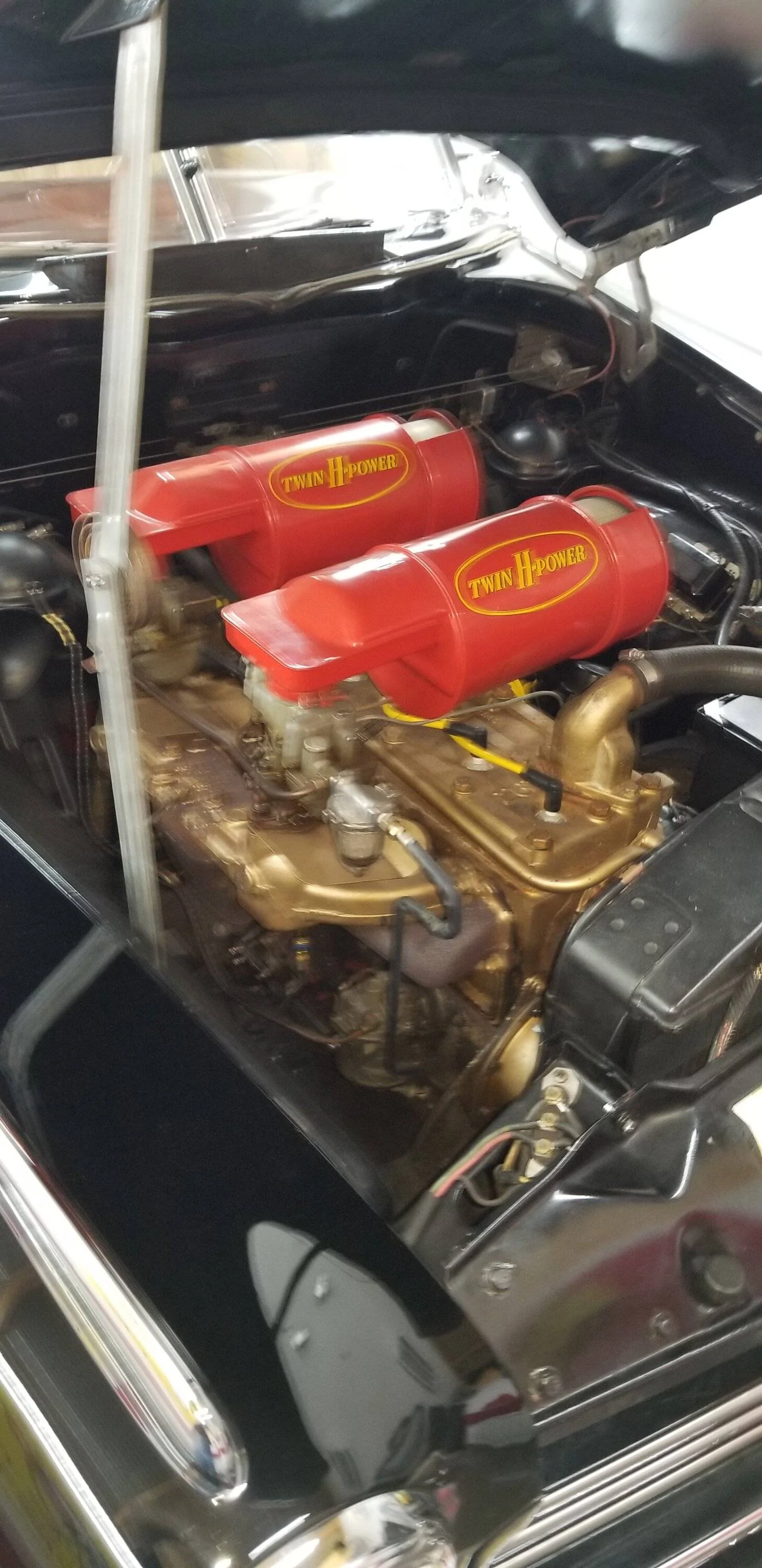

You memory must be suffering. I have a perfectly restored 49 Hudson.
Certainly not impossible, but I remember seeing some such factory setups back in the day. And in my defense I did say “many if not most”.
Just curious: what does your Hudson do for crankcase ventilation?
Road draft tube. In 49 all cars did it that way

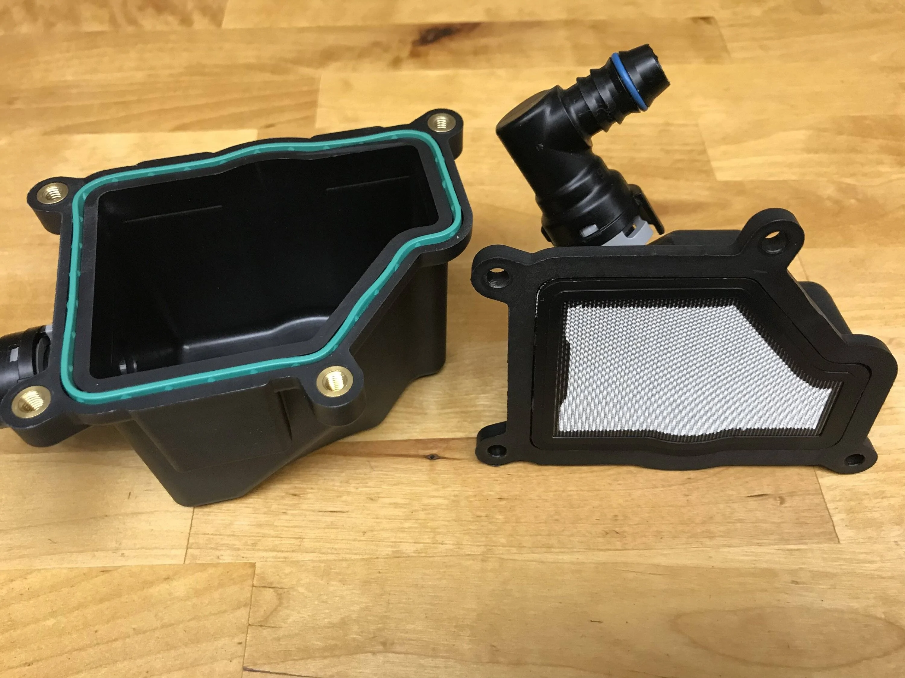

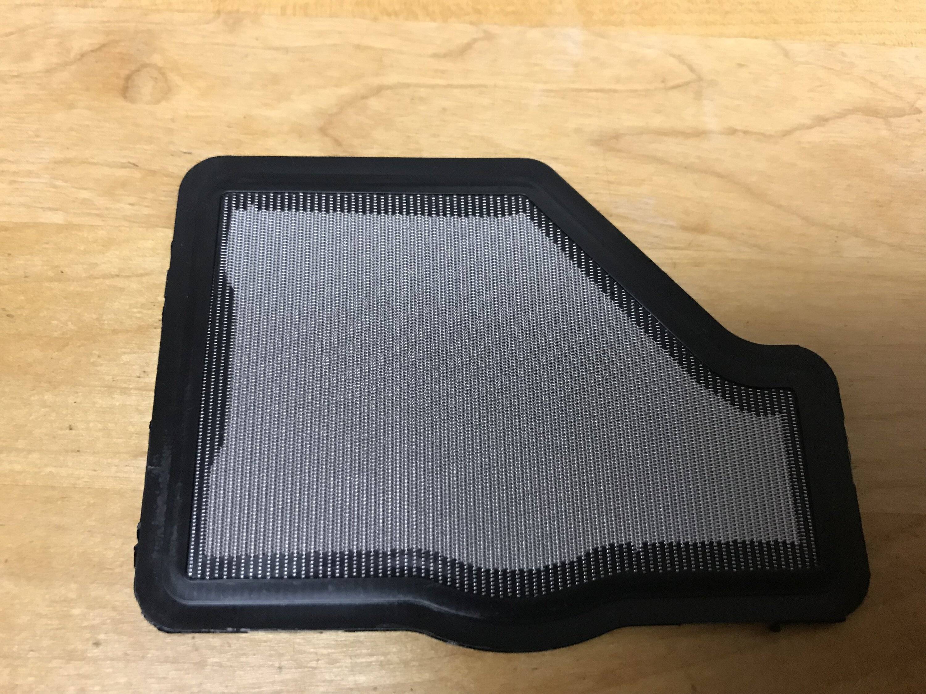

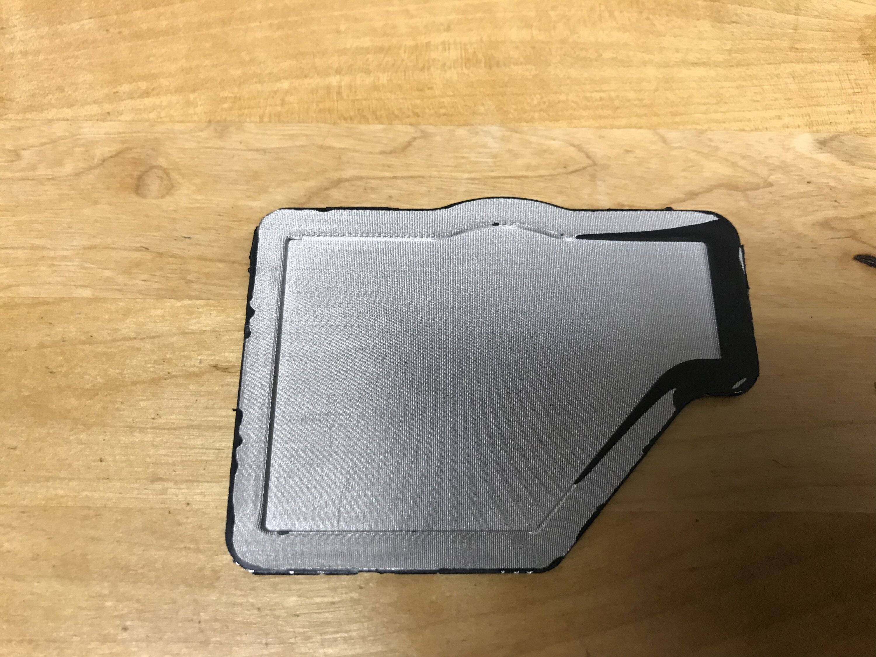

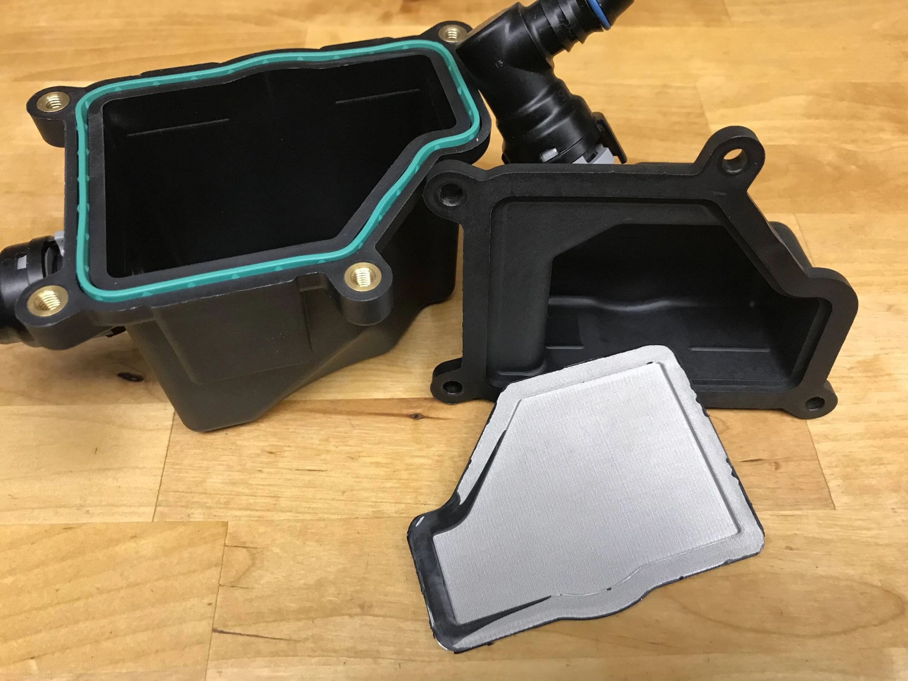

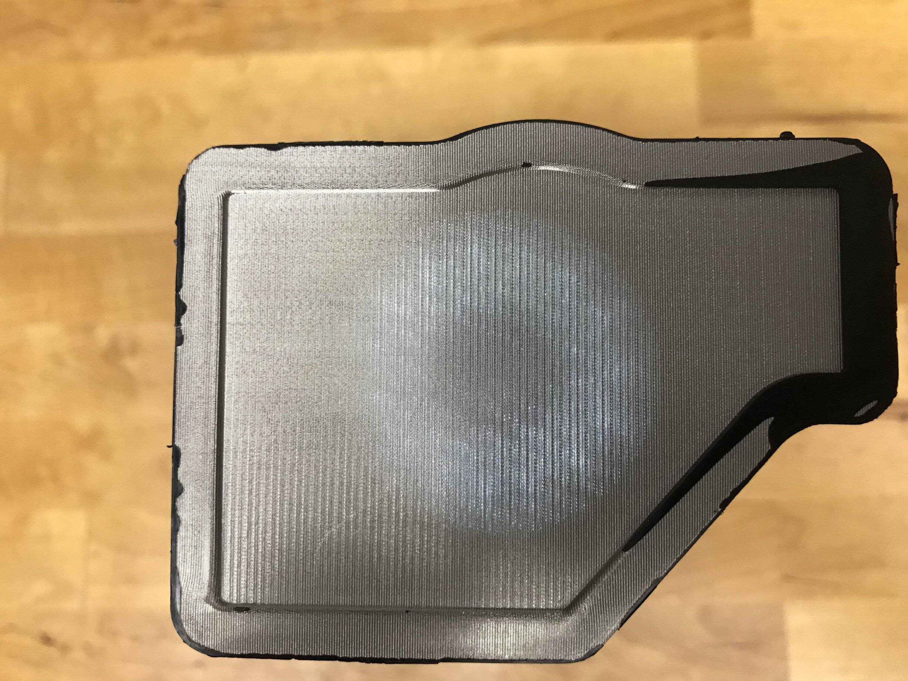

Even if it becomes full there will be no more than the normal amount of oil ingestion. Would have to ignore the catch can for like 10k miles to fill it though.
I run 10k OCI on the Ford Performance oil separator and I’ve never seen more than 1/3 full.
Lets say it did fill up, I don’t see the screen allowing enough oil flow to stop an increase in crankcase pressure.
Third picture is with M12 Milwaukee LED light.
I'm confused here buddy. What are we looking at here?

That is the Ford Performance oil catch can separator multilayered screen.
Looks like a small, slightly misshapen engine air filter. :cwl:
