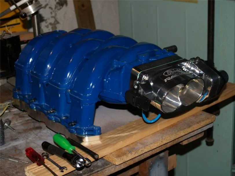

I run one on my 2007 GT. I empty it every 1500 miles. No one sold me.
I had the plenum on my work bench for mods. The oil drench on the
ducts freaked me out. IMO it was excessive. I used an air compressor
separator from GRAINGER. $17.95. It is all good with no cons.
It was also a good time to improve the appearance of the dull ABS plastic black.
