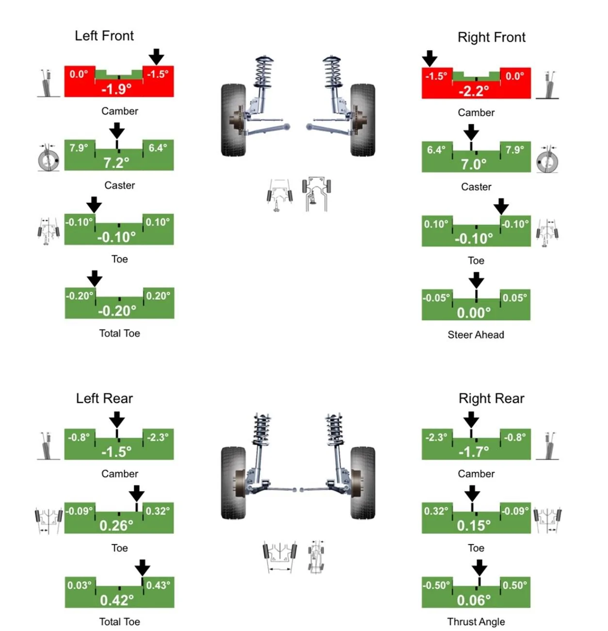

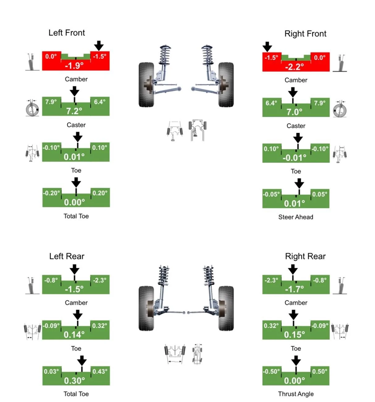

Hey, I fully built my suspension and the front has the minimum drop BMR springs while rear is stock. I had the car aligned and I’m not sure if I should consider camber bolts, I daily drive my car with some spirited driving at times, but have never tracked it. Not sure if it matters but it’s front 20x11 295/30/20 and rear 20x11 315/35/20
Before
After

Camber bolts would fix your camber
Is it necessary? Not necessarily, with this camber you will have more grip in agressive turns
If your fine driving on agressive camber, its totally fine
The tire will wear badly but slowly so its really not that big a deal
If you want it in spec, camber bolts or camber adjustable shock tophats will do the same

-2* camber is totally fine on the street
Camber do not significantly wear tires, toe, yes. Major
Shout for 0 toe

The only reason to get camber bolts or plates would to be able to get -2.2 on each side.
Shout for 0 toe
It wont add wear but it will wear the edge more than wear it evenly
But agreed the setup currently for alignment is fine for street, without fixing camber
Shout for 0 toe
Okay cool, I just bought the tires and the last ones had lots of outside tread and then cord showing on the inside. Maybe it was from toe on the alignment, I want to be able to avoid that this time. Can’t rotate the tires either since they’re stanced.
