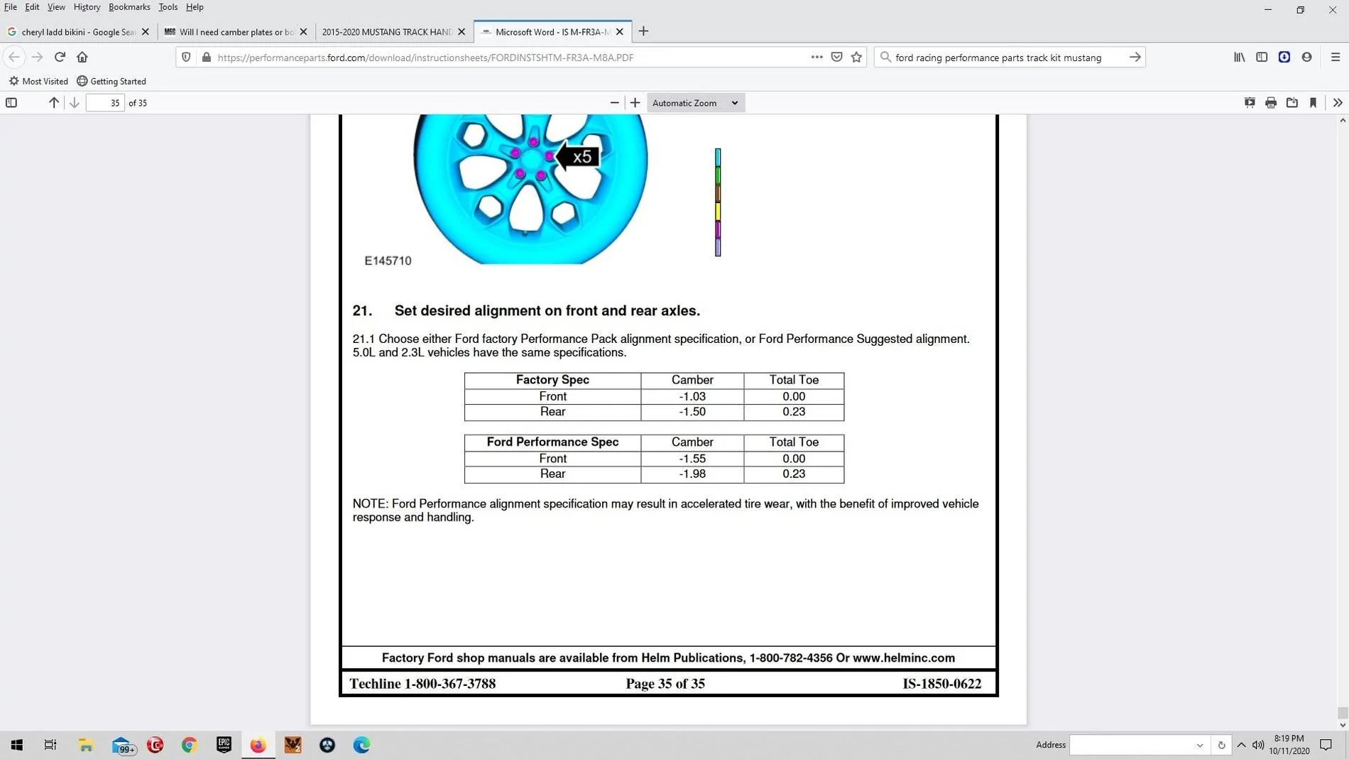

I am running the FRPP Track Kit and I was able to hit my alignment specs without plates or camber bolts. FRPP specs -1.5 front and -1.9 rear camber and my toe was to spec as well.

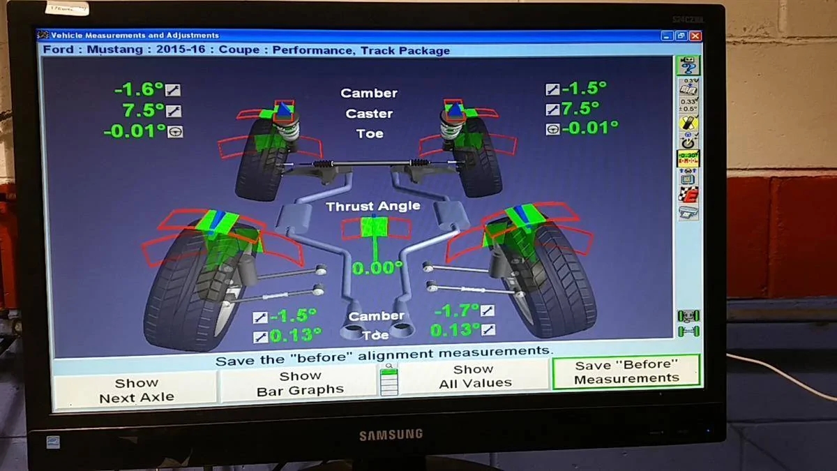

I have eibach sportline springs and front camber bolts ,20 inch wheel, did alignment this week and they dont have any problem to set it up
Planning to go and do some track day this week so ill see.

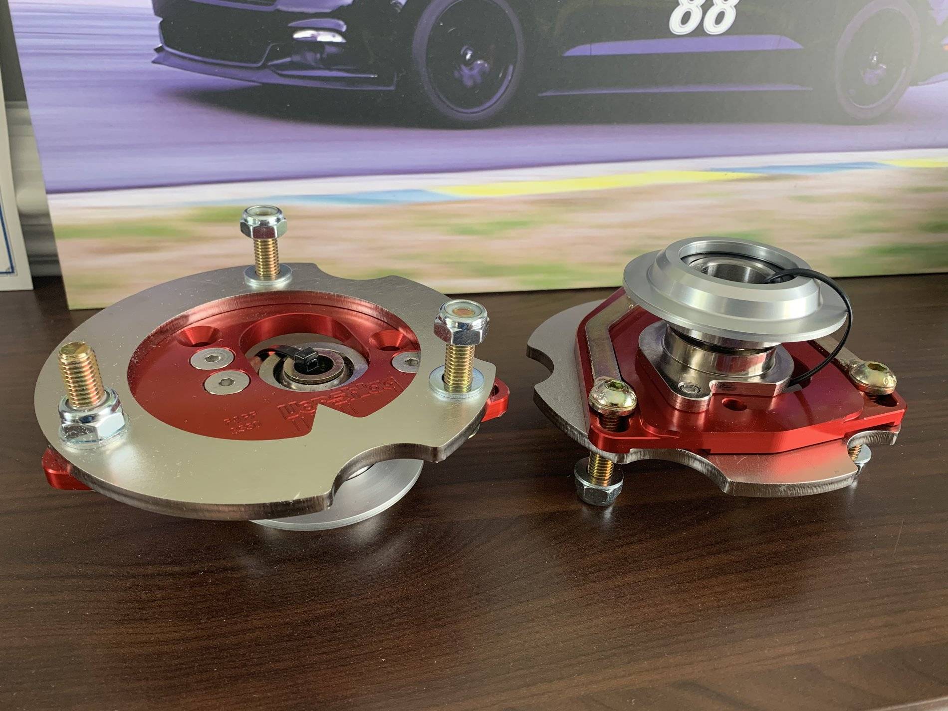

tj@steeda
Mar 21, 2014
589
6,965
4,465
Timothy
We have been pretty happy with the Steeda Camber Plates:
