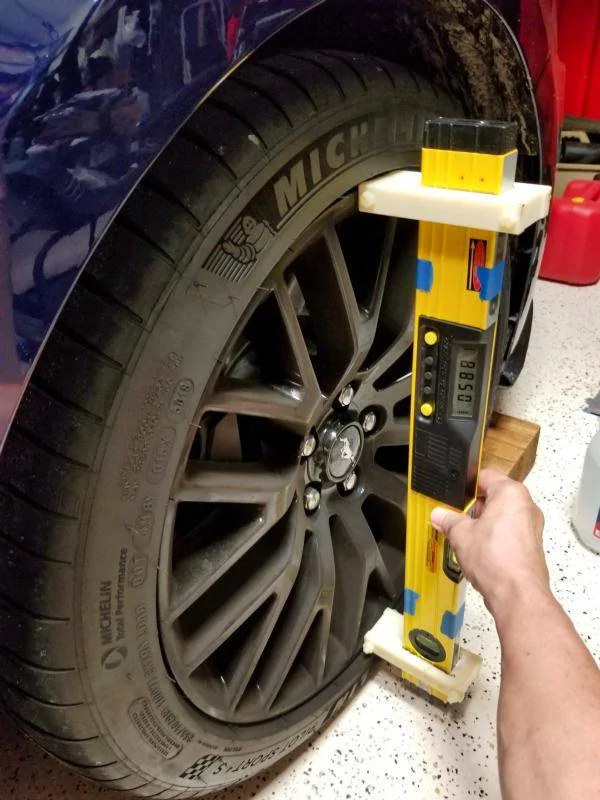

I agree, the numbers appear to be off. Mine measures -1.5 on both fronts, slightly less on the rears (by eyeball, haven't checked the rear with a level) . Mine tracks well and tire wear is even.

just go -1.5 to -2.3 front camber and "zero" toe, rear -1.2 to -1.7 w/ 0.1-0.13 toe in PER SIDE. Your car will impress. However you will need camber plates to get the bigger numbers up front.

for the OP, check your toe, its usually what makes the car darty on the highway. If its unusually darty under acceleration, then there are a couple other things to watch for.
for example, I just changed some parts out on my front suspension and my steering got really heavy, so I suspected my toe was too far toe in. Checked it with plates today and its about 2-3x what I want for front toe in. If it was extra light and darty, I would have expected too much toe out.
