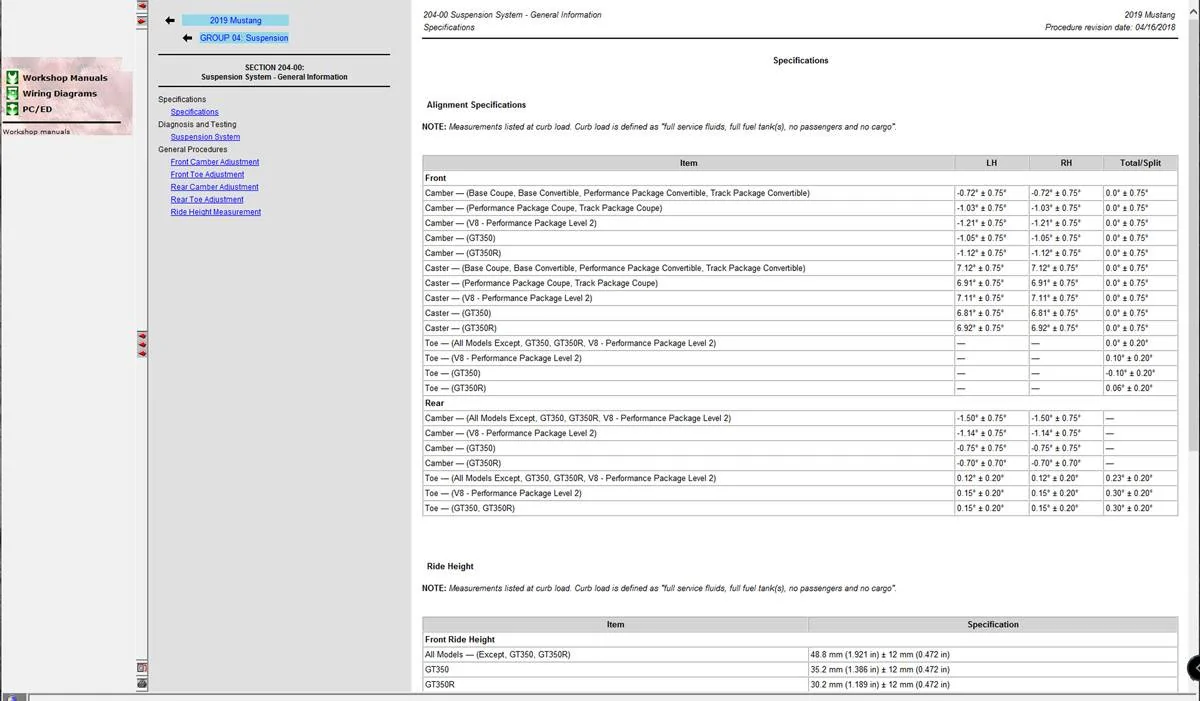

The 2019 service manual calls for -0.72 degrees base, -1.03 perf pack, all +/- 0.75. Toe is 0 +/- 0.2 degrees for all but GT350 and Perf Pack 2.
Specifying camber to two decimal places seems silly, not likely anyone can get it that close and it wouldn't matter anyway.
Twitchy could be from some toe out.
Do you know the setting sor front and rear for those different cars?
Except for a very few models, and that doesn’t include gt/pp1, that have camber plates, the camber is fixed and not adjustable without slotting/grinding holes, therefore Ford specs are a bad joke

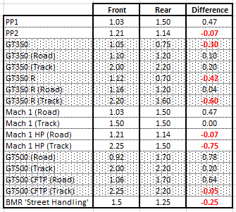

I'm not sure that info can be fully trusted.
My only data point is the 350 and the 350R, but the values shown in that table vary from what is printed in the owners supplement.
If we can trust the table and we eliminate the shelby variants with different hardware, yeah that's one of a few that flips the front / rear camber bias (along with the HP mach).
Its interesting to see that the higher performance NA variants do that, as its what BMR have been recommending for quite a while now :
BMR recommend 0.25 to 0.50 less camber on the rear than the front :like:
