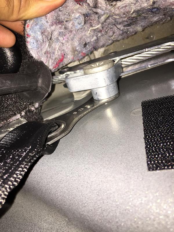

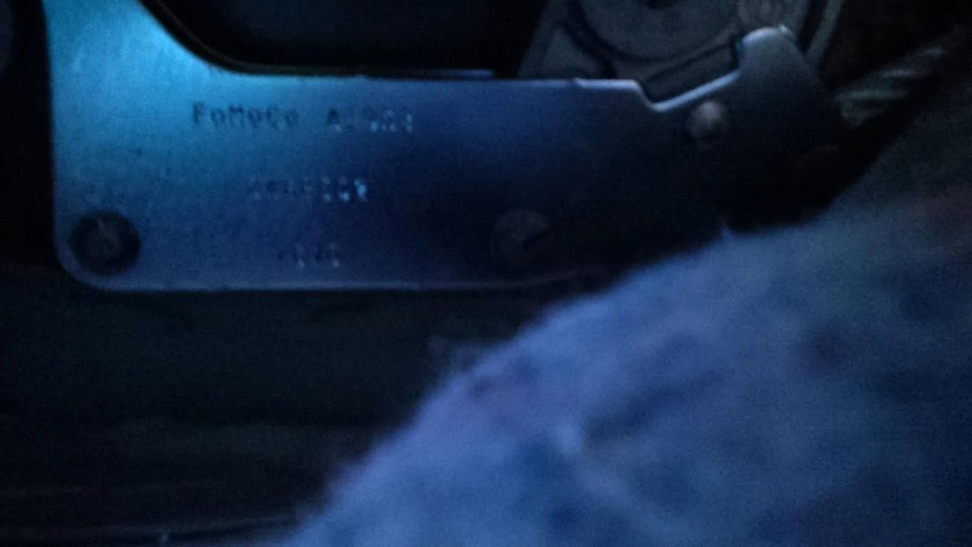

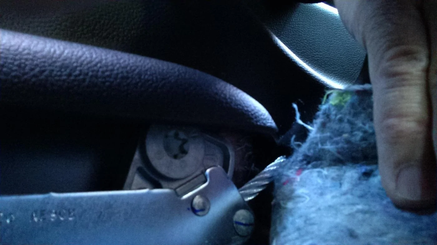

I started to install a set of Schroth QuickFit Pro harnesses in my 2017 GT350 and hit a snag. The stock shoulder harness does not attach directly to a Torx screw as shown in the directions. It ends as a cable that goes into (what I assume is) a seatbelt pretensioner. So, I stopped.
Has anyone installed these harnesses in conjunction with the pretensioner? If so, please describe which screw you used to attach the Schroth piece and any special precautions taken. A picture would be nice, too. Thanks.

I added a couple of pictures to my post above. What do you think? Is that thing under tension or going to explode? Or, can I use that T50? Thanks.

Your good man it's a tensioner in case of an accident. You'll Be fine. Did this on my ecoboost and on my Shelby

I installed the quick fit pro last week. Yes just take out front torq and put your bracket in. I did the back seat area slightly different. I attached to the existing seat belts in the rear vs the two child seats.
I had Schroth on the phone and they are about to update their instructions to support 6gen. They also set me a couple of pics and a short 44s vid to show what to do for the front connection you are questioning. That is the only difference between the 5th and 6th gen instructions. I will post up some pics.
I cant get the vid to upload - If anyone needs I can send

I just did this install last week in a 2016 (with some picture help from jabrax).
For the outside/front buckle, I had to remove the front bolt and loosen the back one on the pretensioner. After that, I was able to slide the bracket between the pretensioner and the frame. Then I used a little locktite, tightened them down, and finished them off with a torque wrench.
I had to bend the brackets to get them to fit right, but then it was no problem. Bending them is indicated in the schroth instructions, so that's fine to do, just don't do it repeatedly or too far.
