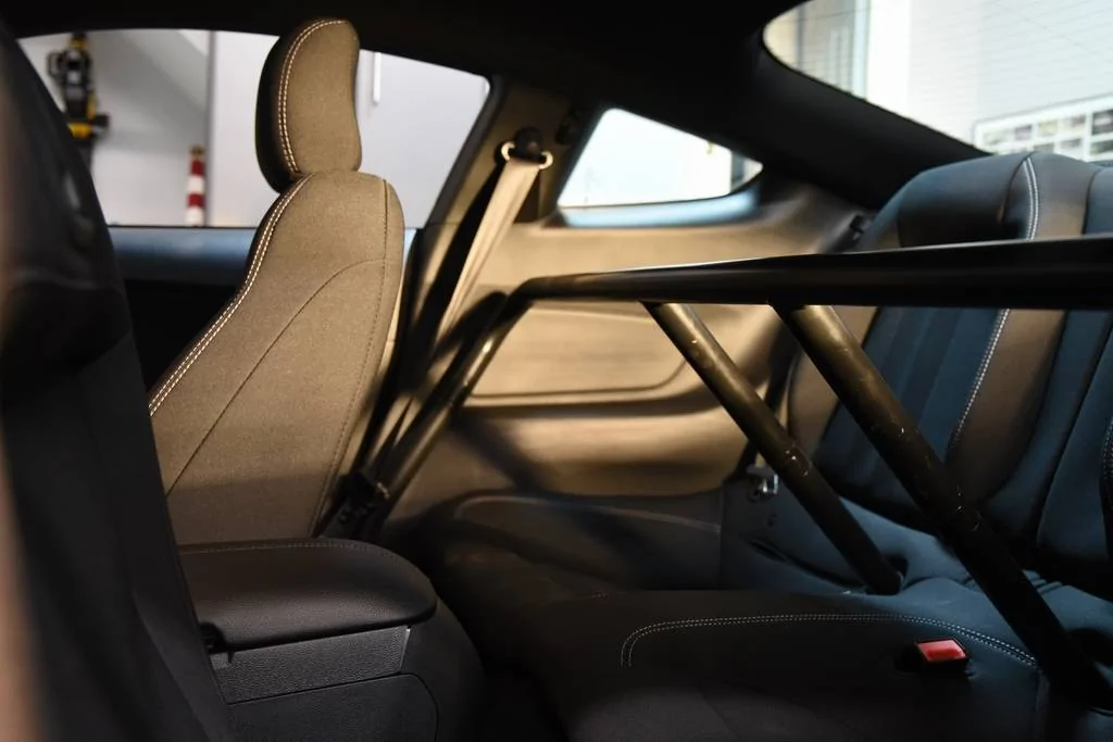

What I did was use the Braum harness bar ($299) which comes in five pieces... this makes it easier to install and remove, as you are not fighting with one huge piece which is difficult to get in the car and even more difficult to install. The Braum was not quite as easy as I had hoped. One thing is that it's designed for 2015-up Mustangs, but in 2018 (I believe) Ford changed the seatbelt mounts. So aside from the instructions being outdated, I had to do a little cutting of the plastic trim near the mounting points to make room for the bar in my 2020 GT. Part 2 was that nothing really lined-up right. We'll assume vagaries in production of both the car and the bar in addition to the installer (me) being an idiot , and so I used wood working clamps to help align the pieces to get it together. Hence all of the marks and blemishes on the otherwise lovely looking bars that they sent. The bar mounts in the outboard lower seat belt mounts for the front seats, and the child latch mounting points in the rear. No cutting of the seat was necessary, it uses the existing pass-thru.

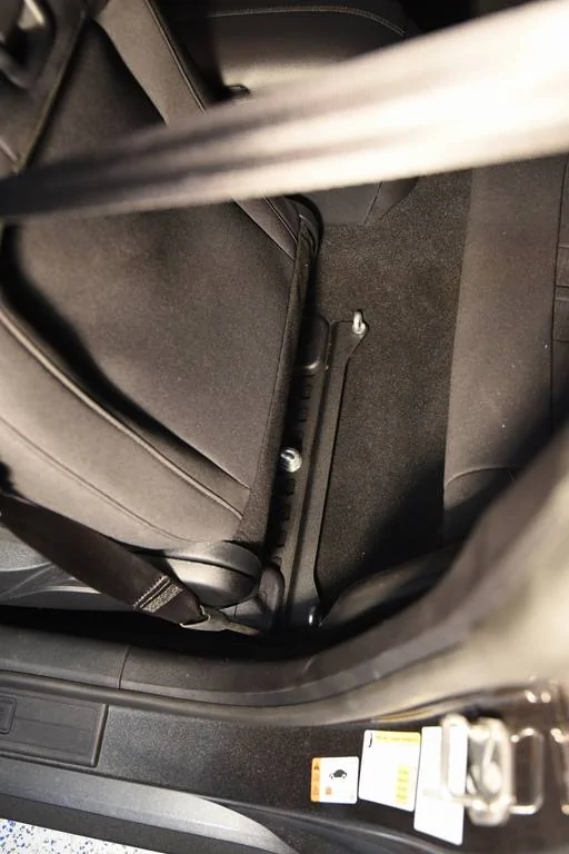

I bought the Watson Racing Harness Lap Belt Mount ($95) for the lower belts, which mounts in the existing seat mounting points. It came with two (of the three) mounting points loops shown. The third one, for the crotch belt, came with the harness but I did have to go buy some washers and a nut.
The harness itself was about $200. Lots of choices for those. You can spend more. Research certifications to determine what you want, and never buy a used one.

You may be held in place better but you as a driver in your car are actually less safe now with this harness bar. What happens if your car flips....now you are glued to your seat with no rollover protection above your head. If your car flips, your neck will take all the weight.
In a standard 3 point belt system, your body is free to move out of the way of a collapsing roof in the event of a rollover.
The likelihood of a rollover is probably fairly low but be aware that your car is definitely not safer now.
PS: I hope you're using a HANS device now with belts

Their is nothing harder than changing safety equipment for a dual use car. There will always be compromise. The famous Joe Marko from Schroth importer HMS motorsports on several occasions has told us the harness bar without rollover hoop protection and your neck getting broken in a rollover is a red herring.
I would check the harness bar height relative to your shoulder height. With today's harness material (rarely old school nylon belts) stretching less some kind of head neck restraint is mandatory IMO. This adds another 1" to shoulder height. Watch the angles of belt paths. Make sure to use the harness bar lock rings to control the belts sliding on the bar especially is using a Head Neck Restraint.
Check to see if the Watson lap bar is for lap and sub-strap? If it is lap anchor only then consider a schroth 4pt ASM belt setup. If you can mount a sub or weld more metal to reinforce if needed and add sub anchors do 2 sub anchors about 4" from the centerline and use a 6 point harness set-up parachute or climber style unless you have a seat with dedicated sub-hole. You can't use a 5pt without a dedicated subhole and anchor about 10 degrees back from your jewels. 5pt is passe. I would not recommend using it.
The 5pt gives better rollover protection and 6pt better anti-submarine and lock up of lap belts at the hip. That's why you see fast pro cars with 7pt points too but 6 is still the standard. A HANS type head neck restraint (HNR) is more comfortable and seems to work better with the 2" shoulder straps for driver manipulation/comfort but 3" is the standard and both are just as safe in crash tests. My favorite belt was the double shoulder belt HANS (4 shoulder belts) but now only NASCAR SFI certified and not FIA certified anymore. An SFI belt is legal for racing for 2 years and a FIA belt is good for 5 years. SFI HNR is certifed 2 years and FIA HNR certified forever. You will see cost differences depending on the certification on the same devices. If auto-x or HPDE I do not think anyone looks at these dates except maybe the ultimate rule followers...the Porsche club.

Yes, for the reasons above. Most HPDE instructors won't even get in a car that has a harness bar. Race car safety works as intended. Street car safety works as intended. Selected pieces from both do not work together too well.
Look, the likelihood of a rollover is low, yes I agree. I'm just saying don't kid yourself that you've made your car safer cause you haven't. You're held in place better, yes, but safer no.
If you want to be held in place but retain the street car safety, get the Schroth Quick Fit belts. They keep you in place but will break away during a crash and allow your body to move and work with the oem safety system as intended.
