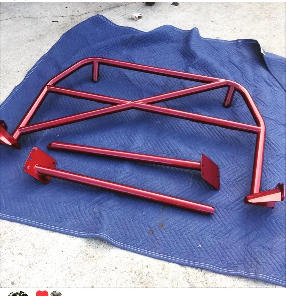

For those interested we just came out with our harness mount bar for the S550 Mustangs. This helps put the belts at a better angle and mounts them directly behind the driver. Here is a link to our sub forum for more info.

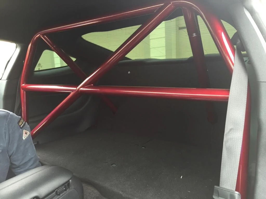

Got my harness bar in, now time for some good harnesses.

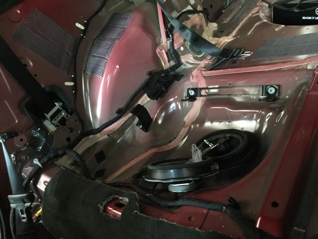

[MENTION=12448]pinero61[/MENTION] Looks great. Likely the route I will take if I decide to track the car more. Do you have any pics of the forward mounting points? Did you just cut the carpet to get to it?
Thanks.
pinero61
Dec 3, 2014
2,166
412
Houma, La
'15 Ruby Red Base GT PP
It bolts directly to the bulk head behind the seats using existing bolts. Seems to be a really strong mounting point.
