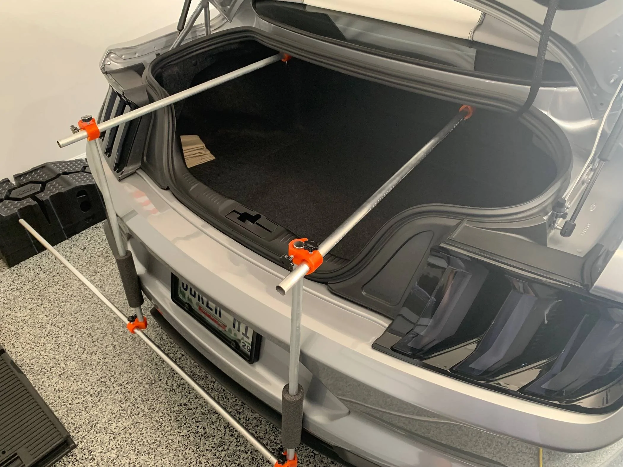

Its really hard to be angry at a nice little $70 string kit which comes with everything but the metal conduit tubing (which you can get at your local Lowes). It takes a couple second to setup, but the toe measurements were more accurate than the nice toe plate kit I bought.
The cheap kit easily beats the $240 Tenhulzen camber/caster/toe plates I also bought at reading toe accurately (but the plates are still my go-to for measuring camber.) The toe plates are definitely quicker to use.
Another vote for caliper garage. They’re actually on the forum here. But this one of many affordable options to build a square string around the car.
did you guys use 1/2” or 3/4” conduit…… 3/4” conduit doesn’t fit mine. I’m fine with 1/2” but wasn’t sure if a design change was made

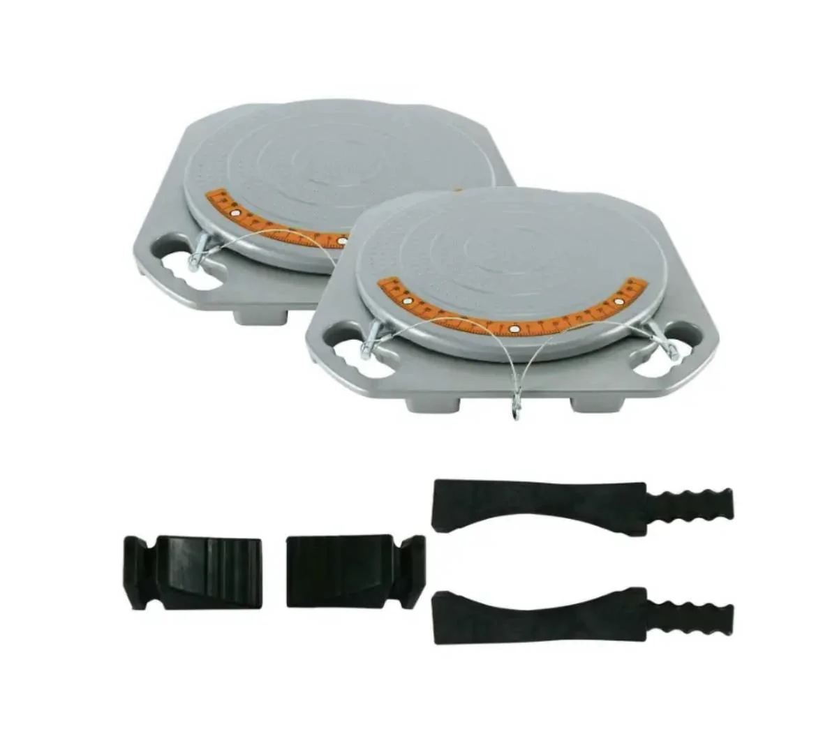

Surprised nobody has mentioned alignment turn plates. I found it a PITA binding up the suspension with adjustments, raising the car to release, then rolling back and forth to settle the suspension.
Got a set of these and they cut the time down dramatically on my German steeds. Have yet to try aligning the Shelby but I did check it when I bought it and it looked good to go.
After putting in a new rear bearing yesterday, I appreciate the info on the adjustable components. Will be getting those b/f rolling in on the rear.
I was looking at them but seen a lot of different ways to do it. People use Masonite, garbage bags or other plastic sheets. I even seen someone use some sheet metal n grease.
Yeah…I tried a thin steel plate grease sandwich and all it did was twist both plates and gall the finish on my lift runners (so it didn’t work for me on a finished/powdercoated surface; may work on raw concrete finish…YMMV).

I’ve tried everything. Garbage bags, tiles, tile against tile, tile on garbage bag, bla bla bla. None of them worked. None are near zero resistance enough to not bind the suspension and/or turn the steering wheel during adjustment. Once that happens, rolling the car to settle everything back down is the only way to get repeatable measurements. I bet those plates are nice and the only way to go. I do it the hard way; measure, adjust, settle the car, measure. It’s time consuming having to rezero your string box, but I get solid, repeatable numbers so I’m ok with it for now.

You guys that are using the caliper garage, how are you hooking up in the trunk area ?
EDIT: gonna hang it off the rear deck lid unless I come up with a better way before I do the alignment
