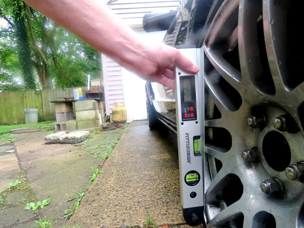

Having patience, an understanding of what you're trying to measure (and what setup things could affect that - like tire pressures and floor levelness), and a willingness to double-check every measurement is at least as important as the tools you use. Maybe more important.

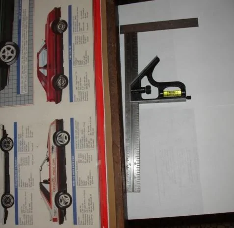

Even something as crude as this (and two strings set to be parallel on pairs of jackstands) can get you more than close enough for most purposes if you're willing to do the trig math.
But this is easier and somewhat less fussy.
