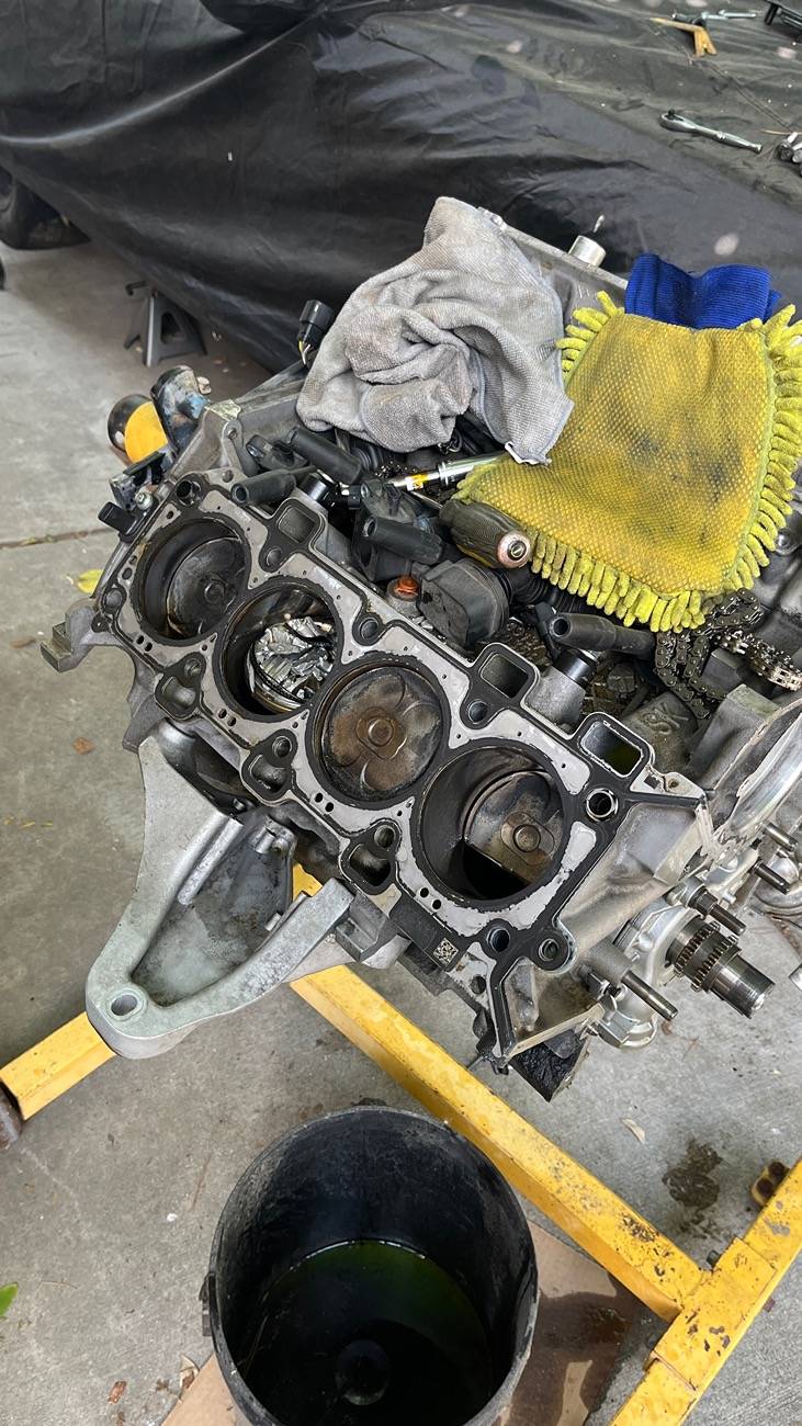

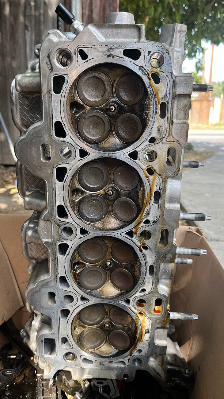

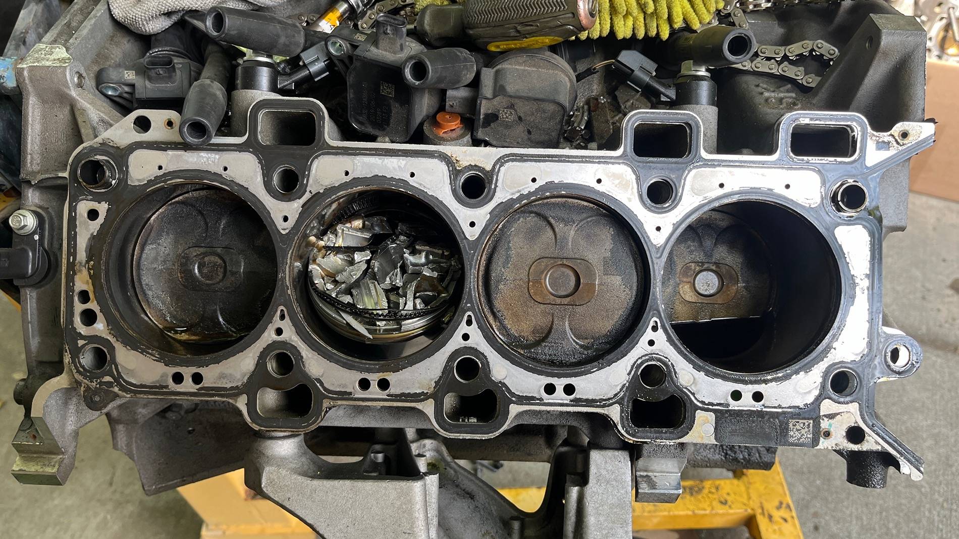

So damage report, the rod absolutely disintegrated lol good news is that the head is okay! Just need a built short block, rebuilt heads and we’re golden!
Jaymar
Jun 15, 2018
1,223
1,445
Portland, OR
Jaymar
2022 GT/CS - Rapid Red
That is the perfect balance of keeping the damage limited to one component and sending that shortblock with extreme authority! Well played sir!
