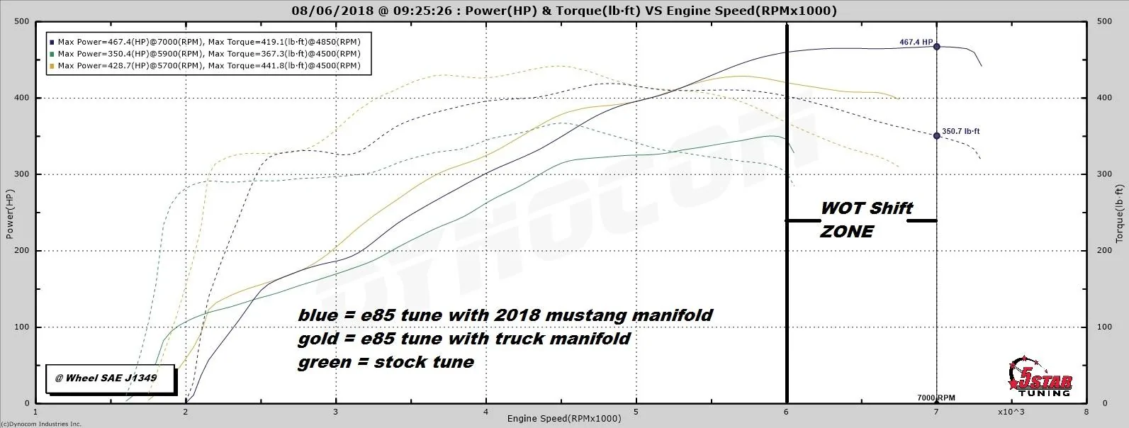

Because a gen 3 5.0L out of a F150 would be a direct swap, nearly 100% plug-in-play. Pull the blown engine, drop the new one in. Time wise, the blown engine had to be pulled regardless so it’s not like time is being saved and most importantly, costing around $4,000 with labor compared to $9,400. Plus, look at the numbers the gen 3 5.0L’s out of the F150s are pulling. A gen 2 5.0L out of a Mustang is never going to put down those kind of numbers with simply an E85 tune. Even if you kept the F150 manifold, it’s stil going to out perform the gen 2 with an E85 tune.
Now i dont knw much about gen 3 f150s but the gen 2 ones were missing some forged internals and had different cam phasers i believe. And with all the hubbalub about gen 3 motors blowing up from nothing id rather not take another chance.

are those dyno numbers from a 2018 F150 motor, or a mustang motor with the truck intake manifold? The 2018 F150's are only rated to 395 crank hp at 5750 rpm. The engines are not the same. Different compression ratios, different camshafts, different PCM, different intake and exhaust, and probably some other stuff
