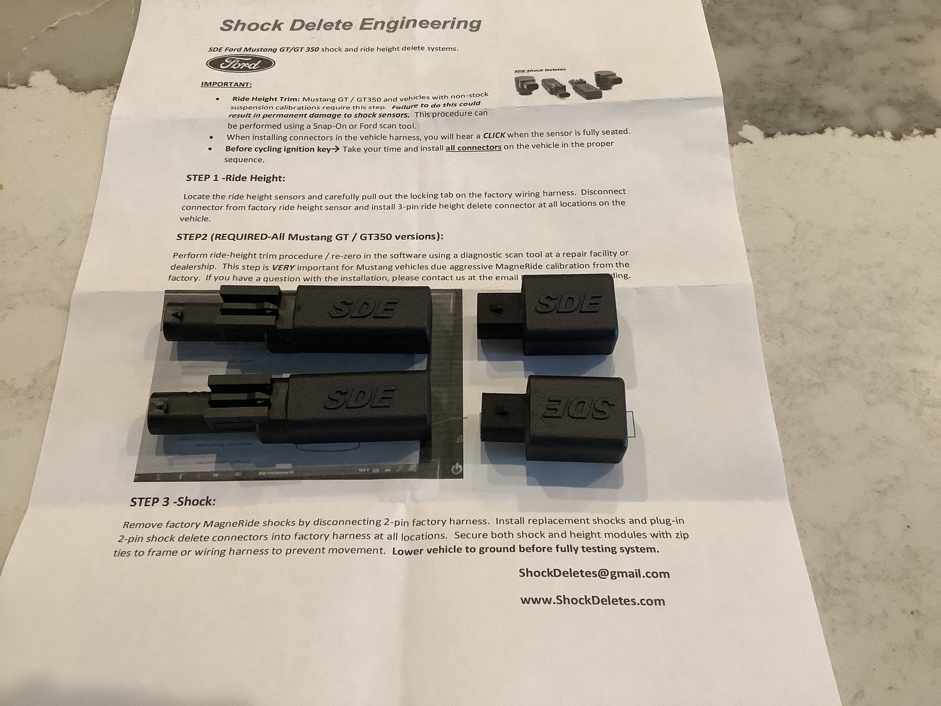

I can’t believe I missed this thread. I just ordered the SDE kit for the rear on my car in preparation for installing Viking drag shocks. Here are the ones I received.
@Mulletdaddee72, can you confirm if these are the updated SDE pieces.

Update: I just received this info. from SDE, so I’ll share here with others using their product. I’d still be interested in hearing from other end users on this if possible. Thanks.
SDE reply:
You should be okay without performing the ride height trim procedure. You can leave the OEM height sensors installed for now since the ride height is stock. We include the SDE height simulators for vehicles with coilovers and airbag suspension but you can always use them since they are lighter.
On vehicles with MagneRide suspension, the height sensors are the command input to the suspension controller so it controls how much current is sent to the 2-pin shock sims, which is why we recommend performing the trim procedure.

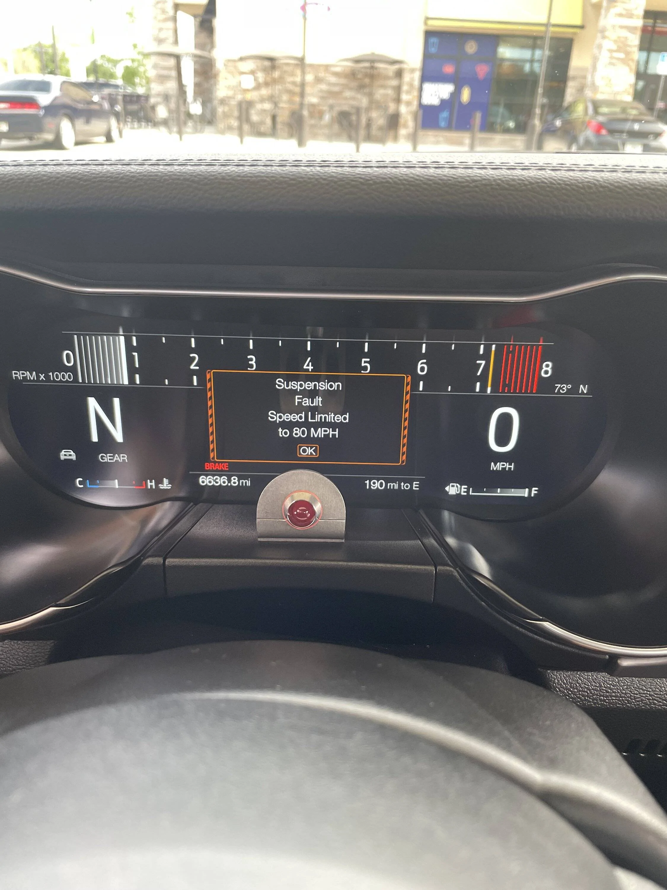

Well, I took my Bullitt out for a test drive this morning with the new KellTrack Ultra Spec Inverted Viking shocks and SDE sensors installed and low and behold, here’s what I was greeted with.
This occurred with only the shock sensors installed, just as it did with @rabid_josh. I’m going to try disconnecting the nanny plug here shortly and go for another test drive. I’ll report back with the results of that test shortly.
