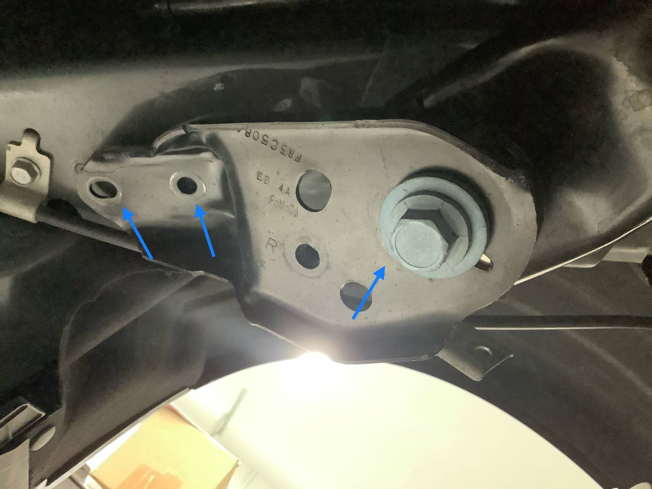

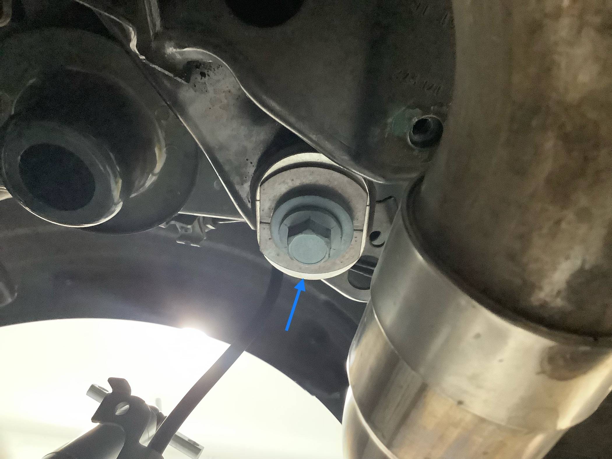

You are working with the blue subframe bolts and the bracket. Both brackets need to come off. If you only have one jack then on one side lower the blue bolts as far as you can leaving about a 1/4” threaded in then lower the jack. Now go the other side and support it with the jack and completely remove those bolts and slowly lower the jack all the way. If you’ve removed the upper shock bolts and brake lines of your choice then with a little pressure pulling down on the control arm the springs should come out with no issues. And yes you will need an alignment after.

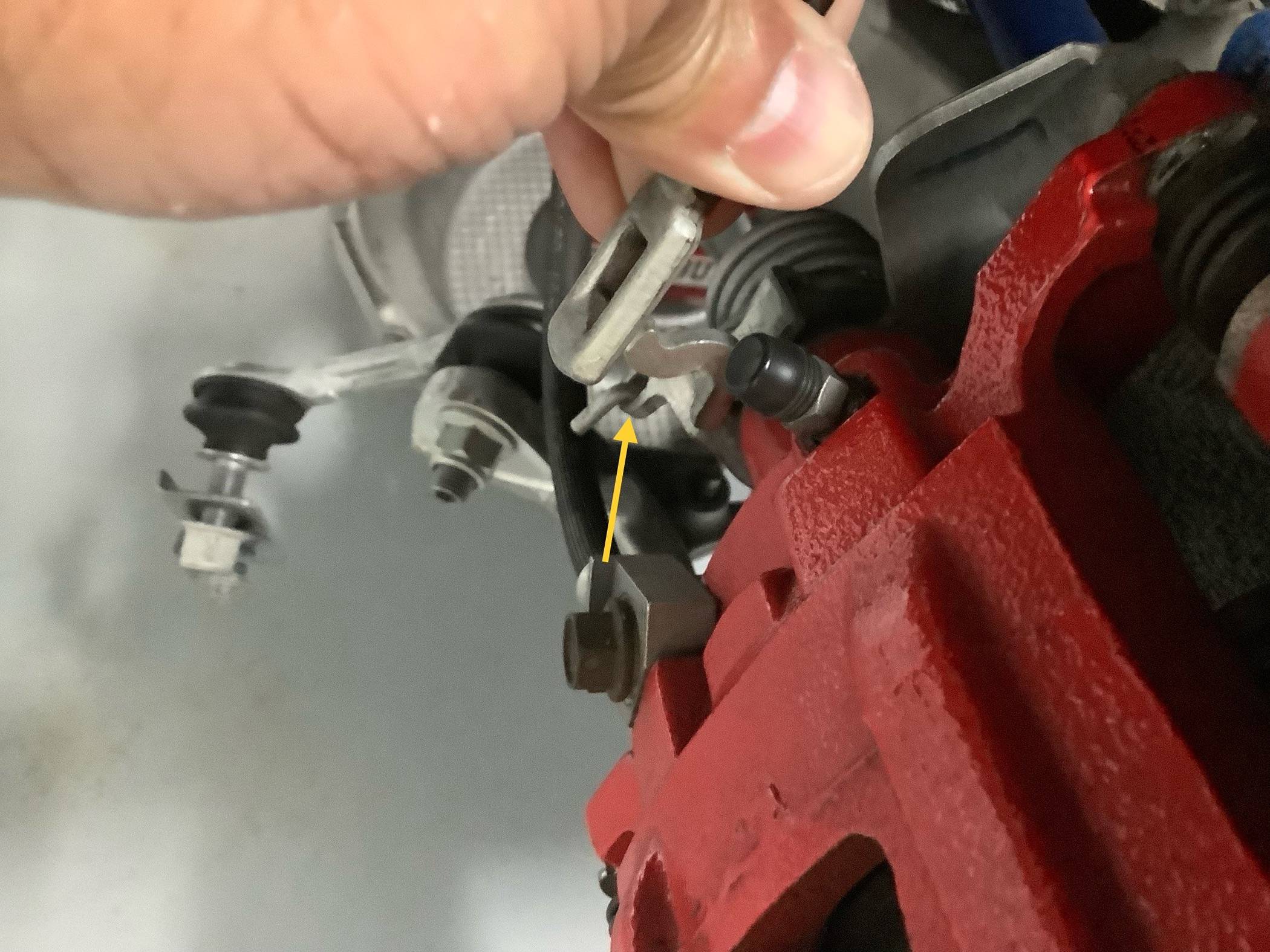

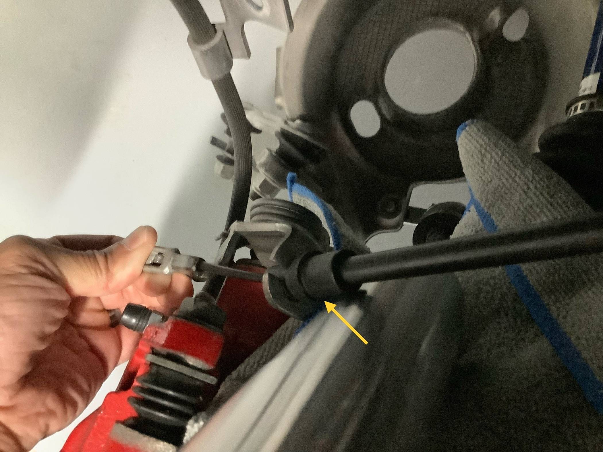

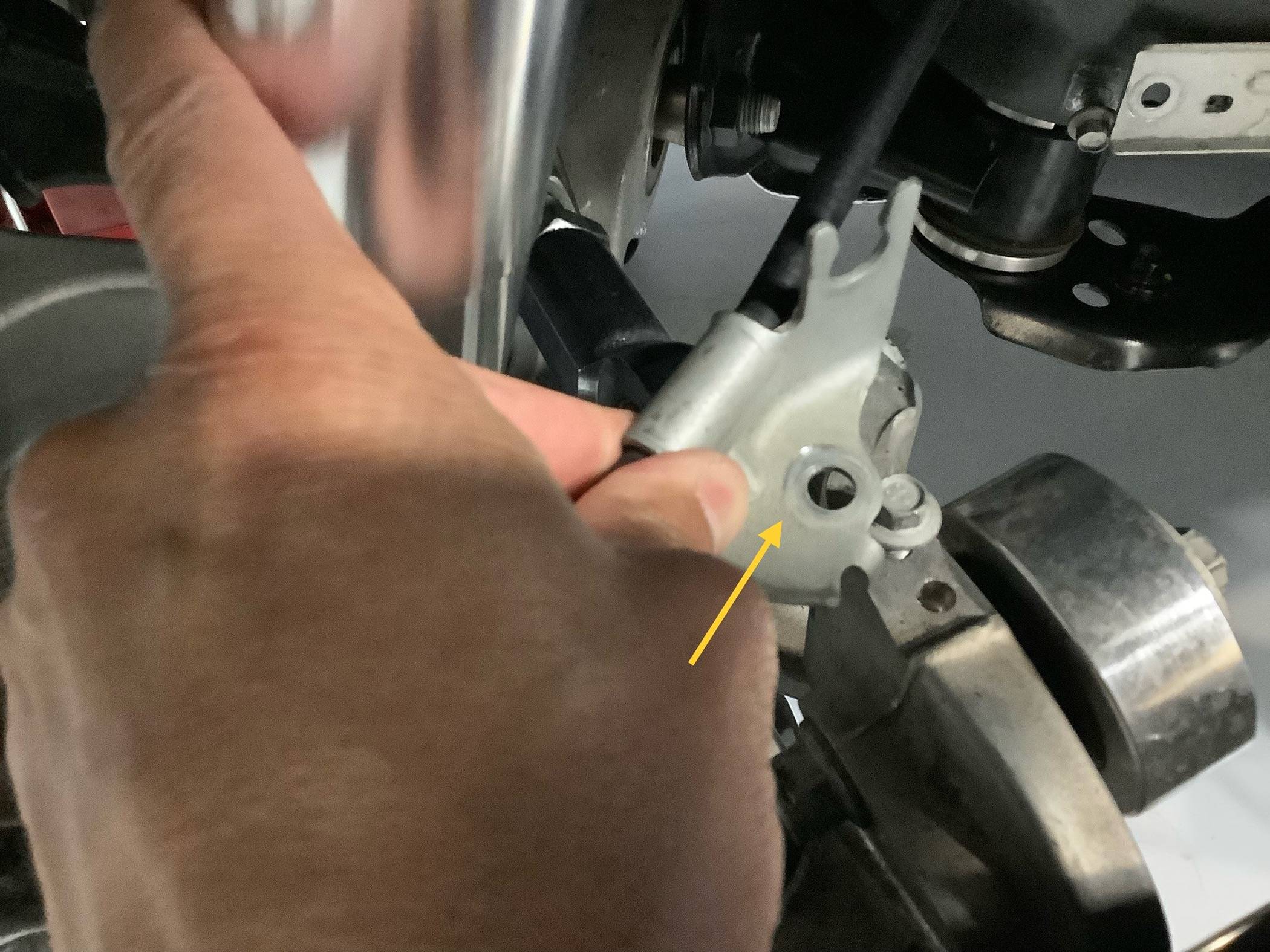

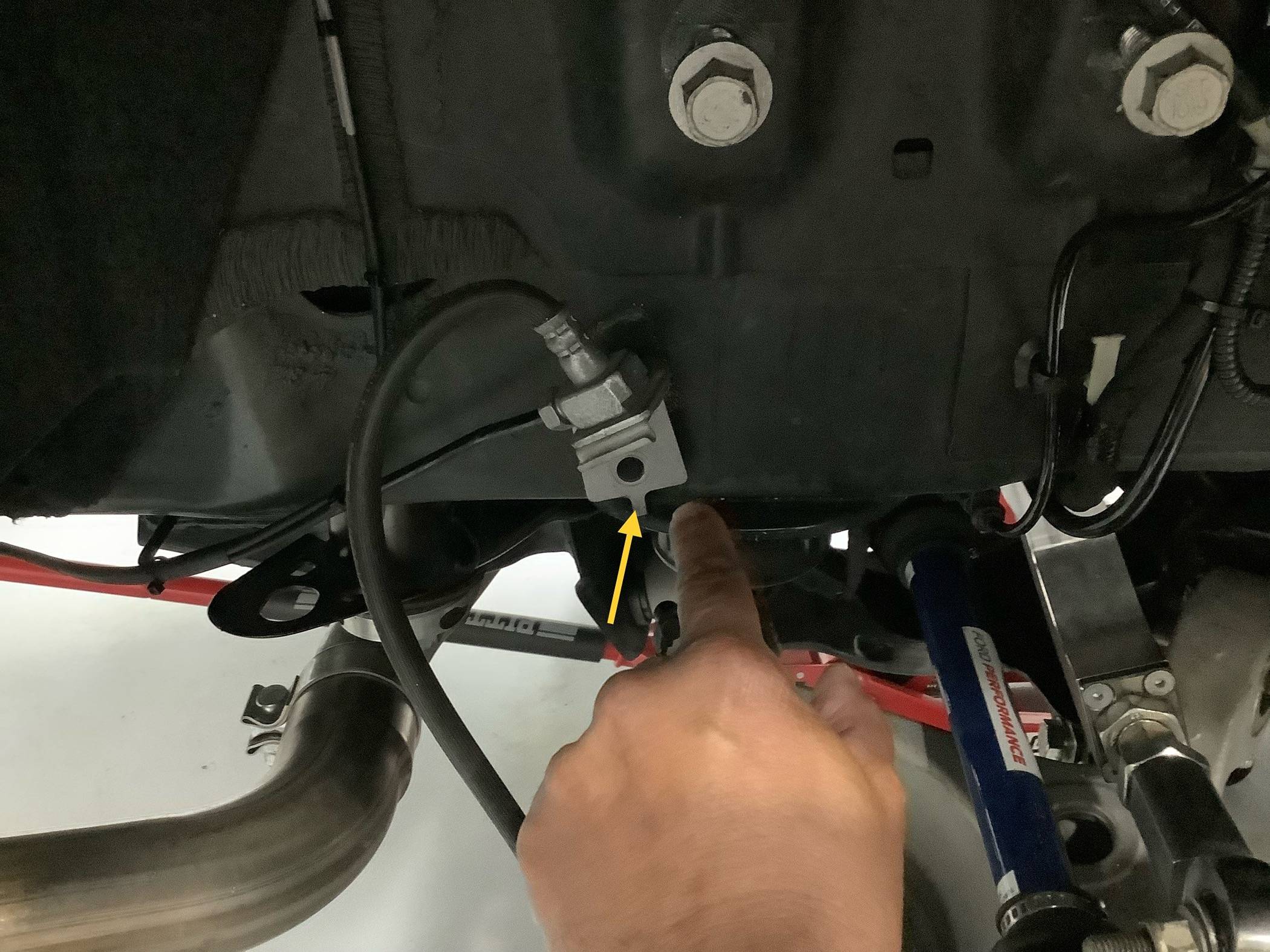

Okay, I’ll try and break this down a little further in steps.

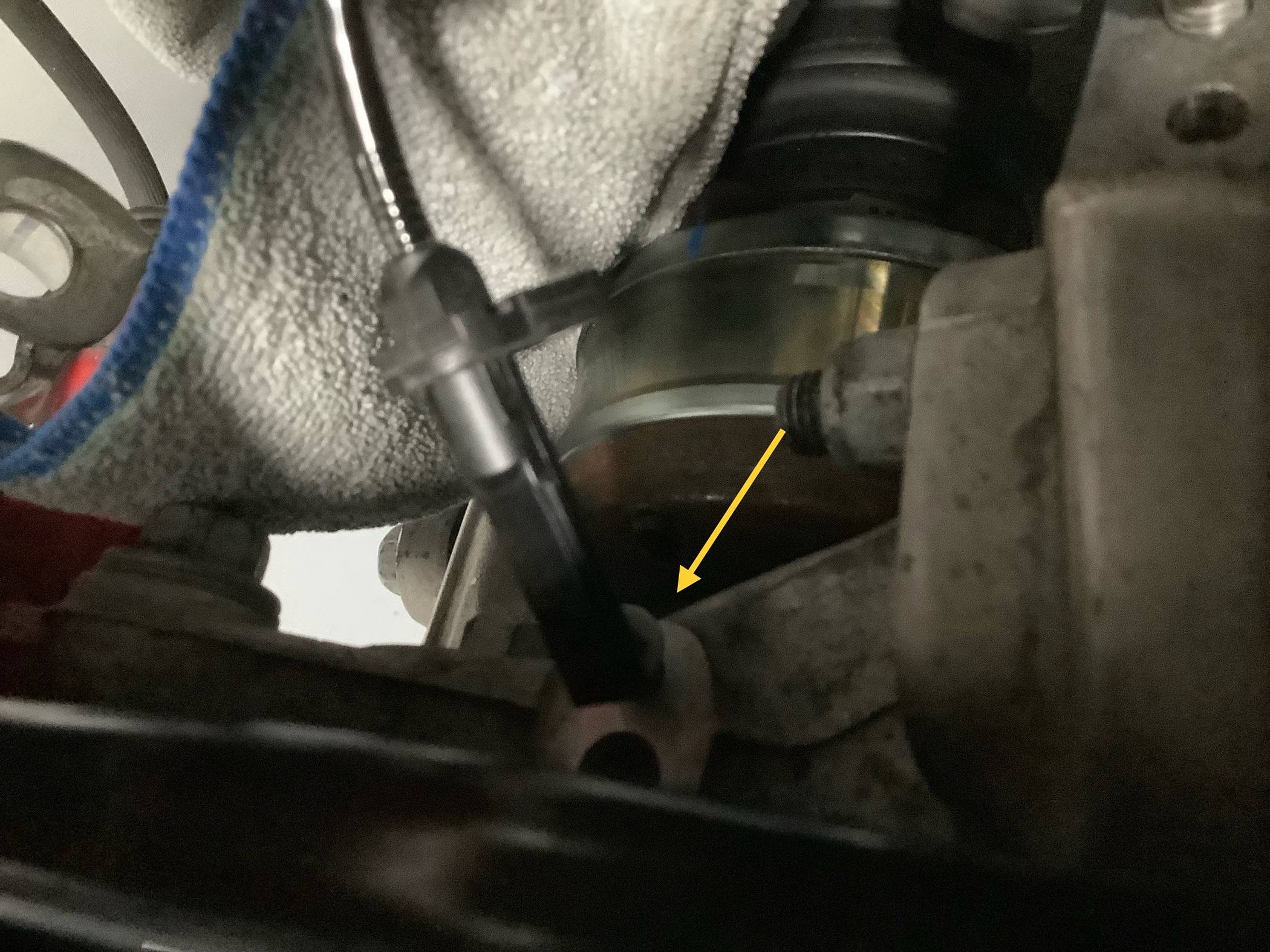

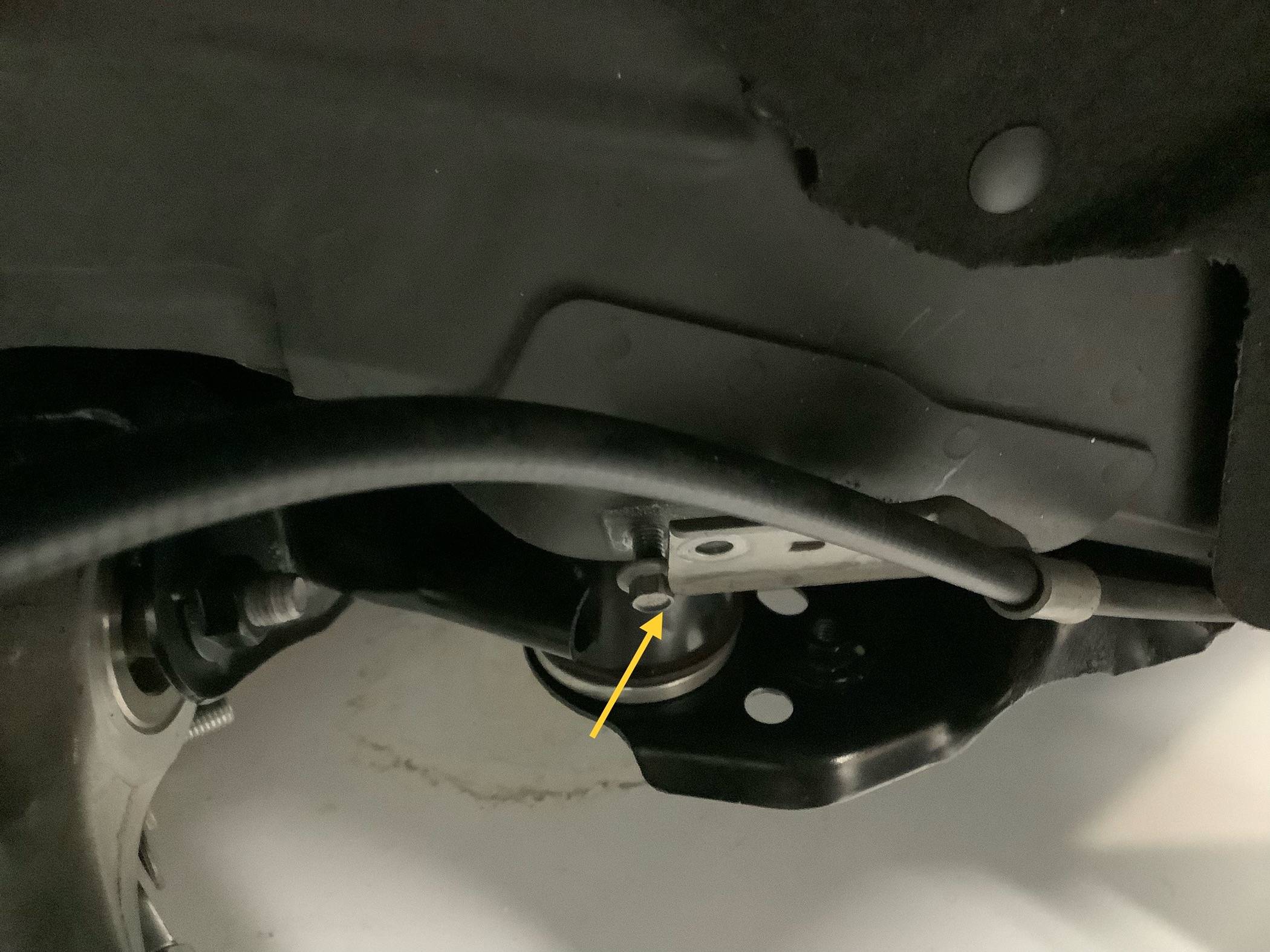

Step 1 - Remove the bolts holding the parking brake to the inner body and top of the control arm knuckle. Unbolt the brake line bracket as well.
Step 2 - Remove the parking brake cable from the caliper by grabbing the black plastic piece that’s a few inches back. press the tabs on the black piece and pull back on the cable and then lift it out of the hole in the bracket as shown and then unclip the cable from the hook on the caliper bracket.
Step 3 - Unbolt and remove the ABS sensor as shown.
Step 4 - Remove all bolts holding the cradle to the body.
Note: repeat these steps on both sides before lowering the cradle.

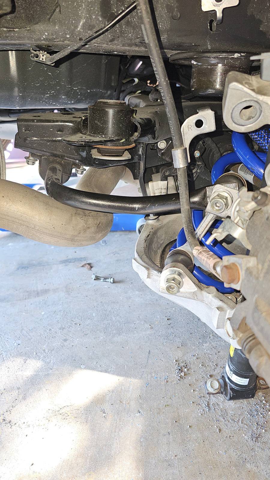

Anyone have any advice for the sway bar hitting the exhaust? I undid the other side to a few threads but it can't go much lower because of the exhaust. I've undone the bolts on the hangers which let it fall a bit, but not enough.
**Sway bar bolts are loose from where I started to remove it**
