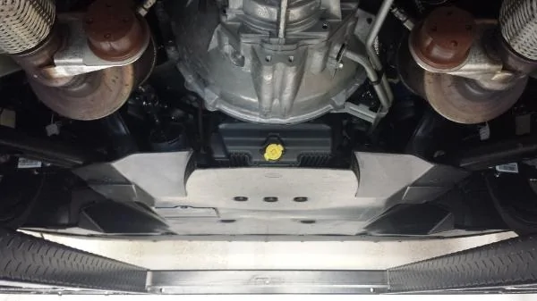

Anyone know if this bar gets in the way of the oil stream when removing the oil drain plug? I know how the oil likes to shoot out and I am wondering if there is going to be an additional mess I need to account for if I decide to install this thing.

It mounts several inches aft of the oil drain plug. So no interference or oil contact at all.

i had to take my brace off as the shelby trans scoop does not work with the brace.
The difference in just tramlining between brace and no brace is significant.
I may end up making a modified version of this brace that works with the shelby trans scoop, or I may just break down and buy a track pack trans sooner than i was going to, so I can put the brace back on. I miss it.

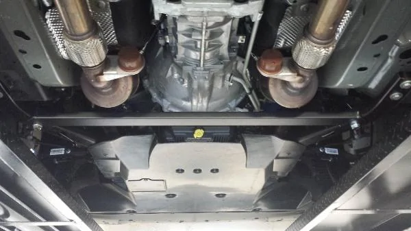

Got it installed today. The "knockouts" in the holes were still slightly attached both top and bottom. Rocked them back and forth (screwdriver and punch) a couple of times to break them loose and used a magnet to remove. Steeda only provides 2 washers so I added 2 more at the top side and blue locktite on the threads. Easy Peasy. Started to rain so I didn't go test drive.

Looks good! I have the same thing. You'll notice the car is harder to upset in turns, especially if you F up braking which I end up doing as I over concentrate on trying to heal toe with this pedal configuration. At least that's how things pan out for me.
I had the same problem with the slags of metal. As far as the washers I left it with the two. I was debating about the locktite, just torqued it to 60 ft lb.
