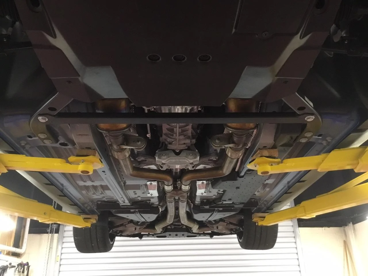

This install was extremely easy. It almost took longer to get the car on the lift than it did to do the actual install. I was finished in less than 30 minutes and that included putting the car on the lift.
Once the car is in the air and property supported, you will need to remove small pieces of metal slag from the subframe where the Steeda G-Trac brace actually attaches. These pieces are waste / left over from the stamping process when the subfarme was produced. Mine had two per side on the inside of the subframe from both the top and the bottom. The included instructions suggested using a chisel or file to remove them. I was able to get them out with a common screwdriver, my fingers and a magnet.
At this point you will be able to slide the included spacer into a hole in the subframe just ahead of where the brace will attach. The folks at Steeda were smart enough to attach a bit of stiff wire to the spacers to help you align them where they need to go without any fuss. You will do this on both sides.
At this point the Steeda G-Trac brace simply bolts in. Since I was using a lift and able to stand upright under the car, I used my head to hold the brace up while I installed the nuts and bolts on both sides. Although probably not necessary (not listed in the directions), I tightened each side progressively alternating between sides of the car before finally torqueing the fasteners to 60 ft-lbs. My thought process was that the brace would self align itself in the subframe.
At this point you remove the stiff wire from both of the spacers in the subframe and you are finished with the install.

I just got done putting the brace on my car.
On my car the holes were not punched clean through and each hole had a tab stuck to it. It was a little tricky to get them out with just the front wheels up in the air.
I would use a washer beneath the head of the bolt (only one for the nut is included) or the head digs in to the bracket material itself. Better yet, go buy a flange head bolt 14 by 2mm pitch to replace the bolt provided. I bought one that was 10mm shorter and its j-u-s-t long enough, one more thread would have been ideal, but its not going anywhere.
I'm not sure what effect this piece will have, but it certainly looks like it triangulates things very nicely and that Ford intended one of these to be installed.
I have more camber than stock, so yes, on certain roads the car is trying to kill me.
