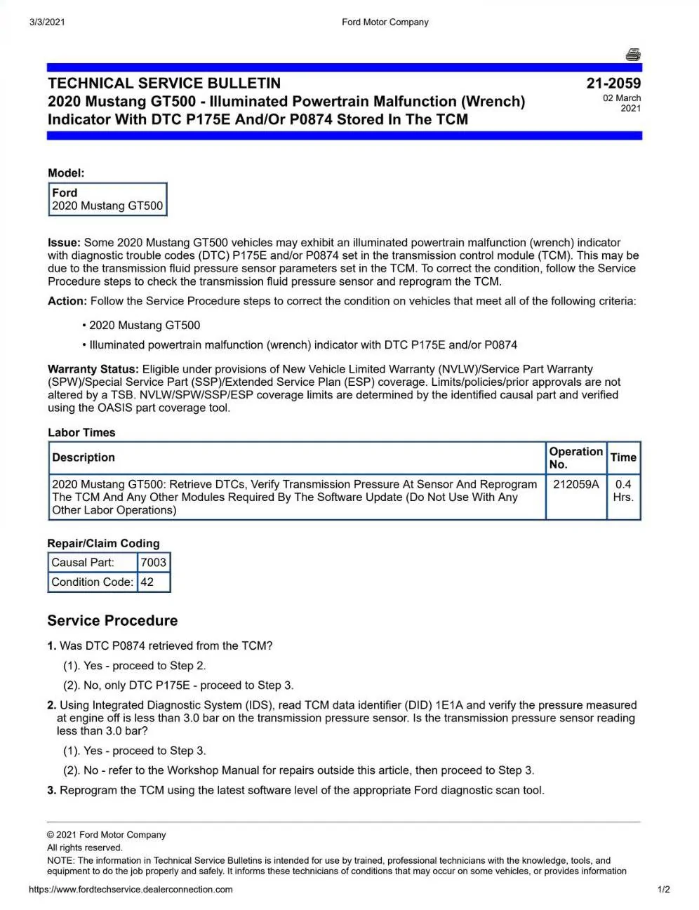

Jan 13 2021 1534 - 2020 Mustang GT500 - Various Transmission Related Concerns And/Or Diagnostic Trouble Codes (DTCs)
Some 2020 Mustang GT500 vehicles may exhibit various transmission related concerns and/or DTCs. In addition to following normal Workshop Manual (WSM) diagnostics, inspect C105, an inline connector next to the right side valve cover, for signs of pushed out terminals, terminal damage, or harness damage. If any pushed out terminals, terminal damage, or harness damage is found, repair as necessary.
