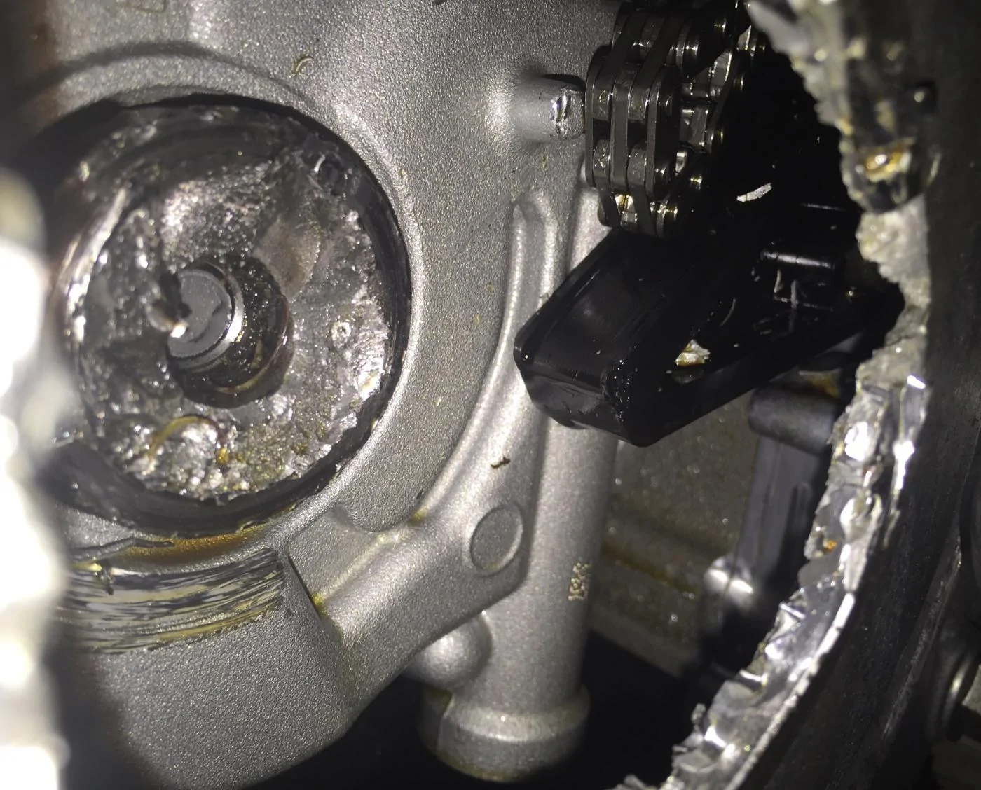

Crankshaft snout snapped

in all honesty my best guess on a Paxton or Vortech it would be a balancer that wasn't torque properly or put in properly
We have a new install tool that we're using now that we also sell that helps alleviate that problem
that really is the only thing I can see causing the issue
What's the tool do exactly? Help keep everything aligned when tightening down? Is it on yalls site? I can pass it to my shop.

Did it break right where the threads end?
Pretty much, some of the bolt was sticking out when we put it through the balancer. I'm not sure what broke first, no way of really knowing. If the snout snapped then the bolt would definitely go too.

Is the bolt bent at all? If not, then I would think the bolt itself failed BEFORE the crank decided to fracture.
It was bent a little...
Should have got a pic of just the bolt. Could visually see it was bent though.

There's a new designed ARP bolt with a longer bolt and formed two step washer that sits flush to the crank, guessing you had the standard ARP crank bolt.
Yep, standard ARP bolt and washer. Don't think that part was available at the time...

Boss 302 or a $4,000 billet crank should help that issue. Nothing is a guarantee tho.

Could have sworn we use the boss 302 forged crank
