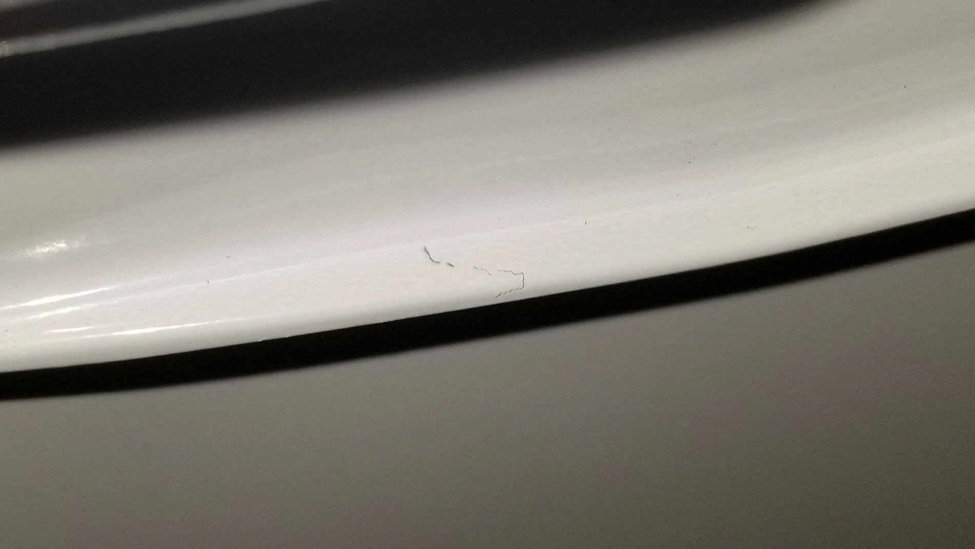

I'm not following what your are referring to FASTCARS???
The hood comes from the supplier primed in black and then is painted body color (white topcoat). From your pictures, the fractures are black which indicates the fractures happened after the hood was painted white. If the crack was present prior to applying the body color then the fractures would have white paint baked into the fractures.

They were for sure not there 2 weeks ago when the car was paint corrected and ceramic coated. I had the center hood vent off and was looking over the hood closely as I was working to remove the hood vent. This past weekend on the cruise, I was showing someone how the rain tray (which was removed) mounts and immediately noticed the cracks. No way I missed them 2 weeks ago.
Definitely not there prior to the hood being painted as you pointed out.

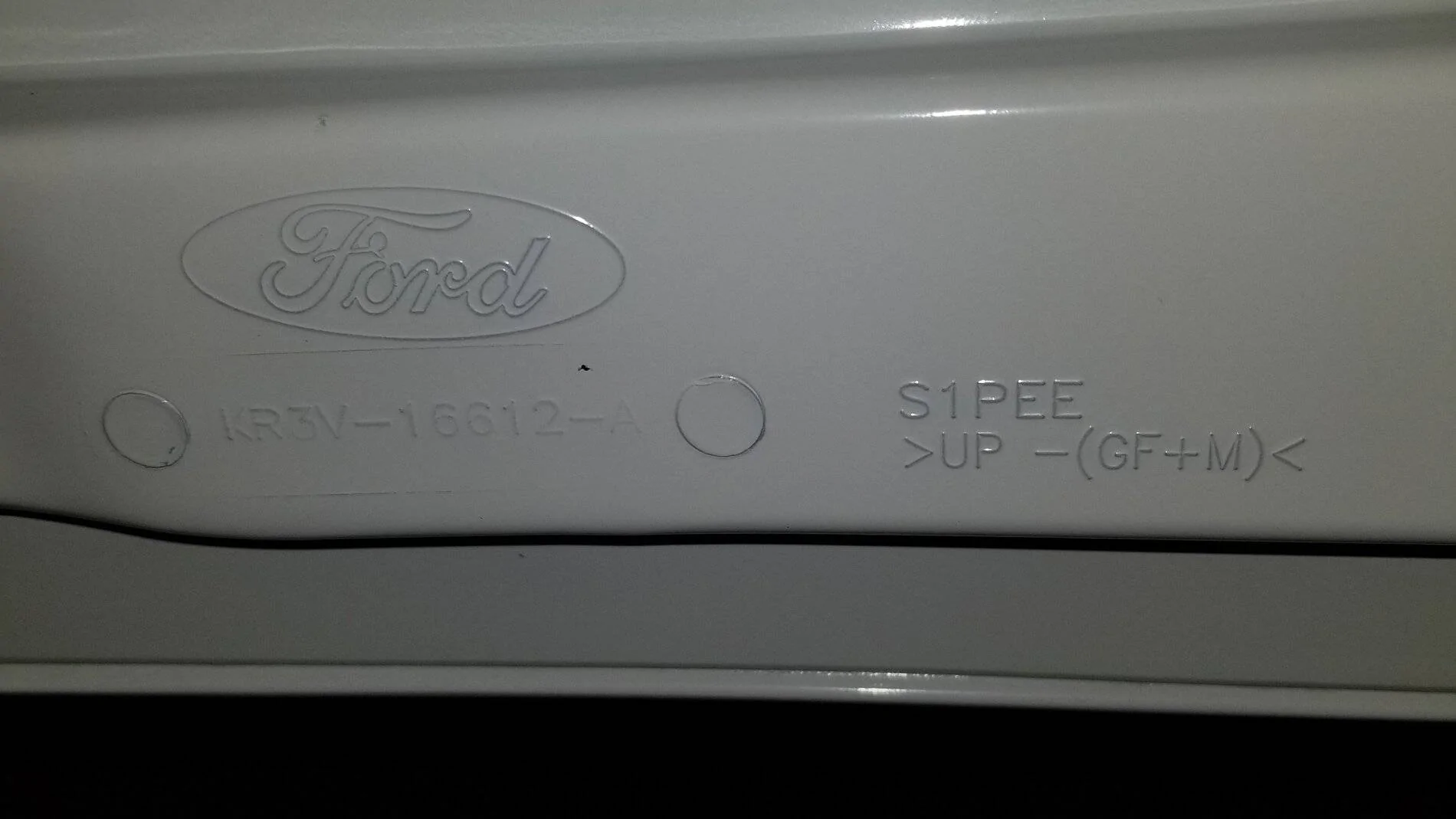

I like to disassemble things.

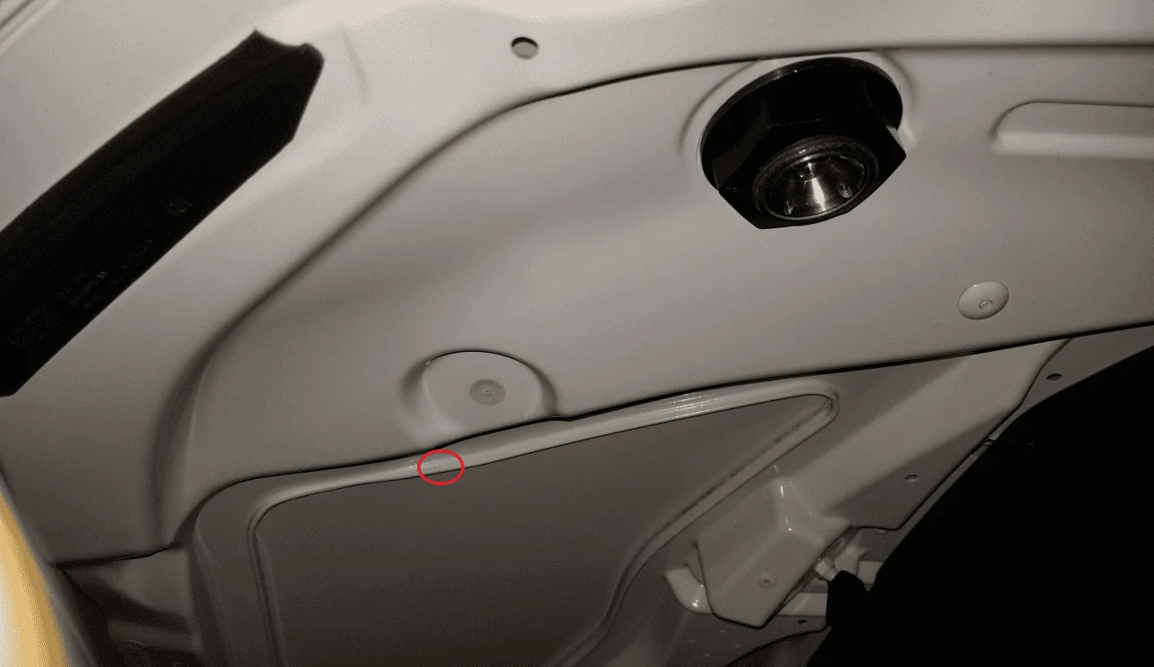

The kraken on mine...
Location - note, it is outboard of the rubber hood stop.
And you can see the material properties on the passenger side of the hood, along the edge.
The UP is for unsaturated polyester resin, reinforced with glass fiber (GF), mineral filler (M) and other additives.
Does everyone else have KR3V-16612-A? Or anyone have a B (or C, etc) as the suffix, which may indicate a revision?

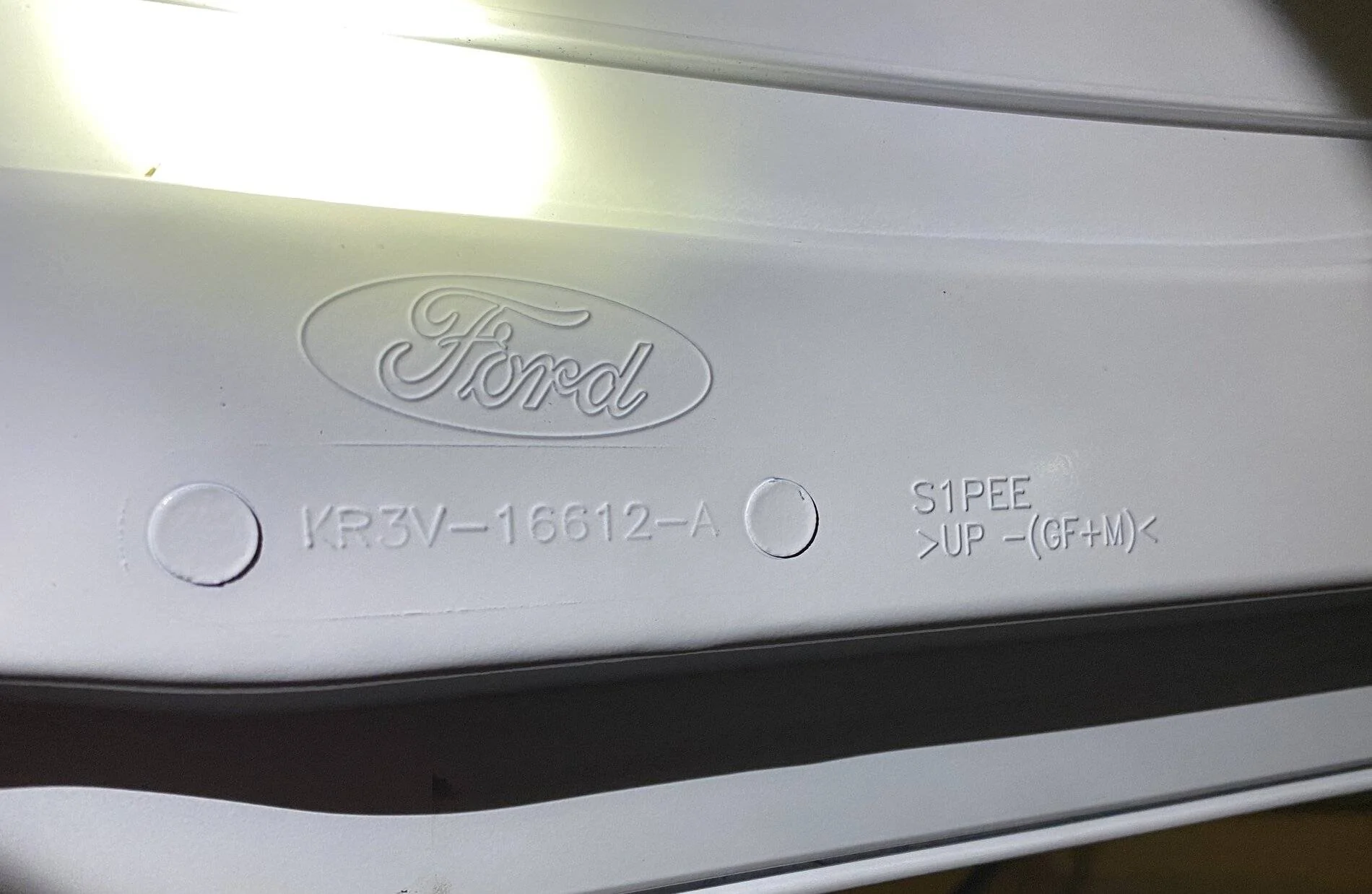

Mine.
