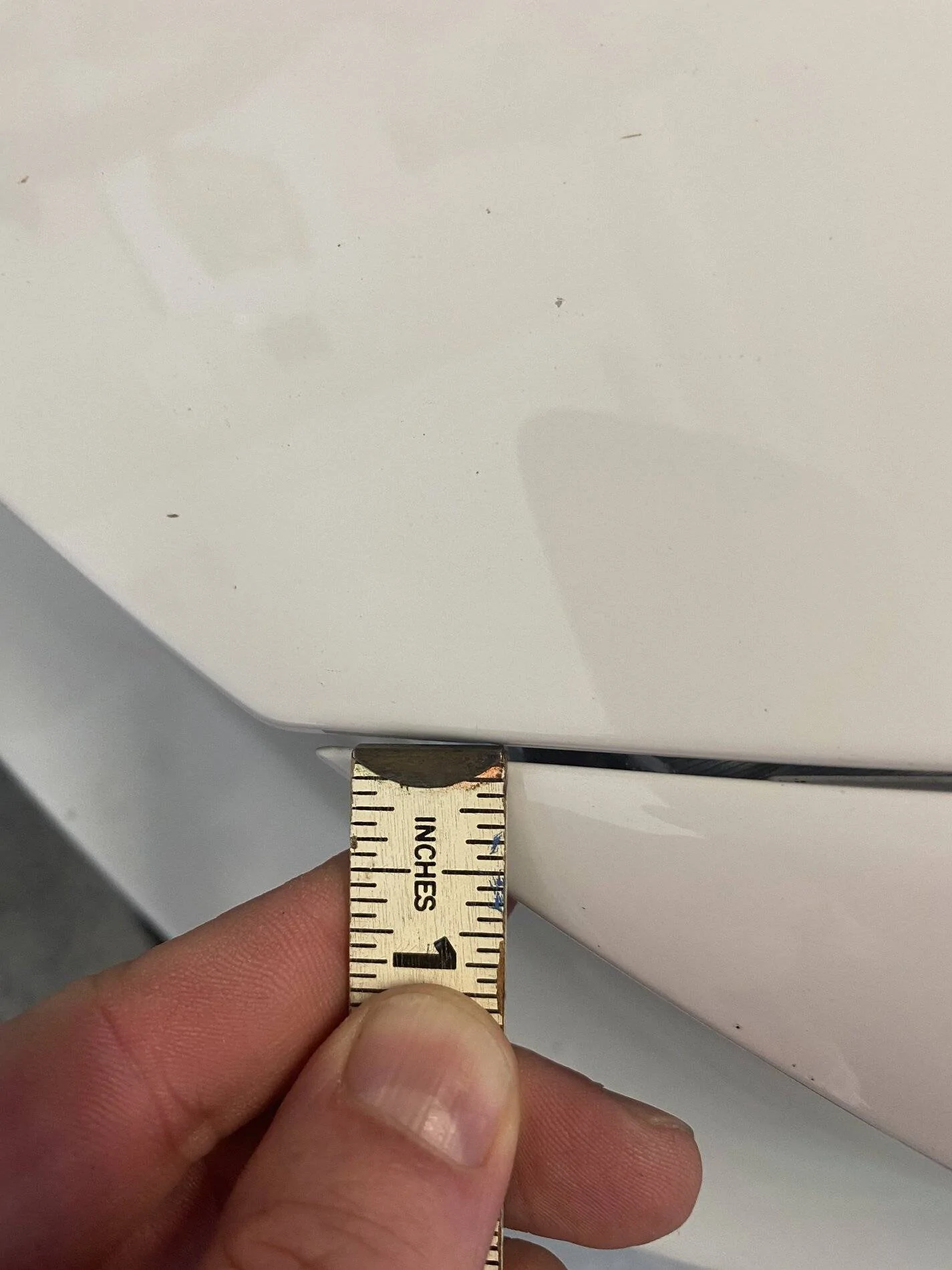

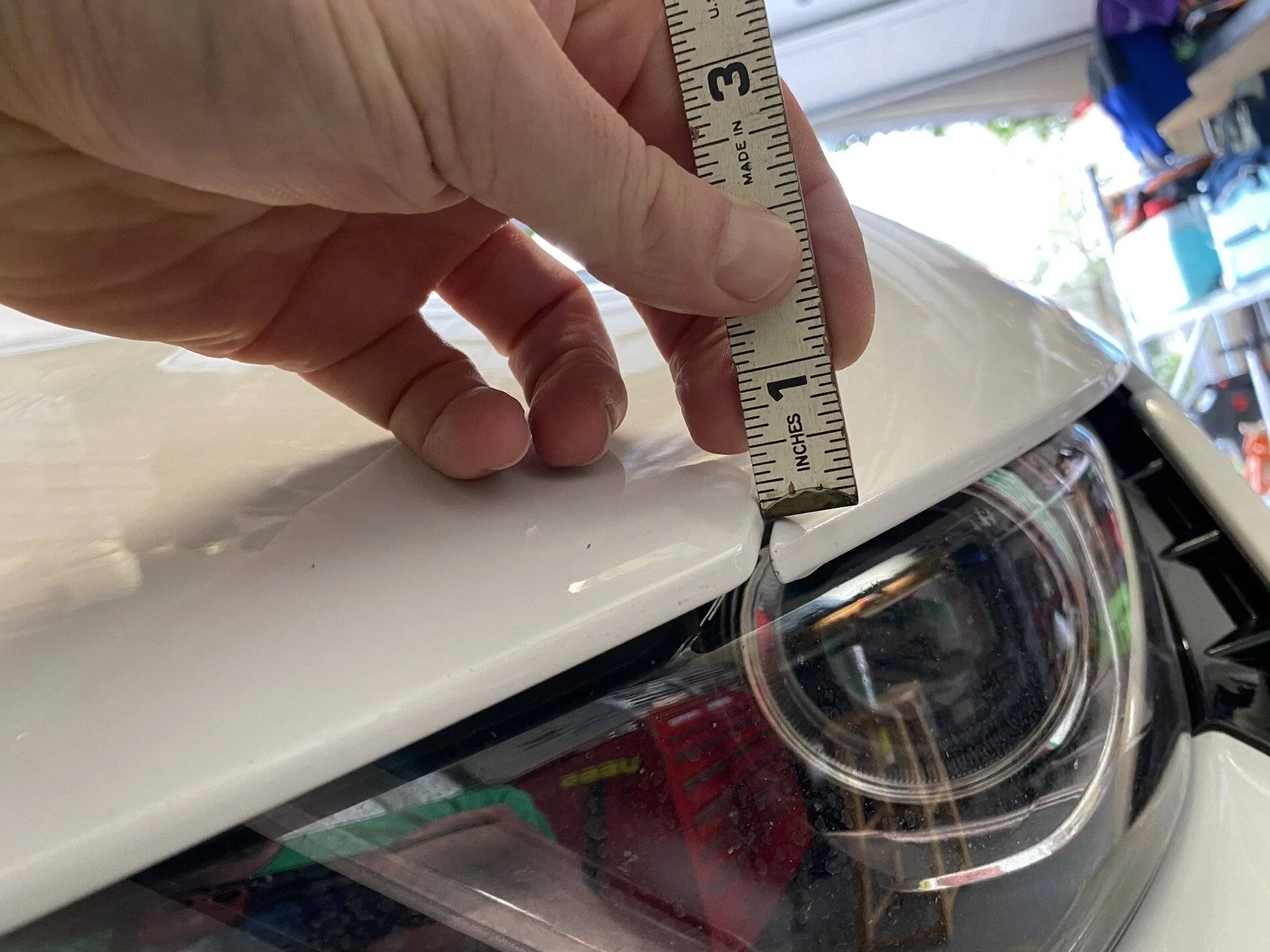

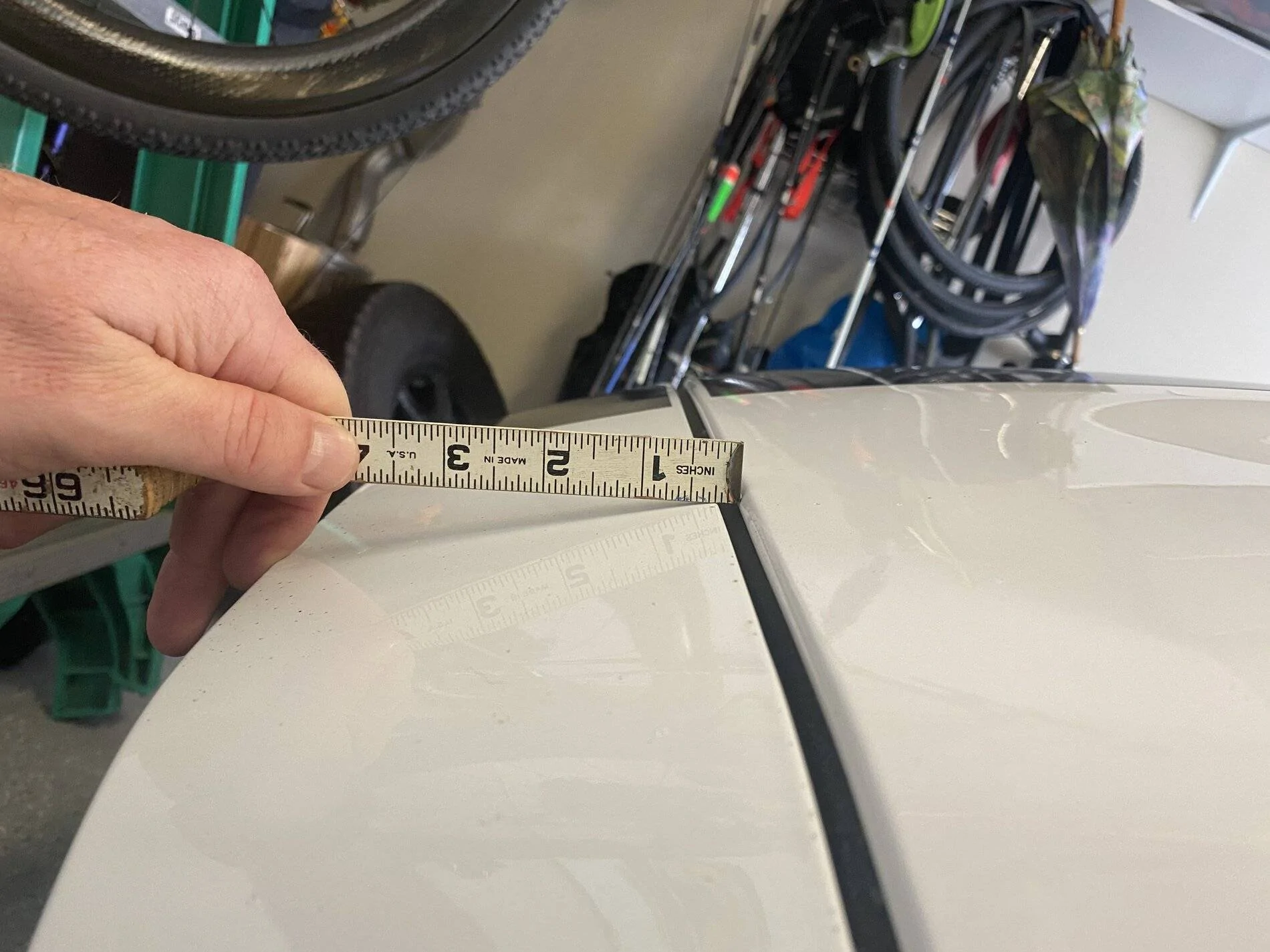

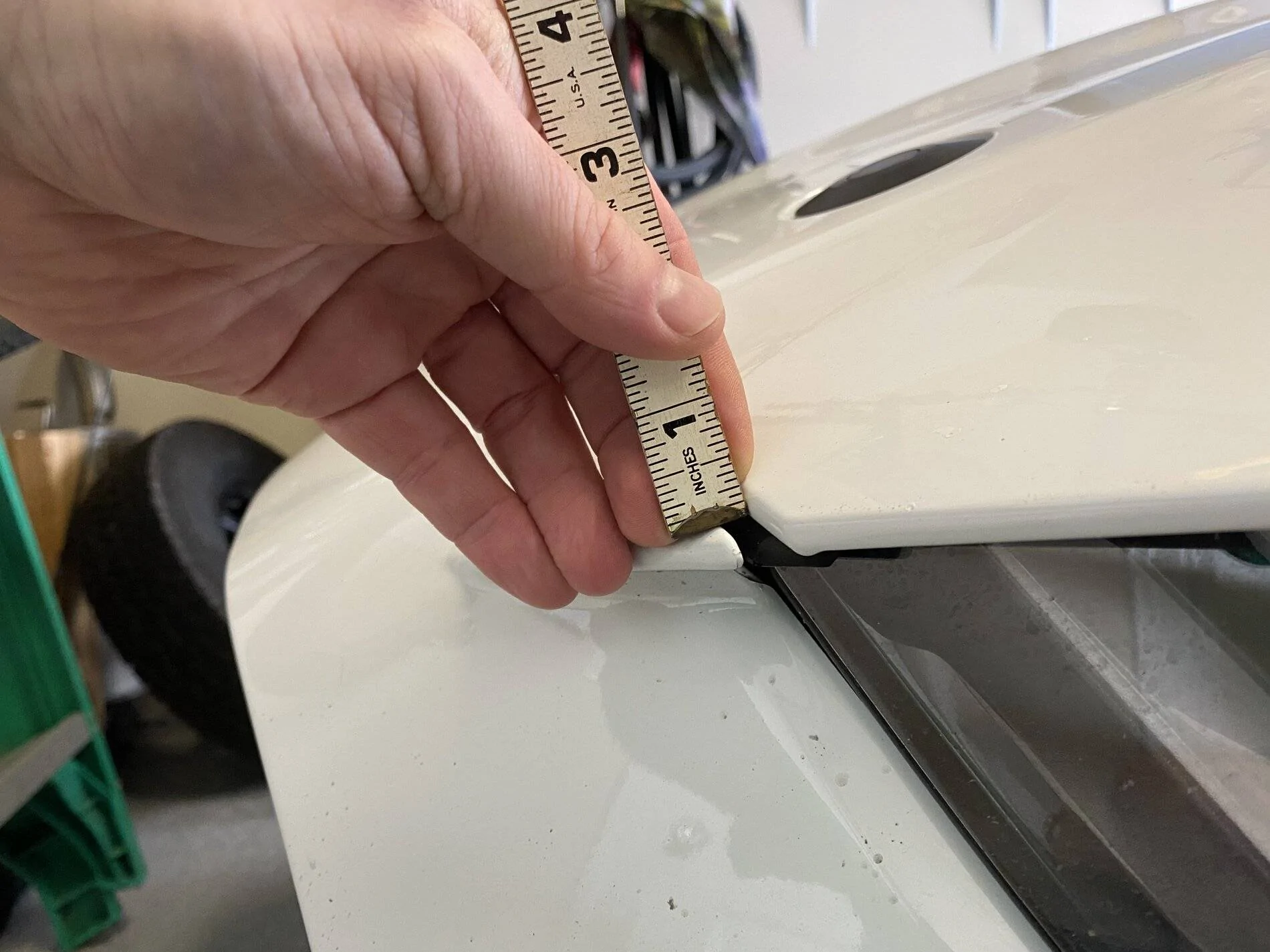

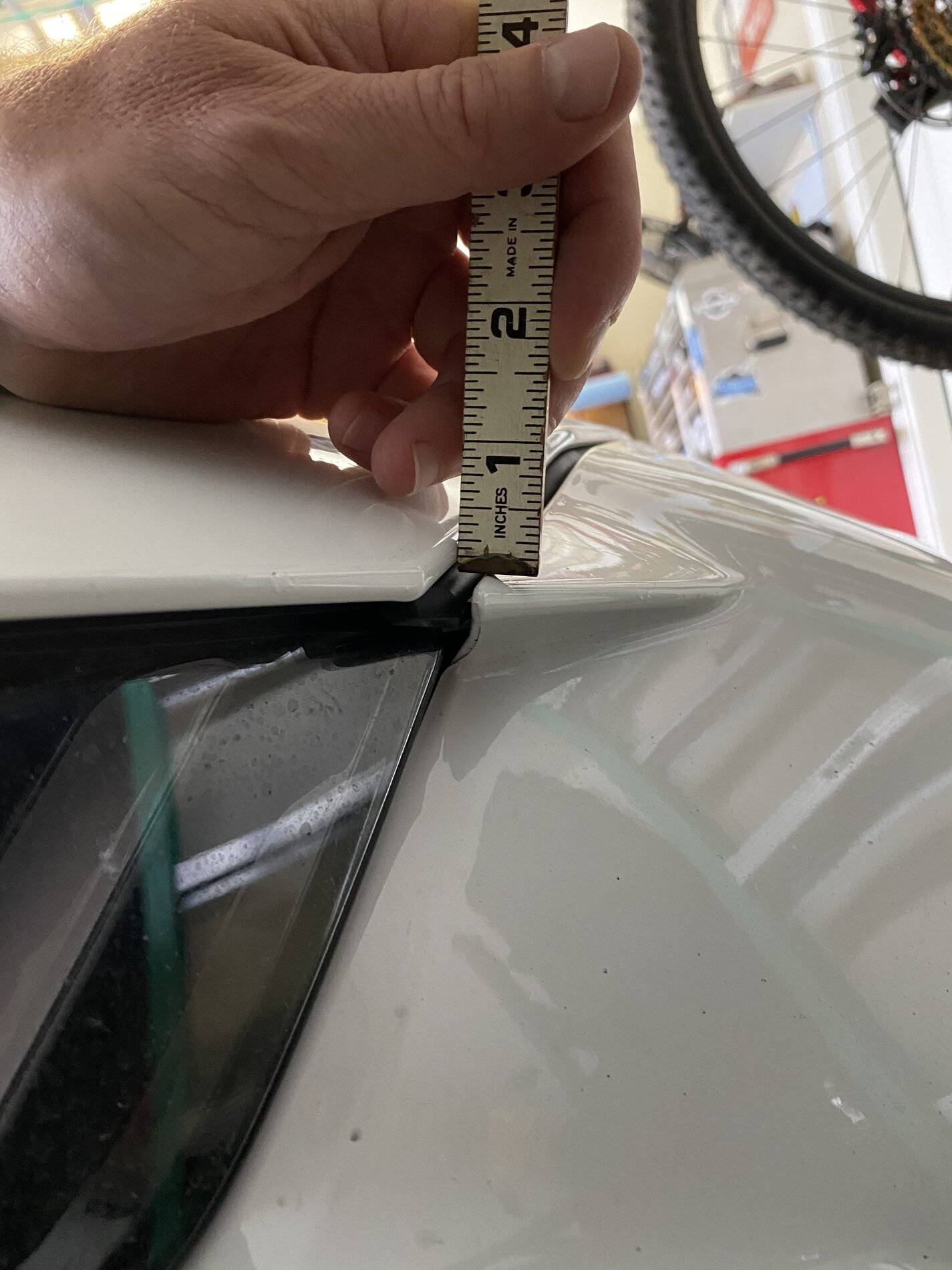

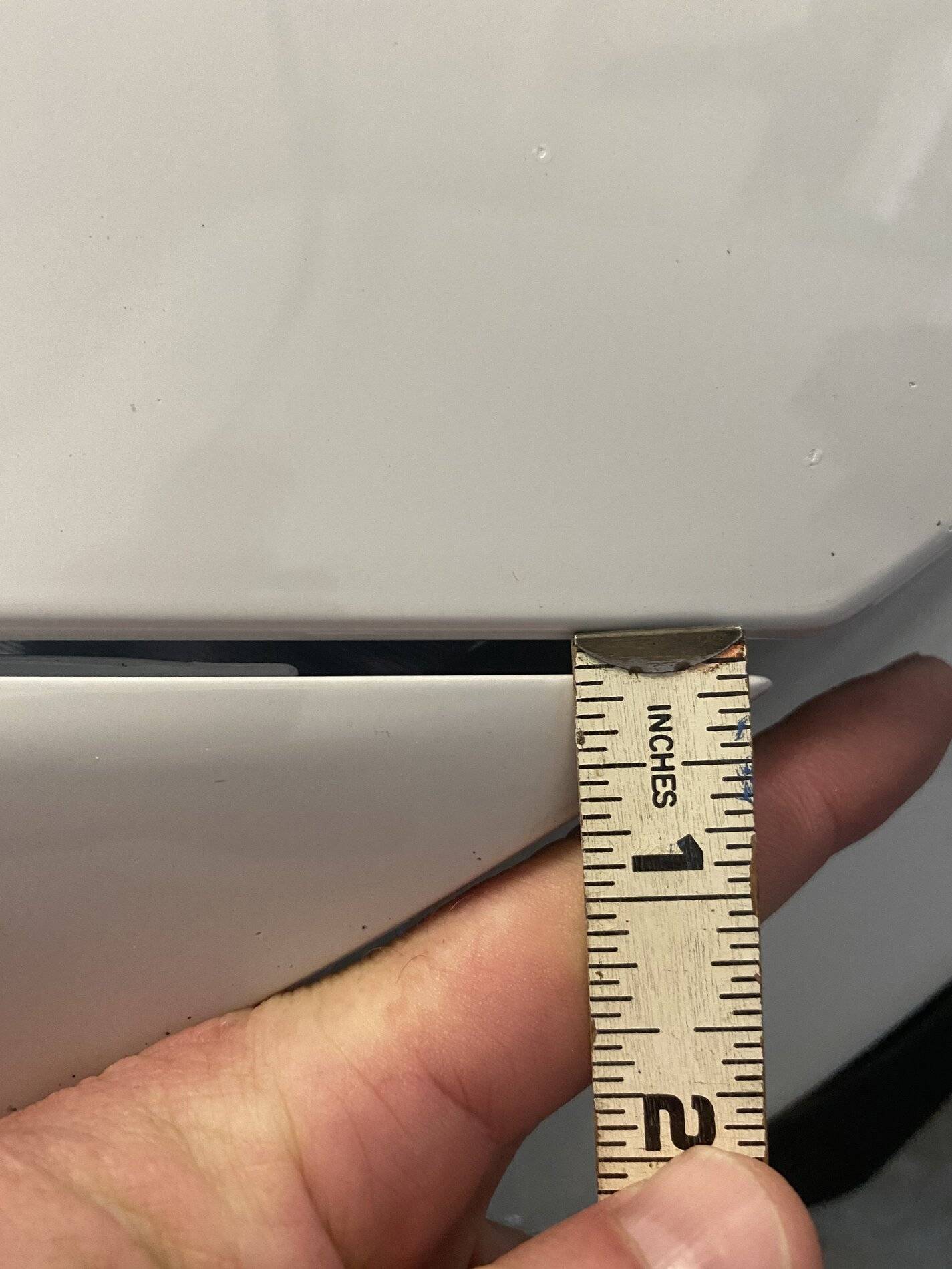

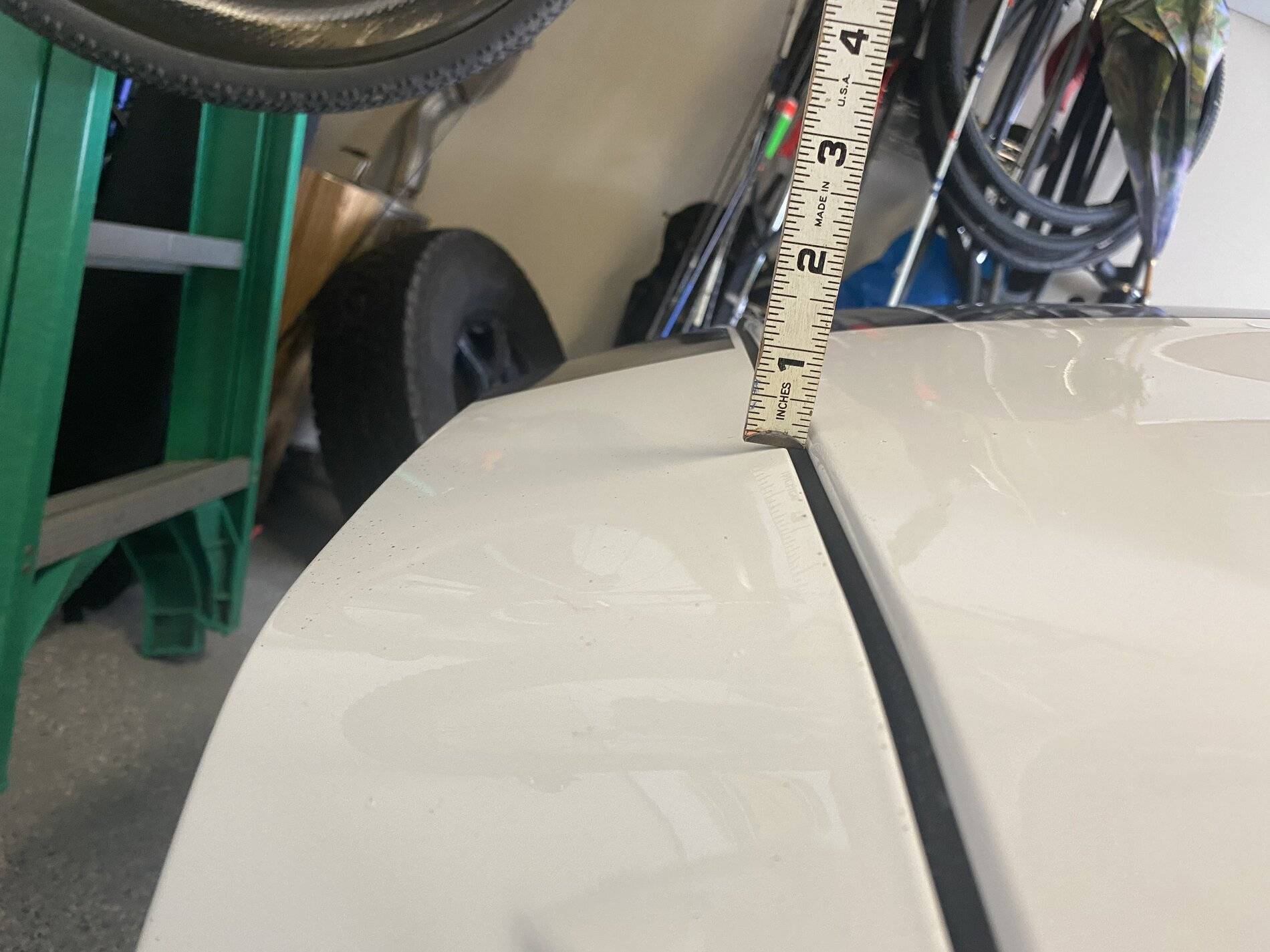

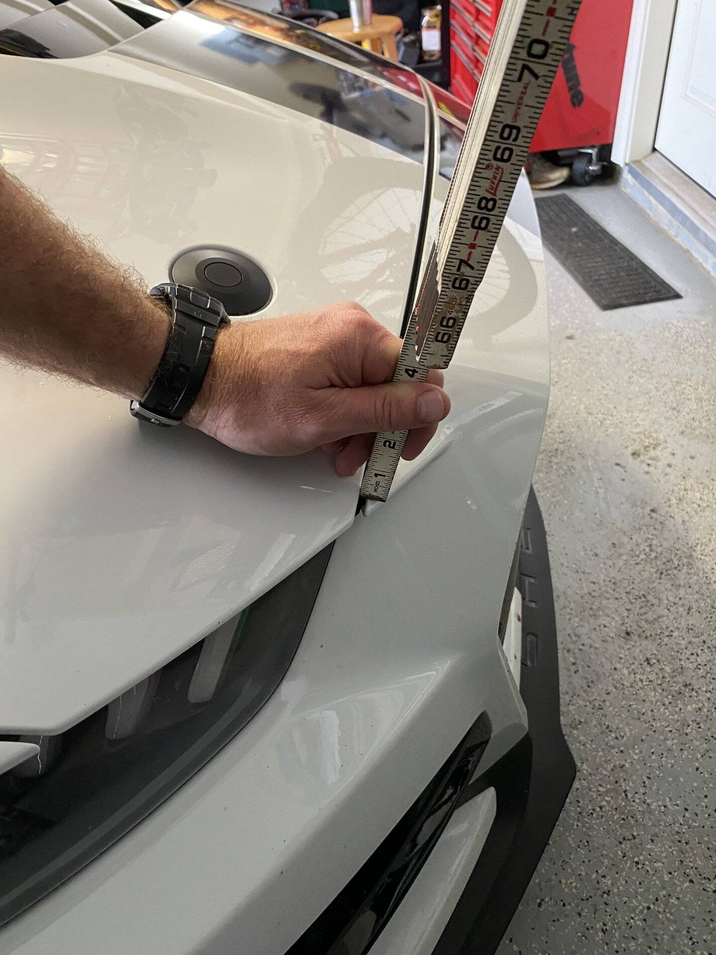

I’ve also noticed the panel gap between the hood and finders are very different on each side. Take a look at the pics. Driver's side has good panel gap but the hood is above the fender. Passenger side has a bigger panel gap and sits above the fender. The leading edge of the hood sits above the front facia. I am thinking improper hood alignment maybe a contributing factor.
Leading edge of the hood are the pics above.
Drivers side.
Passenger side.
Passenger side.
Driver's side.
Leading edge.
Leading edge.

I would be more worried about how much higher the hood is compared to the fender. It looks like the bump stops are set way to high.

My passenger side sits higher than the fender. Having the hood open for weeks on end may not help. The driver side sags a little in comparison as it has no strut to prop it up and as a result the hood takes on a slight set.

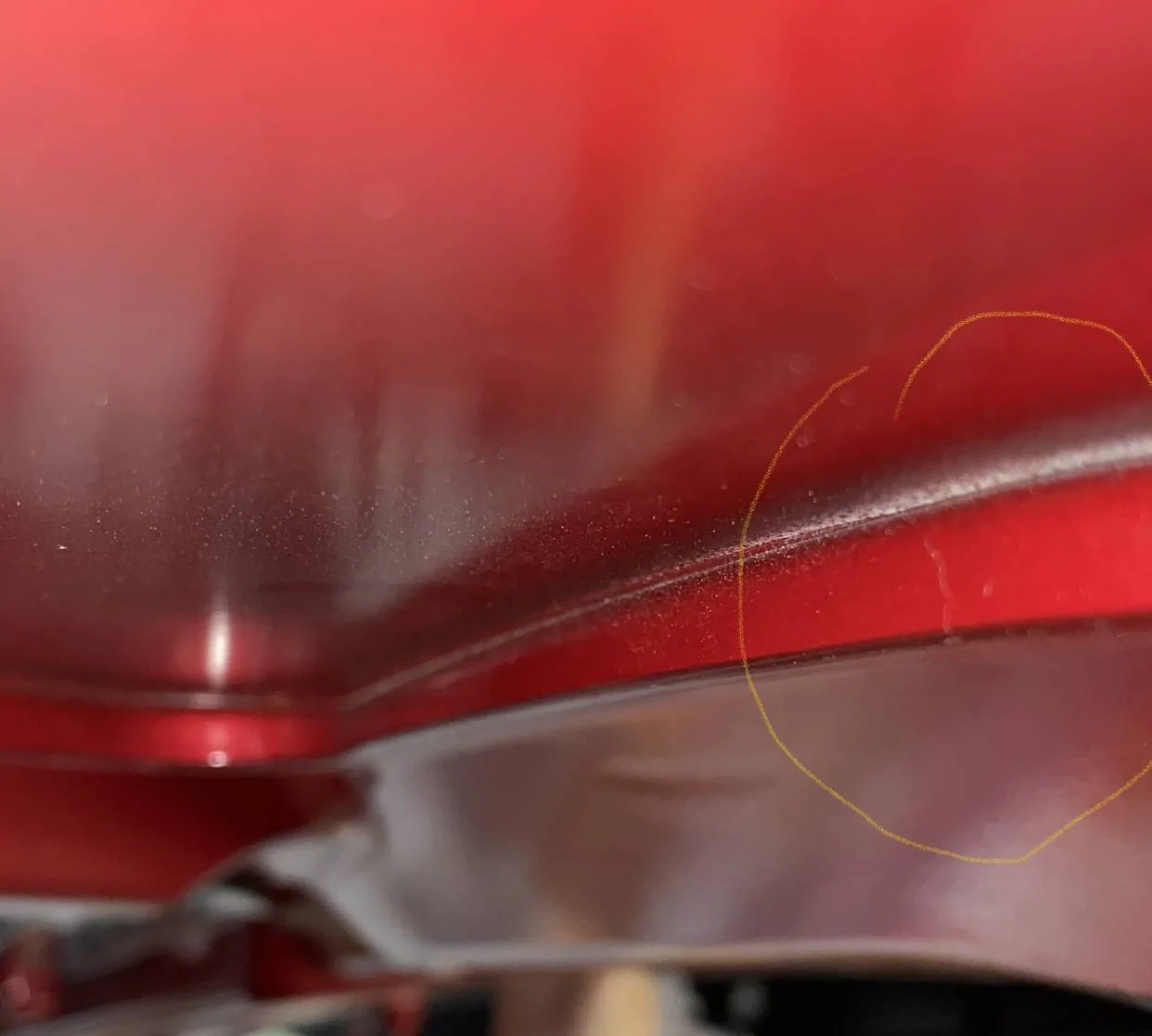

Just checked my hood and here we are cracked:
This was taken on the backside of hood on passenger side. Driver’s side has a crack starting on backside and has not yet gone all the way through the frame support.
I suggest y’all check the backside also if you can’t see a crack on the front.
Mine are completely through on both sides.
The passenger side is all the way through hard to see on the front side however you can easily feel the crack on the front lip.
The backside drivers side you can feel yet you can’t see it.
