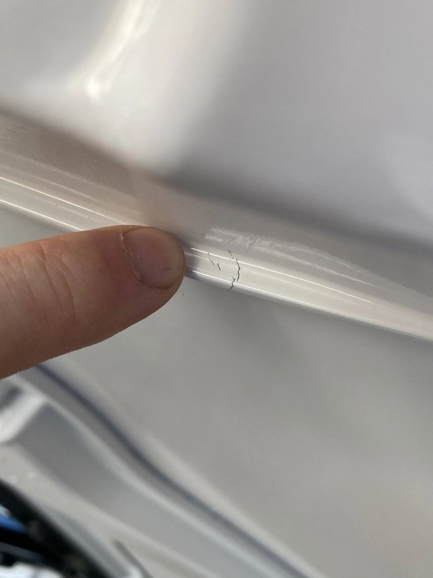

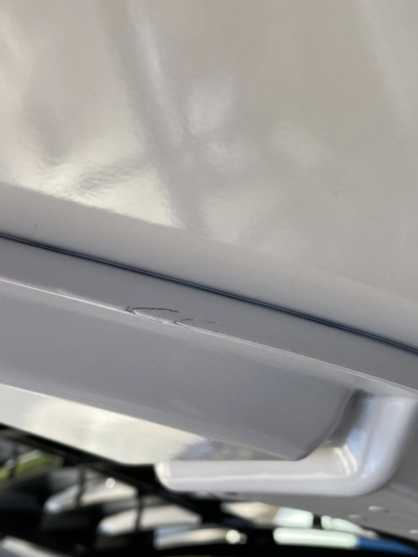

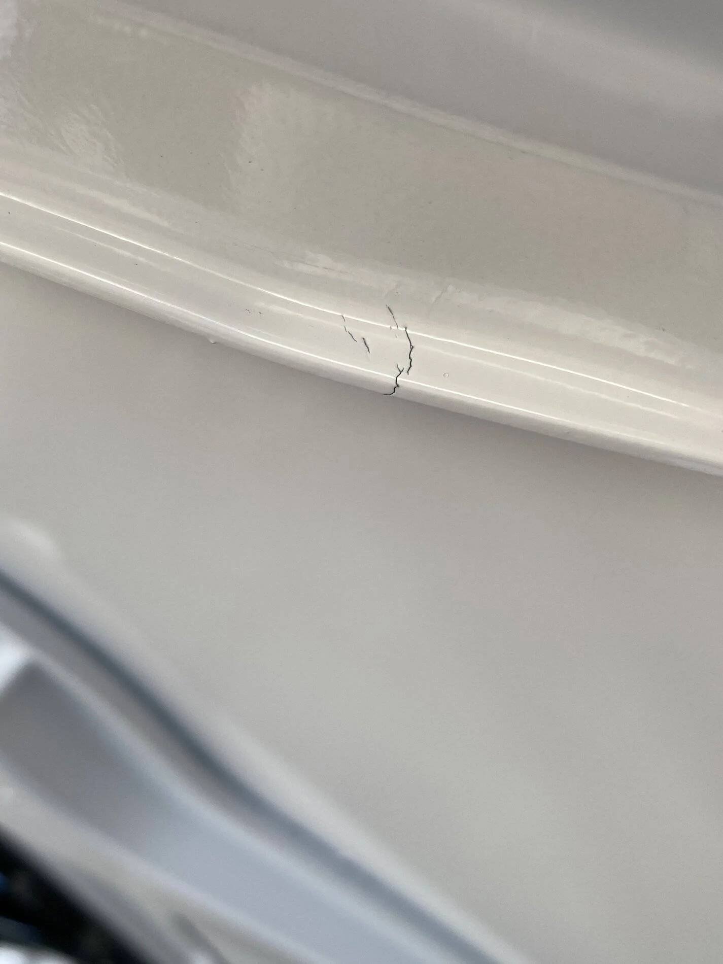

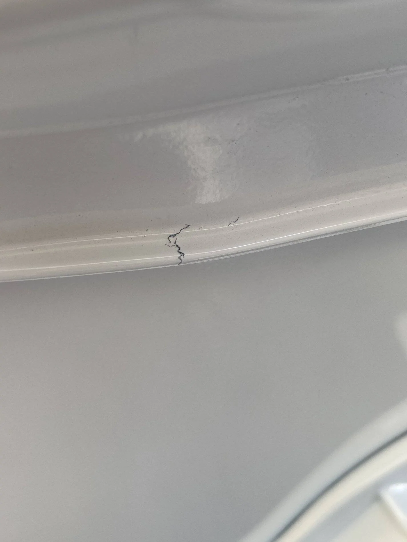

My cracks are growing and new ones are showing up. One has propagated passed the support. It has not been driven much at speed since the bump stop adjustment but maybe once they start it’s never going to stop.
The last pic is a manufacturing defect. It has clear coat over it so it’s not a new crack and has not grown. I found that when I first found the cracks but since it is not a crack I did not post it then.

once you get a crack, the only way to stop it from spreading is drilling a stop hole.
I’m sure the more the hood opens and closes the more slight flex movement if the ve rack wil continue to move
