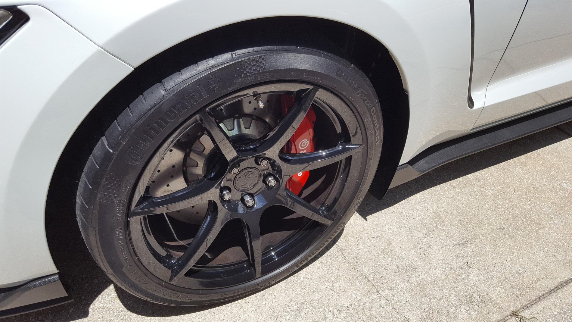

I do track the car, but given I live in MI and mine looks very much like a pothole impact crack, there is no way they can argue a crack like mine is related to track use.
Also, appreciate the broad language above regarding “racing” exclusion, but open track DE is explicitly not racing, not timed, and I can promise you they can’t hide behind “other abnormal stress” to exclude a claim. I’d love it if they tried and would be very happy to profit nicely from a class action and personal lawsuit about how their R car being used for a handful of DE events can be described as “abnormal” in light of the marketing and purpose of this car to deny a warranty.
I’m waiting to hear from my dealer still regarding my warranty claim, will post updates.
