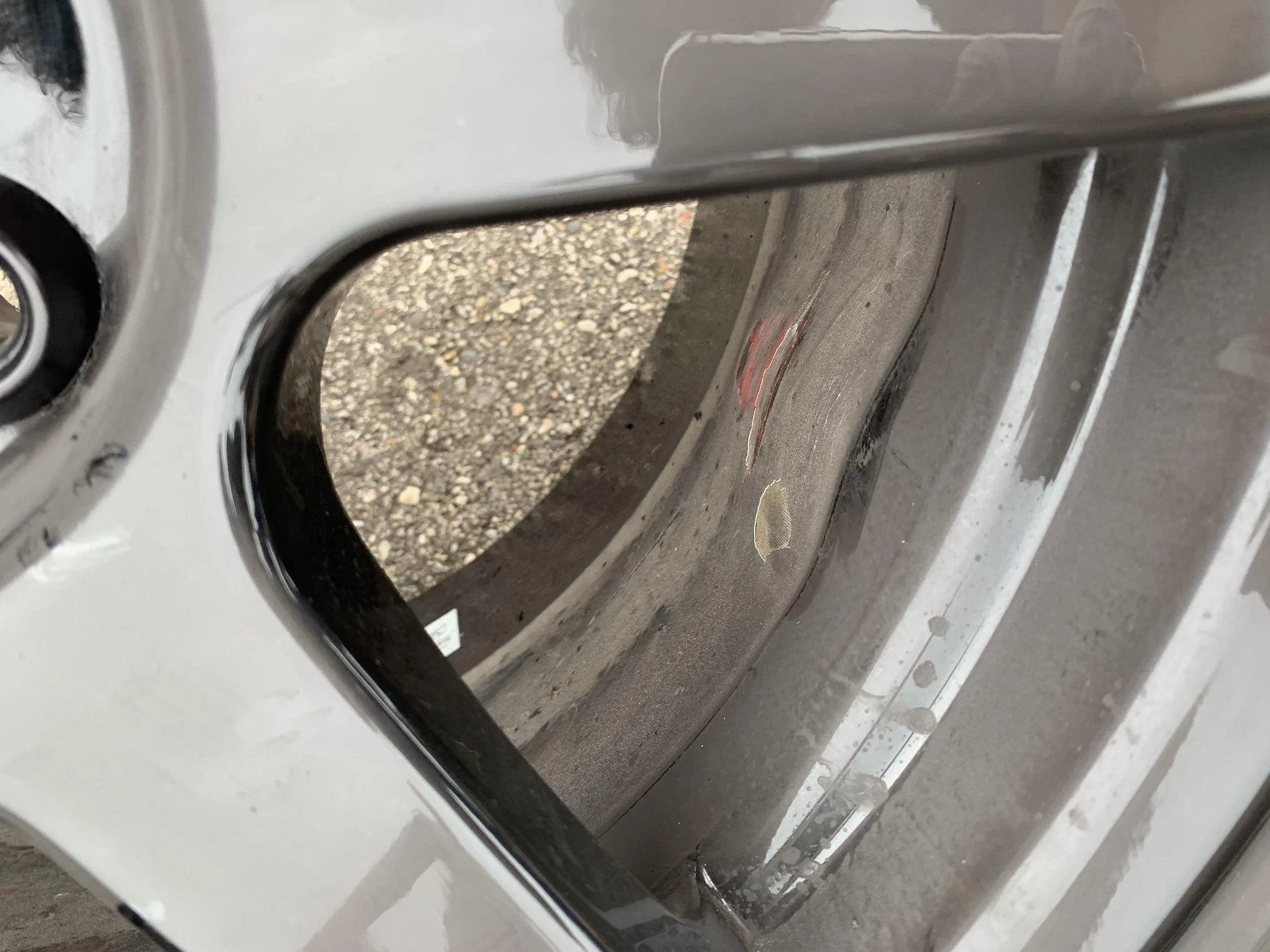

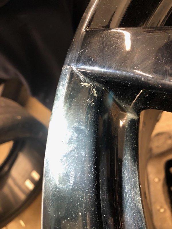

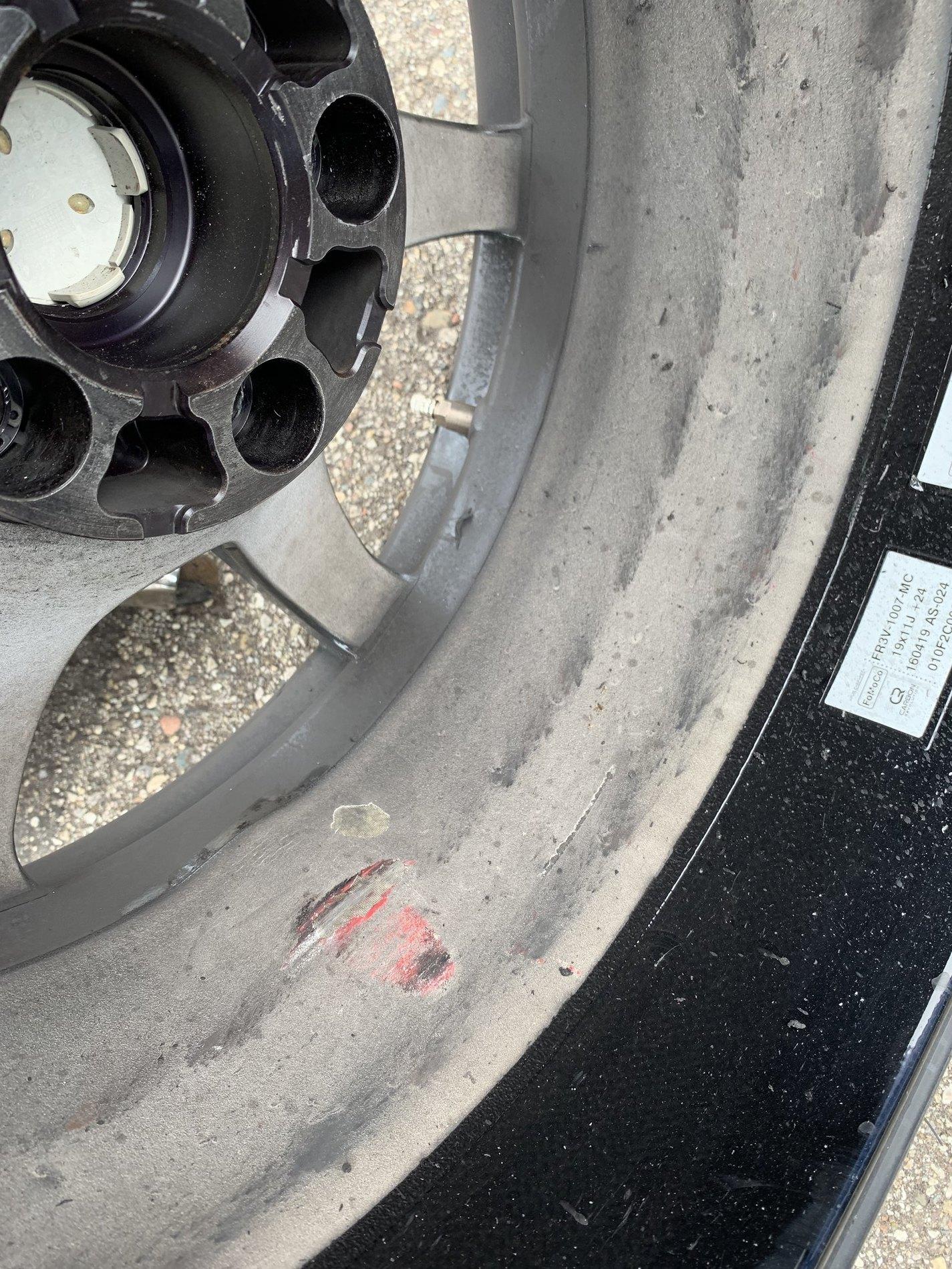

Two pics the dealer just sent me. He said the other wheel looks good but I’m going to closely inspect everything, especially the front on same side. This is damn scary to think it could have failed at 140mph at grattan this weekend. Really happy they caught this.

I’d like to see it in person if possible. I just dropped these off 1.5hrs ago. It’s possible the dealer dropped it or did it mounting a new tire, but they have the latest hunter touchless mountjng machine and claim 2 people mount these wheels together given their value. It doesn’t matter to me I guess, one way or another, I need a new tire and ain’t paying for it. Hopefully no issues with the warranty but I don’t see how their could be.

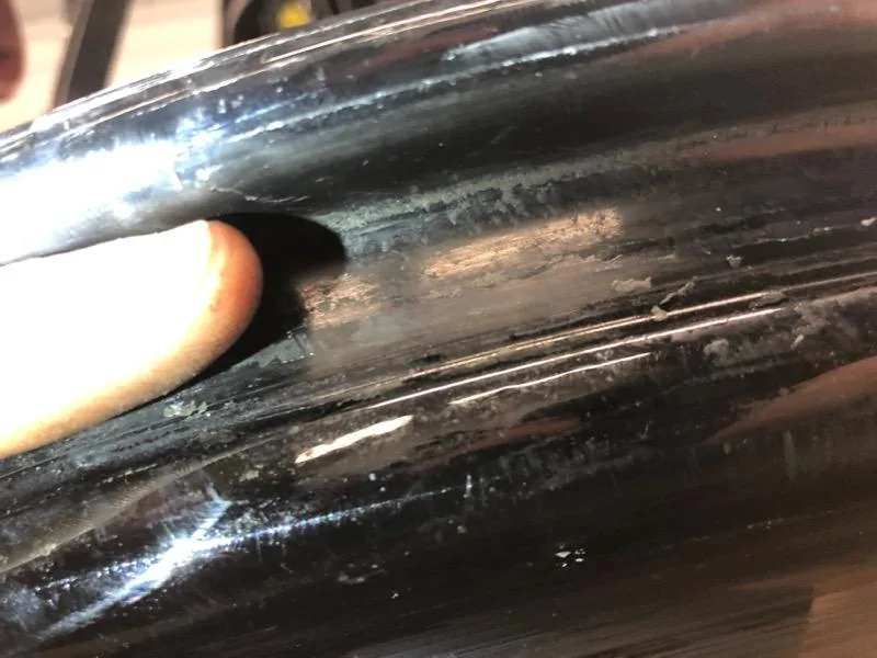

Now, I had a bit of a freak failure at Grattan. After a short (~6-lap) session with no issues, I came off the track and parked in the paddock. When I jumped back in the car several minutes later and moved it, there was a massive noise. The CF wheel barrel had literally bubbled inward on my front left tire with a welt the size of a large egg. The swelling of the barrel caused flakes of the ceramic coating to flake off. The raised/ indented portion was hitting the caliper (hence the noise).
At the time, I was amazed. I put the SV501s with street tires back on and finished the track day. It also happens that a friend of mine who was at the track with me works for FP, and he knew the GT500 guys were testing at Gingerman (another Michigan track ~2 hours away). That guy actually called his colleagues, sent pictures of my wheel, drove over to Gingerman, and came back with a CF wheel and a good-condition PSC2 so I could finish the next day of the event on good rubber. I drove home after the event, wrapped up the CF wheel, and shipped it right back to Ford Performance. That is service! (Also helps to be connected).
Pics:
Immediately when it happened, wheel still on car.
Bubble in barrel viewed from outside the spokes.
Bubble in barrel viewed from the back of the wheel. Note there are two areas of damage to the ceramic heat coating, one where it flaked as the underlying structure bubbled up, and one where the raised portion scraped on the caliper for the 30 or so feet that I drove the car.

Following. Lots to say here - I have a story I haven't shared with the forum yet as I'm trying to get it resolved through Ford. Also related to Grattan (was there in late July) and a CF wheel (pics coming).
I have a 2017 R and also purchased a 6-year wheel/tire warranty for ~$1500 at the time of vehicle purchase. I heard after that they did not allow that plan to be sold on 18+ Rs, likely because they figured out how $$$$ the wheels are!
Pics:
