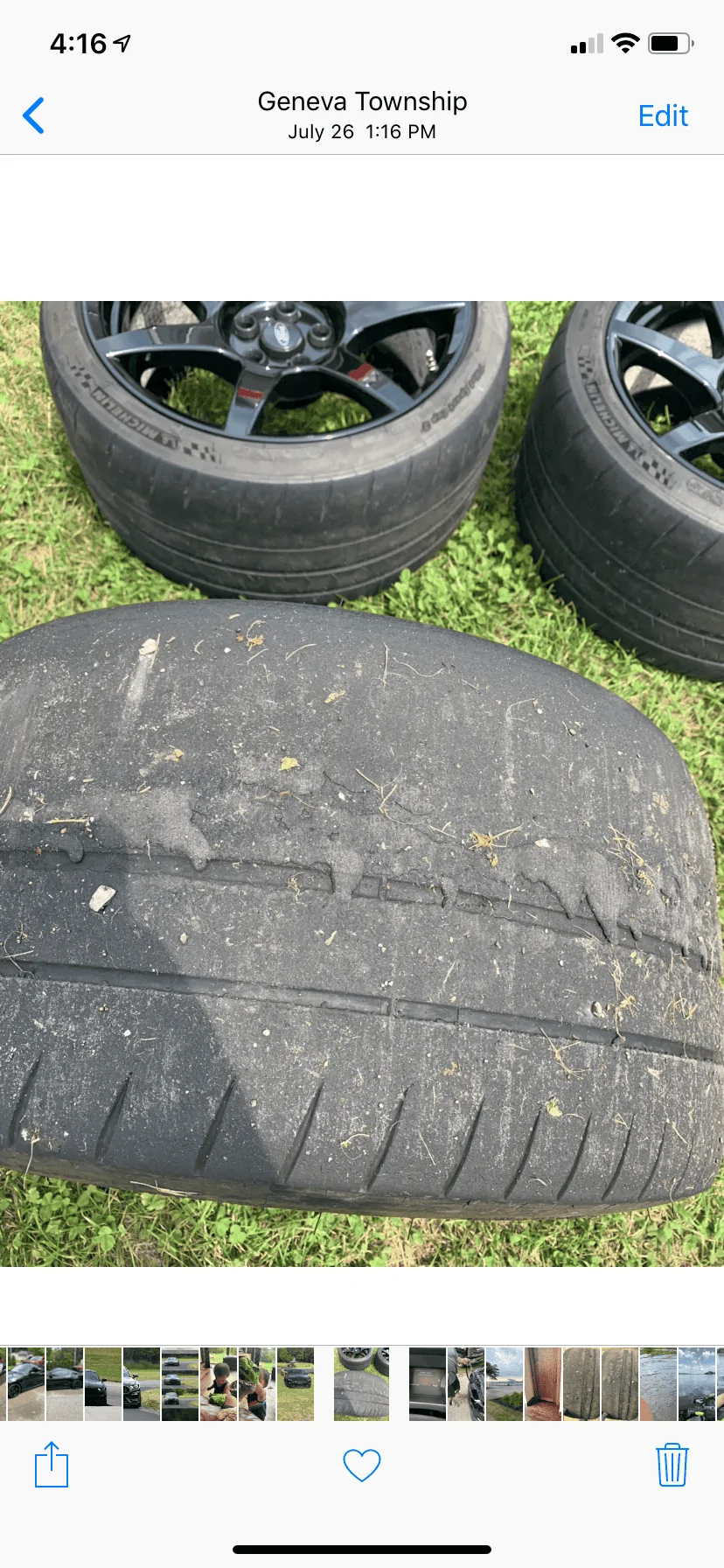

The wheel warranty denied my cracked carbon wheel claim bc “the tire tread is under 3/32”. I expected this issue, and this is what the contract says (even though it makes ZERO sense for grounds to deny a crack like this based on tire tread), so When I bought the warranty I had the dealer financial services manager contact the warranty company directly, with my vin, and he confirmed to me in writing (which I have) that bc the R, and my vin specifically, comes with tires less than 3/32 new (in any spot, outside groove) I will have coverage on both tire and wheel “as long as threads are not showing”. Have emails of this, and just forwarded them to my service manager to cram down the warranty company’s throat.
Here is a pic of The rear tire, which is heat cycled out but plenty of rubber and far from chording. View attachment 394919
Certainly terrific forward thinking on your part with respect to tire tread depth on your R as not many people would have taken this approach but based on how ignorant most of the general public is regarding OEM tread depth of lack thereof on our R models that was a great call.
Suggest that you have nothing to be concerned with based on your proactive approach.
