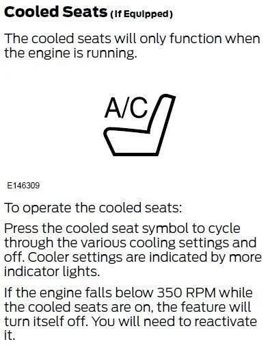

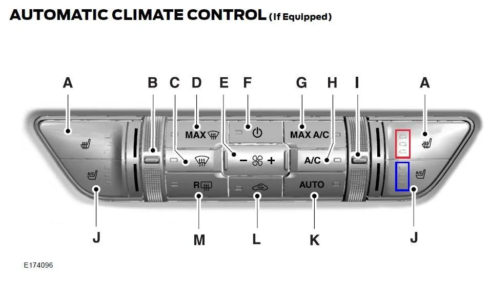

There is a low, medium and high setting for both the seat heating (red box in figure) and the seat cooling (blue box in figure). So yeah, those are technically temperature setting controls.
One bar showing is low, two bars showing is medium, and three bars showing is the high setting.
